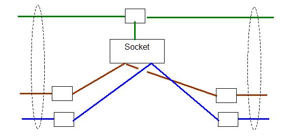

I suppose you could use a 5 way wago and take two cables to the socket...
That, in itself, would not alter the fact that, strictly speaking, the socket was on a 'spur' from the ring - it would merely have (unnecessarily) doubled the CSA of the spur.
There would be absolutely no point, but if one really wanted to one could use Wagos to 'extend the ring' to include the socket (so it was no longer 'on 'a spur'), but that would require 5 Wagos (4 x 2-way and 1 x 3-way) ...
Kind Regards, John
I'm sure it's just a typo but it's 2 cores into the Wago (one from each side of the ring) and 1 to the socket. And there are 3 no. wagos; one for live, one for neutral and one for earth

If you cut some short (few cm) length of 2.5mm and attach it to the screw terminal on the socket and to one of the slots on the Wago, then you've effectively made the socket into something like an MK Rapid, and you might be able to find a way of doing this comfortably, electric screwdriver, whatever, while watching TV etc.. Then on the job site it's just push push push (you don't have to lift the levers on a wago to fit solid core cable, you can just push fit) - it's cost you 90p to convert the socket but..

That's an interesting one because, although I've never really thought of it before, I suppose it's technically true (as robinbanks has said, I presume you mean the two ring conductors plus one going to the socket going into a '3-way' Wago)- although I imagine that most people really think of the Wago as being an 'extension of the socket's terminal'.
However, as robinbanks has also said, it doesn't matter, since there is absolutely nothing wrong with a (one) socket being supplied via an 'unfused spur' from a ring.
It occurs to me that some people might argue with the way I have dealt with the CPC ('earth') in my diagram. If one really wanted to have that as a 'true ring', one would treat it the same as the L & N, and therefore use 6 x 2-way Wagos. However, as I said, I see absolutely no point in that approach in the first place!

That wouldn't make it a ring though; it would make it an unfused spur that uses 5 mm2 cable. It also still has a spare port in the Wago
If you're panicking about a 3cm length of 2.5mm struggling to carrying 26A to the socket, I wouldn't - the current carrying capacity of a short piece of wire is considerable - have you ever looked at the size of the wire inside a 13A fuse compared to, say, the size of the core in a 50m extension reel?
