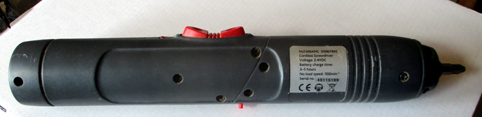

How about one that is still shaped like a screwdriver (black n decker did one years ago?) rather than a pistol so you can drive it on the motor til the screw is almost home then turn it with a hand feel the rest of the way?
I've got a couple of those (still working!) but I personally wouldn't even use/'trust' them on electrical accessories!
Kind Regards, John
I was thinking they might be OK because they wouldn't usually pull the skin off a rice pudding :)
They're obviously less violent than 'cordless drills' (and lookalikes) but the couple I've got are (still, at a very old age!) pretty powerful, even though they are only 2.4V - I certainly cannot stop the rotation 'manually'. Perhaps 'worse', at least mine don't have an torque limiter/control, so one's only choice is to get the 'full blast'. One of mine ...
