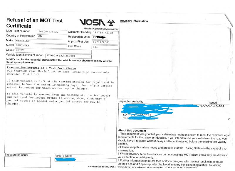

So today I've had a sprinter fail :evil: I've been under it with a wire brush and again cannot see any sign of excessive corrosion, if I did, I would have it repaired pronto.
Now before I make a complaint about this garage I really would like to konw what "excessive corrosion" means in the world of motors because it clearly means something different in the world I work in.
I've attached a few photo's to see what you think.

The area they failed it on is the area shown in the photo. We have also checked the whole length of the lines front to back.
We rang the garage this afternoon and told them we want them to inspect it again tomorrow and see if they still think it should have failed. Will let you know what they say.

One of the lads took it back this morning and the tester took a look and said "any" pitting is a fail however light.
It's now been booked into another garage tomorrow afternoon to see what they say.
Sprinter is 2005 with 110718 miles on the clock.
He's talking rubbish when he says "any pitting is a fail". Here's what the Inspection Manual says:
2. Check all accessible rigid brake pipes for:
a. fouling by a moving part
b. kinks c. chafing, corrosion and damage.
3. Examine flexible hoses for signs of weakness under pressure with brake fully applied.
Reason for Rejection
1. A rigid brake pipe inadequately clipped or otherwise supported.
2. A rigid brake pipe:
a. fouled by moving parts
b. kinked
c. excessively chafed, corroded or damaged. (my bold).
Note that it doesn't say "any" corrosion, it says "excessive". If he wants to make something of it, appeal. VOSA will send a standards monitoring inspector round to have a wee chat with them. They generally don't like that!
Although there is, of course, a degree of subjectivity in all this, I've not known them fail until there is flaky corrosion on them that's bad enough to get a finger nail under and pick bits off. It's worth bearing in mind that the whole idea of an annual MOT test is to assess whether or not the car stands a reasonable chance of going for another year without suffering failure of the component in question. I think it's pretty obvious that there's at least another year in those pipes - probably another 5!

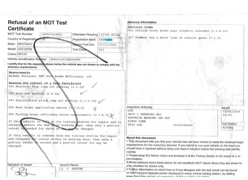

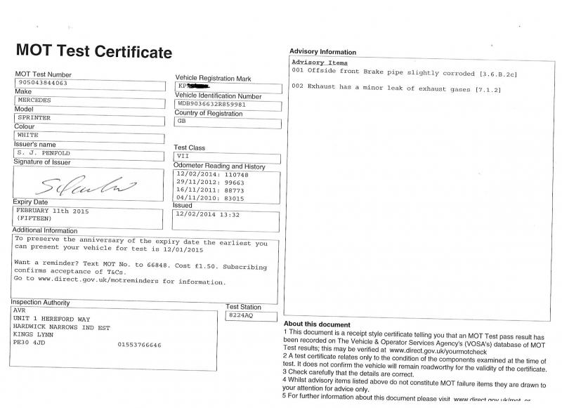

So it went in for an mot this morning at 10am. I have only just returned home :cry:
It failed...................................................................................but not because of the brake lines. They have nothing wrong with them :eek:
No it failed on the following:
1) Parking brake efficiency 10%
2) Nearside stop lamp not working. It was yesterday :evil:
3) Registration plate lamp not working (we didn't check that)
4) Rear brake application uneven.
5) Parking brake efficiency below requirements
Unbelievable that those items were missed by the other bloke. The parking brake shoes were on the metal :evil:
So I'm £185.74 lighter but well happy to have a van with an mot. And more importantly, to have found a decent garage.
Will post the failure sheets later.
