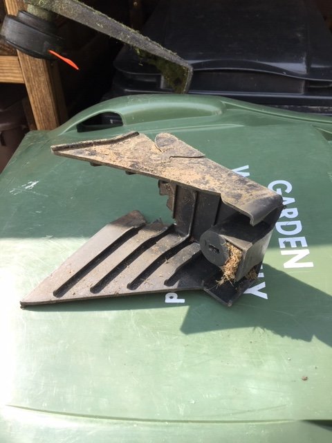

I need to locate a cover which I took off to put the belt on.
There were two of them but the one supplied was broken.
These engines and decks etc must be similar to others so do you recognise it

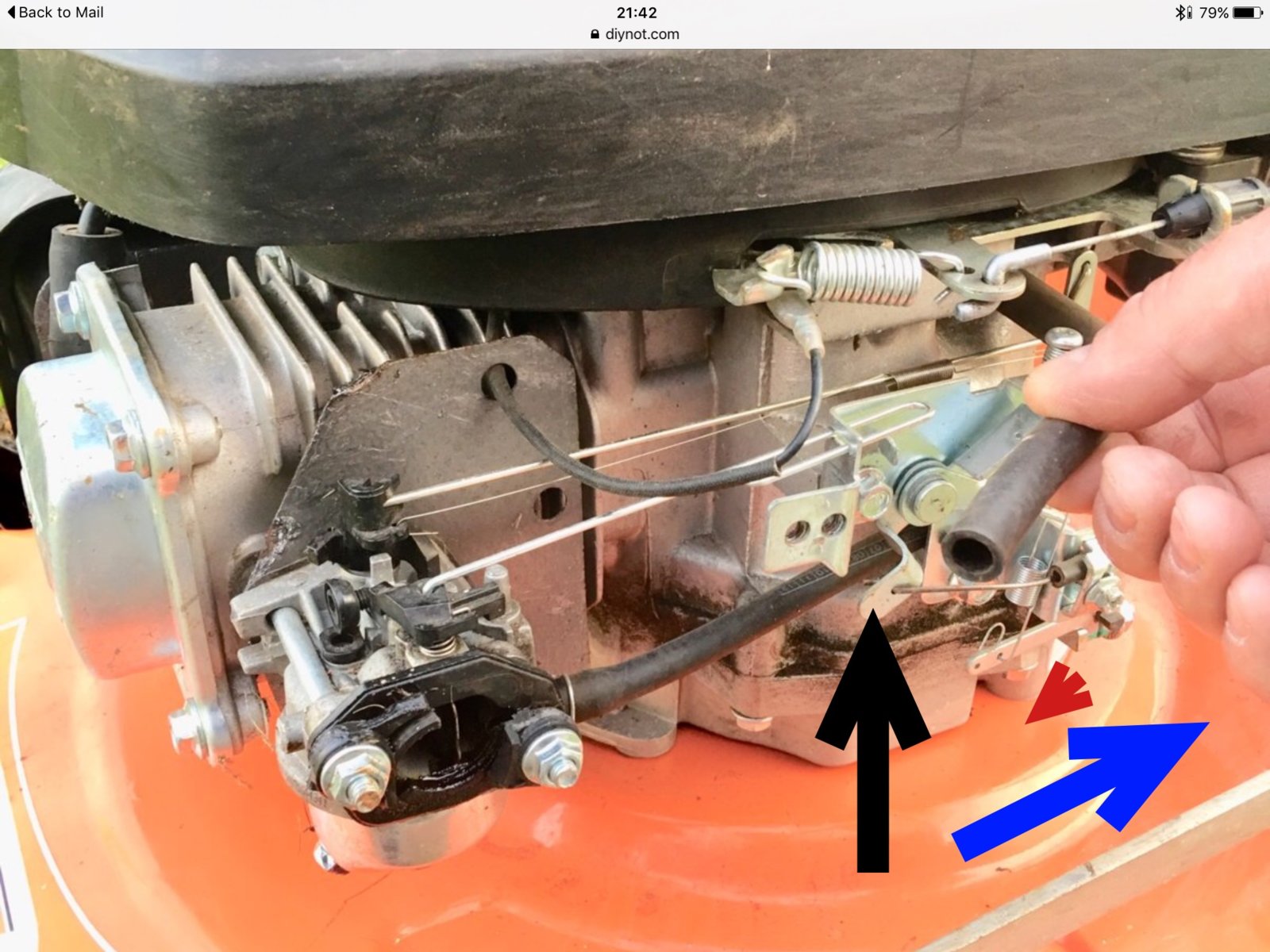

Is there a way or something I need to look at to make the self propell speed quicker.
Remember at present there is no air filter or filter housing connected at present. So I have a breather pipe also just hanging there at present so not sure if this has any impact on this.
When throttle is applied the revs come up & I grip the bar, self propell now working and we are walking across the lawn. To a point I notice a small difference in speed when throttle given a little more of a squeeze but overall I walk faster with my push along mower.
The propelled speed is completely governed by the engine speed, so it would have to rev higher to mow quicker.
It could be possible by carefully bending one of the brackets that the governor springs connect to, but first Id make sure the engine is getting full throttle.
On your bottom pic you can see where the throttle cable is clamped......moving the outer cable back a bit often helps.
The abscence of an air cleaner or breather hose connection won’t affect anything.
John :)
This morning I fitted the new throttle / cable so maybe it's not quite correct.
The photo supplied is just a copy of the same one the other day so the Newley fitted cables position is now different.
So looking at the photo & with the throttle cable removed I can hold the metal plate show by b,ack arrow and move it in the direction of the blue arrow.
Now the revs come up quite a bit.
I then fit the cable and use the throttle, I would say that I don't quite get the same level of revs.
From memory this morning I think when using the throttle let's say 80% I noticed the revs increasing but then the last 20% throttle travel movement had no affect to the revs.
You see how the throttle cable outer is clamped? Slacken the clamp and move the outer back in the direction of the blue arrow.....that should help reach maximum rpm. If you overdo it, the choke will come on.
