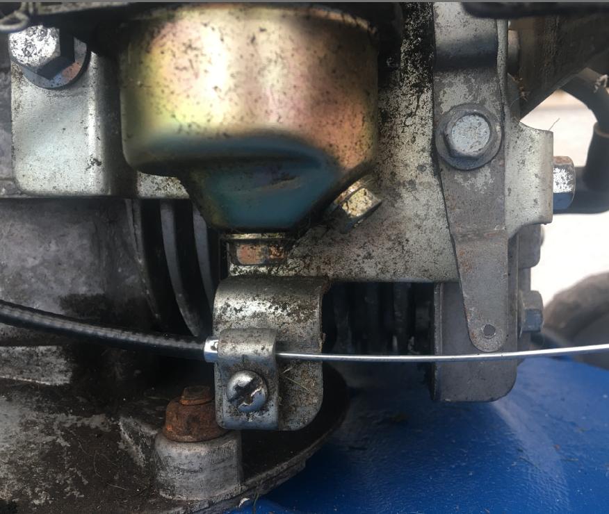

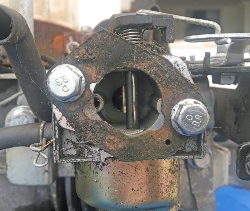

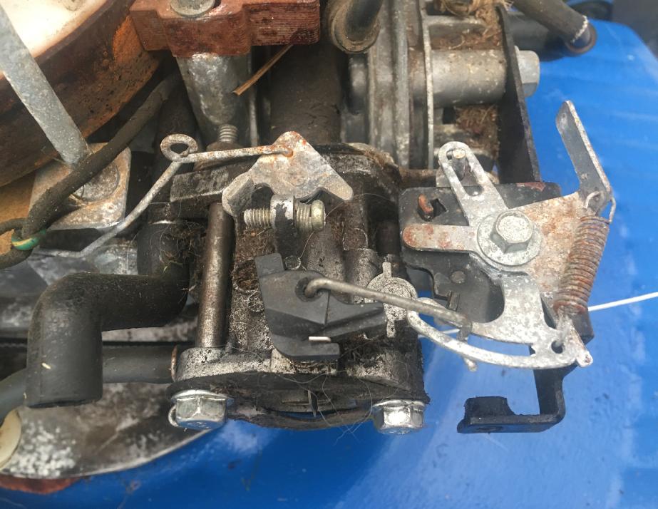

So today the cable has arrived & ive taken some photots as requested.
The cable just reaches where it clamps down so thats its position.
I now need some infor please on where throttle lever should be in relation to where govenor arm should be befor i clamp it down.

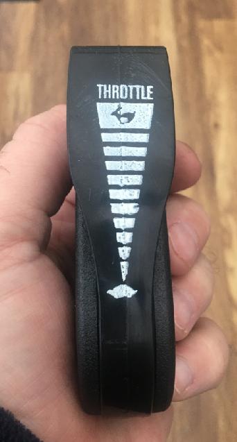

Third picture in........
Move the plastic lever to the left or right until the carb butterfly nearest the engine is on full throttle.
Set the new hand control to the Hare position and connect the new inner cable to the plastic lever.

So please see my short video clip so i understand what was advised above & with a question reference the lever arm position, its actually metal.

You are correct, the outer carb butterfly is the choke, the inner the throttle.
This is where I'm becoming unstuck, because the lever you are operating by hand is linking around the choke flap, and has nothing to do with the throttle!
I'm wondering, is this a constant speed engine, with no throttle management other than that provided by the governor? They do exist.
Can you move the metal lever any further, to bring the choke into operation?
Are you able to start the engine as it stands?
John :)
Can you move the lever to position B - and move it further? Just to bring the choke butterfly into operation.

Did you spot the spring was missing,need to get another but its so light that wont be an issue at present.

On every Briggs engine I have seen, the choke flap needs to close completely to allow a reliable cold start.
See the loop on the wire going from the throttle down to the governor......the loop is there for a reason, namely the end of a spring.
It's my guess that there is a spring missing from the choke linkage mess to that loop.....something has to connect to the throttle butterfly!

Post #12 mentioned spring was missing.
One in the post to me.
So I read what you wrote about clamping it up but you then asked if the lever could be moved more. So yes it can.
So do I then do as advised or because the lever moves more I need to do something different
