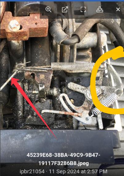

This is why i want the rpm to increase.
I have the throttle set at HARE & have bent that rod as mentioned on the carb,did it in situ so assumed it moved ?
It will take ages to cut lawns like this so what do you think ?

Unfortunately there aren't any adjustments to be made by a screwdriver or whatever - other than it's idle or tickover speed.
All you can do is to ensure the machine is getting full throttle when the handlebar lever says it is....any more movement should bring the choke on.
As far as I can see, adjusting the rod I mentioned is the only way to go.

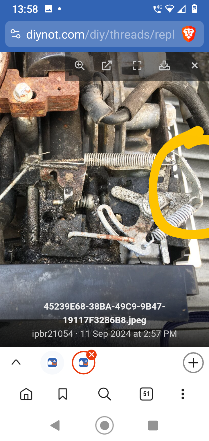

Is this the part you tried bending

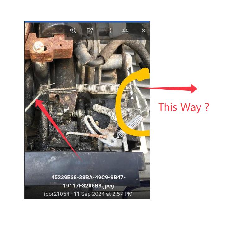

So in the photo you are saying bend it TO THE RIGHT correct ?
