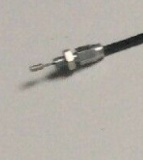

The original throttle cable that went to the carb had a brass item on which was threaded & passed through a hole in the casing.
The throttle cable would pass through this item & the lead fitting on the end would locate in its hole on the carb.
You could then adjust the cable by adjusting the 2 nuts either side of the caing & ran well.

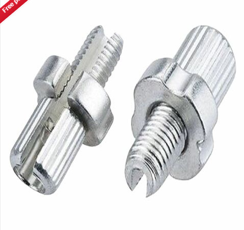

Need something like this.
Do you know what it is called ??
Its a standard cable adjuster, some come with a split so you can slip it onto the cable. EBay is the pal here, you may need to make up your own cable to suit the cow horns.

Ive seen this on ebay.
My question is the old one had a nut either side of the hole in the casing.
Would this item work ?
I mean it would fit over the cable on the carb side then just push into the hole or if i buy 2 i could use the nut off the second one & use it as a lock nut on this one ?
What do you think,thanks
That's the sort of thing you need, preferably with a split nut either side - but you may get away without it as the carb has a spring to help close the throttle.

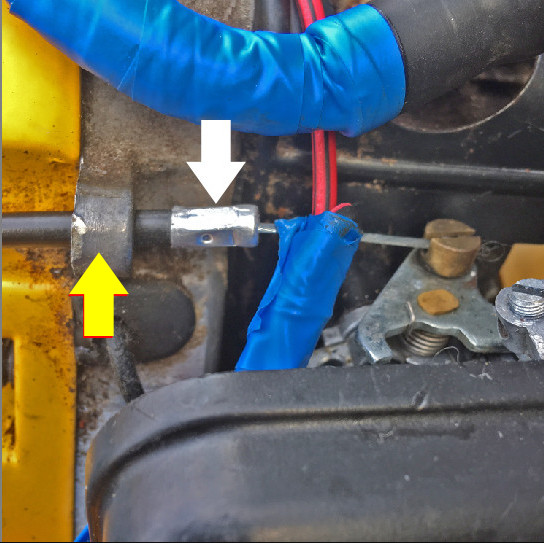

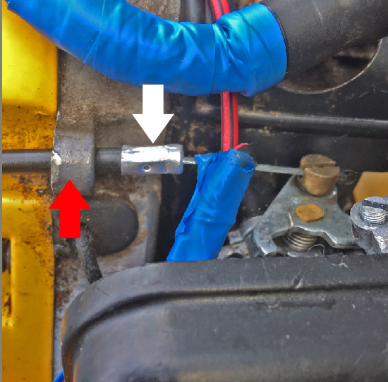

I have fitted the horns / bars to the strimmer.
If i put the outer cable in the hole / casing from memory and as supplied photo in post 2 above the inner will be pulling on the throttle lever thus revving at 10,000 rpm etc at start up.
Do you agree ?
Looking at my photo attached you will see the end of the outer cable WHITE ARROW & the hole in the casing where i will fit the adjuster YELLOW ARROW
Should the main part of the addjust /end of the outer cable be to the right of the hole / casing ?
The cable adjuster, if its needed, goes on the left side of the casing i.e between the engine and the handles.
Can you connect the new cable to the machine but leave the inner wire free, so we can see what we are dealing with?
John :)

Ive not used the adjuster but i think i will need to as there is nothing to stop the outer casing pass through the hole in the casing.
So ive pulled on the inner cable & with the chrome end of the outer cable on the left hand side of the aluminum casing the inner cable extends towards the carb 1/2 inch :mrgreen:
There is slack in respect of how the cable is routed so what if i cut the end of the outer cable say 3 inches ?
Then when i put it in the adjuster it wont need that chrome end on the outer cable as the adjuster has a tapered hole.Then the inner will extend through that aluminum hole in the case say 3 inches ?
Will this help
One easy bodge to prevent the outer cable passing through the aluminium casing......
Find a smallish washer and hacksaw a slot in it, which will allow the inner cable to pass through
Locate the cable and washer to the left of the casing
Nip up the washer to close the slot so it cant drop off. The outer cable will now stay put, at least temporarily.
You probably will need to shorten the outer cable a bit, so check out my post #8......its reasonably easy to cut the outer with side cutting pliers, but with the inner cable still in place makes things very difficult!
John :)
