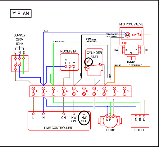

I had hoped the test I suggested would result in the valve moving to its heating only position. A 3-Port valve relies on a 'hot water off' signal to close off the hot water port of the valve when hot water is not required, but the heating is still 'on'. This connection is definitely missing from Terminal 1 of your programmer....

.....and would also appear from the failure of the test to be missing from your cylinder thermostat as well. These connections would be the wires connected to the terminals shown in the black rings from the Cylinder Stat and Time Controller that are connected to the grey wire from the motorised valve.
There could of course be other faults, but this is where I would start. It could just be that someone has replaced 2 x 2-Port motorised valves that don't need a 'HW off' connection with one 3-Port motorised valve which does.

As per @terryplumb you are missing the hot water off connection from the programmer. However, there is also a second source for a hot water off signal and that's your cylinder thermostat.
With heating and hot water both set to 'on at the programmer, if you turn the cylinder thermostat to maximum, and the central heating room thermostat to maximum, the motorised valve should be in the mid position. Then, if you turn the cylinder thermostat down to its minimum position, you should hear a click from the thermostat and the valve should move to the heating only position. Does that happen?
I went back to it after an hour and the the switch had moved to "H" and the thermostat on the cylinder clicks on and off when I moved it higher/lower which changed the position of of the valve to M and H respectively.
In that case, it sounds like just the 'heating off' from the programmer is missing. But odd that it didn't work when you first tried it, but did an hour later. :unsure:

The 'heating off' connection from the programmer is definitely missing, so it may only be that that needs to be added. But there could be other issues elsewhere as well. For someone reasonably competent electrically, as a test, it shouldn't be too difficult to run a temporary wire direct from terminal 1 of the programmer to the motorised valves grey wire, and the system tested. Then if it's successful a new cable can be installed properly.

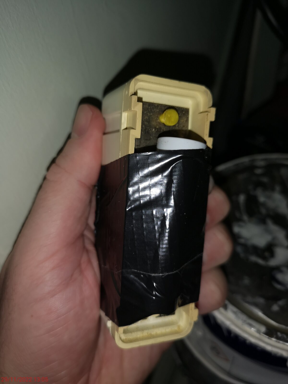

I've found a crude work around to get central heating only. I removed the thermostat from the cylinder. At first I thought to attach it to the flow pipe thinking the heat from the pipe would stop demand from the cylinder, however I realised that pressing in the metal plate on the thermostat stopped it from calling for the cylinder to be heated. A small plastic egg timer and duct tape now gives me central heating without the cylinder being heated up.

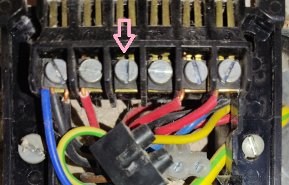

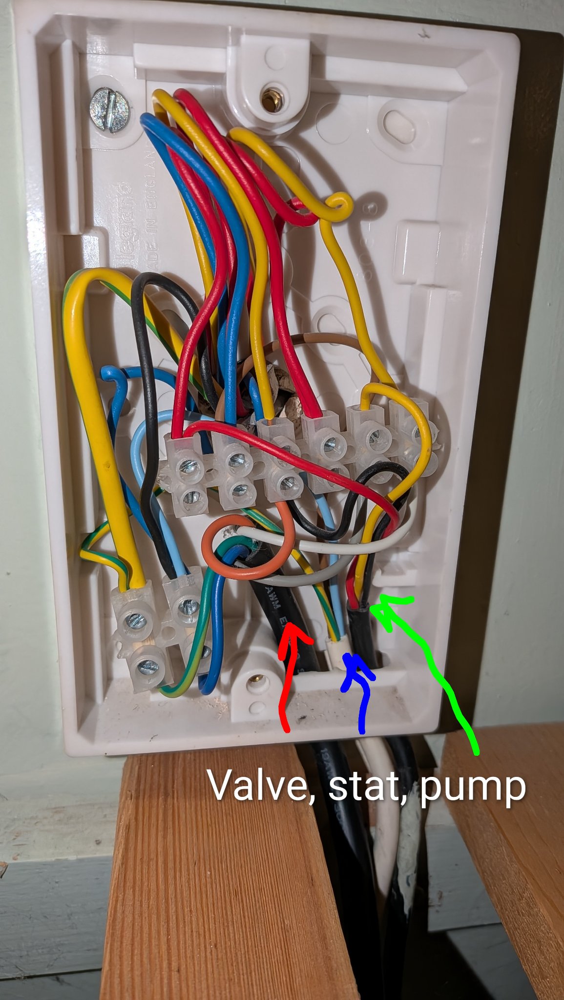

Just to recap were we're at, when heating only was selected at the controller, the cylinder would also heat up at the same time until it reached the setpoint temperature on the cylinder stat, then the valve would switch to heating only - basically it was not possible to have the heating on its own without the cylinder heating up first. You and @terryplumb helped come to the conclusion that it was down to an incorrectly wired controller, the heating off wire wasn't present at that end.
I've taken a photo of the wiring centre near the cylinder - does the wiring look correct from that end? I was looking at the wiring to the controller and notice 3 wires going to the first terminal, does that look right?
Thank you in advanced for your time and help.
