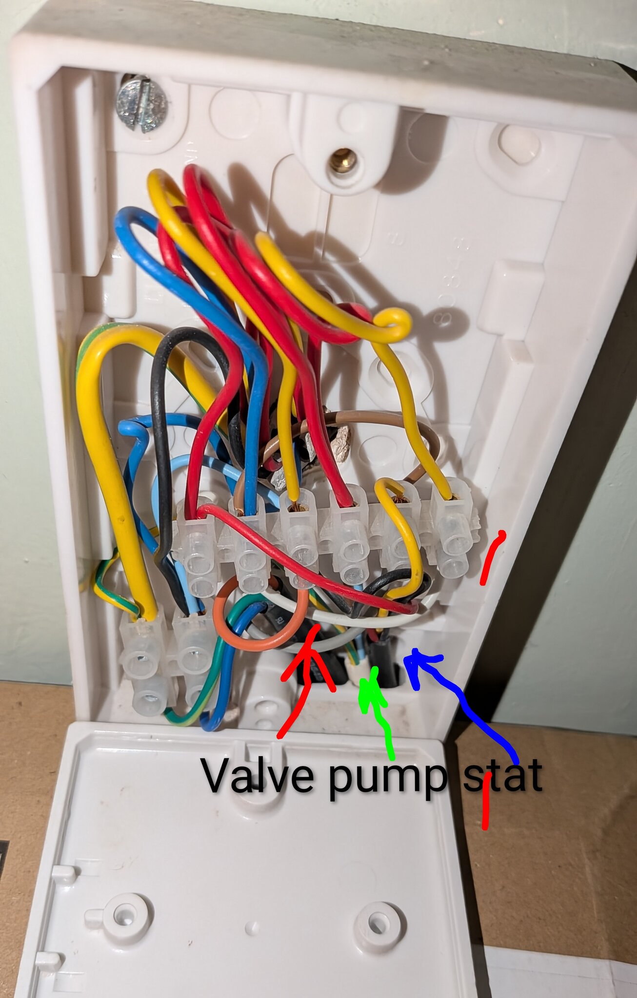

Moved house, not familiar with this heating system. How does it work, best set up?
Sadly it's impossible to tell from the photo. We can see the wires labelled valve, stat, and pump coming in but not what they are connected to at their final destination. Unfortunately wiring colour rarely offers any help because the colours chosen are at the discretion of the original installer.
It will be a matter of tracing each wire to find out where it goes and then checking it matches the Y Plan diagram I posted earlier in the thread. One oddity For example is the cable you have labelled 'pump' (red, black, yellow) it doesn't seem to have any of the wires connected to an obvious neutral connection.......but obviously if the pump is working it must have somewhere :unsure:

Great spot. I'd actually mislabled the pump and stat. There's no sign of of the missing cable.

1 earth from pump and valve, earth to?
2 neutral from pump and valve, black wire from stat, neutral to?
3 live from stat, live to?
4 live from pump, neutral to?
5 orange from valve, yellow from?
6 2 live to?
7 grey from valve, yellow from stat.
8 white from valve, yellow to?
Having a look at this again. I think it needs more than just a new grey "hot water off" wire to remedy it. LIVE and NEUTRAL connected at point 4??
