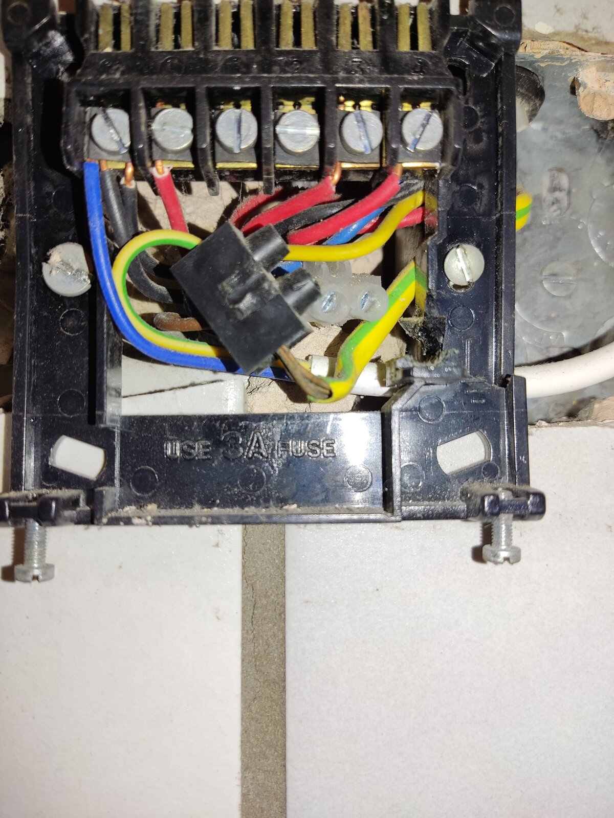

I'm thinking the programmer wall plate has been wired in wrong and that getting a newer programmer won't solve the issue?

This is the wiring behind the wall plate...

With it back in "G" mode this morning, I tried the hot water only, the valve was in the "W" position. Turned the hot water off then put heating on, the valve moved to "M" and stayed there until I turned the heating off, it returned back to "W".

OR more likely to be that someone has messed up the wiring, realised their mistake and bodged it up in "G" mode at the programmer?

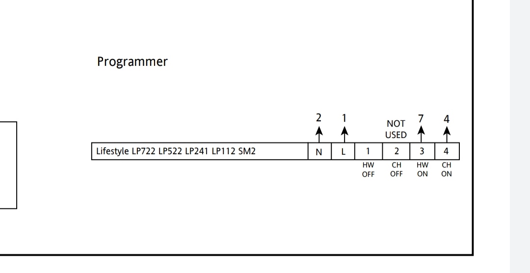

That's not wired correctly for a Y plan set up with a 3 port valve ,there is no connection for Hot water being satisfied. Is there no thermostat on your hot water cylinder ?

As per @terryplumb you are missing the hot water off connection from the programmer. However, there is also a second source for a hot water off signal and that's your cylinder thermostat.
With heating and hot water both set to 'on at the programmer, if you turn the cylinder thermostat to maximum, and the central heating room thermostat to maximum, the motorised valve should be in the mid position. Then, if you turn the cylinder thermostat down to its minimum position, you should hear a click from the thermostat and the valve should move to the heating only position. Does that happen?

No ,you can only manually latch it in mid position. It returns to domestic hot water only Port ,under its spring pressure, if no voltage is supplied to it.
Your set up /( wiring) is such that you are stuck with both heating and hot water coming on simultaneously when heating is called for.
The temperature of the hot water in the cylinder doesn't appear to work Under the control of the cylinder stat, so the temperature would get upto the temperature of the central heating water under the control of the boilers thermostat ,whatever that may be set to.
If you want to have the system working as it should ( Y plan) you will need an engineer to rewire it all.
