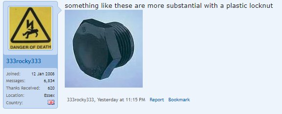

Any chance you could link to anblanking plug? Have searched Screwfix and toolstation, but can’t see them?
Ah is that all I need? I have loads of those. I just assumed it would be a more specialised blanking plate if it were to retain the box’s IP rating, no?
Cheers
You'll be taking the cable away, so there won't be anything electrical in there to need an IP rating.
A box with a hole in the bottom is still IP13!
something like these are more substantial with a plastic locknut

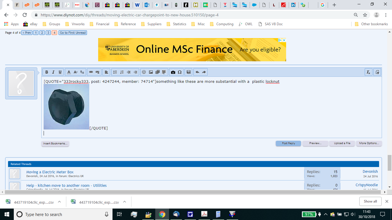

For what it's worth, it has for me - and not only in Rocky's original post but also even in your quote of that post!
Kind Regards, John
Maybe he means the thing where you click on it and it takes you to the site, the pics from TLC but im sure they will be cheaper on ebay "20mm threaded blanking plug"
Maybe he means the thing where you click on it and it takes you to the site, the pics from TLC ...
Maybe - but although I can see your picture. clicking on it does nothing for me, and nor is there anything else to click on.
Kind Regards, John

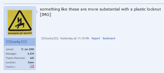

Strange regarding picture. All I see is a little box with [ img ] in it, and can’t click it.
Regarding looking inside the box, no I haven’t yet, that would’ve been far too sensible. It’s on the job list for today. :)

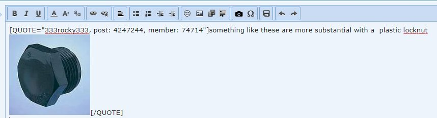

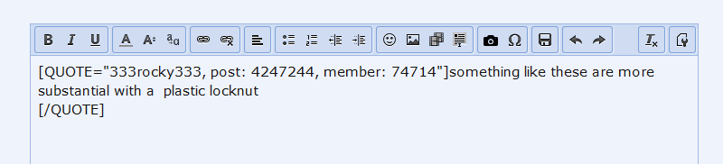

It's unusual for it to be this way around - it's usually me who sees placeholders rather than images, when most other people see the images, so this must be the exception which proves the (bizarre and annoying) 'rule'. I see this in the original post ....
... and this when I quote it ....
Kind Regards, John
