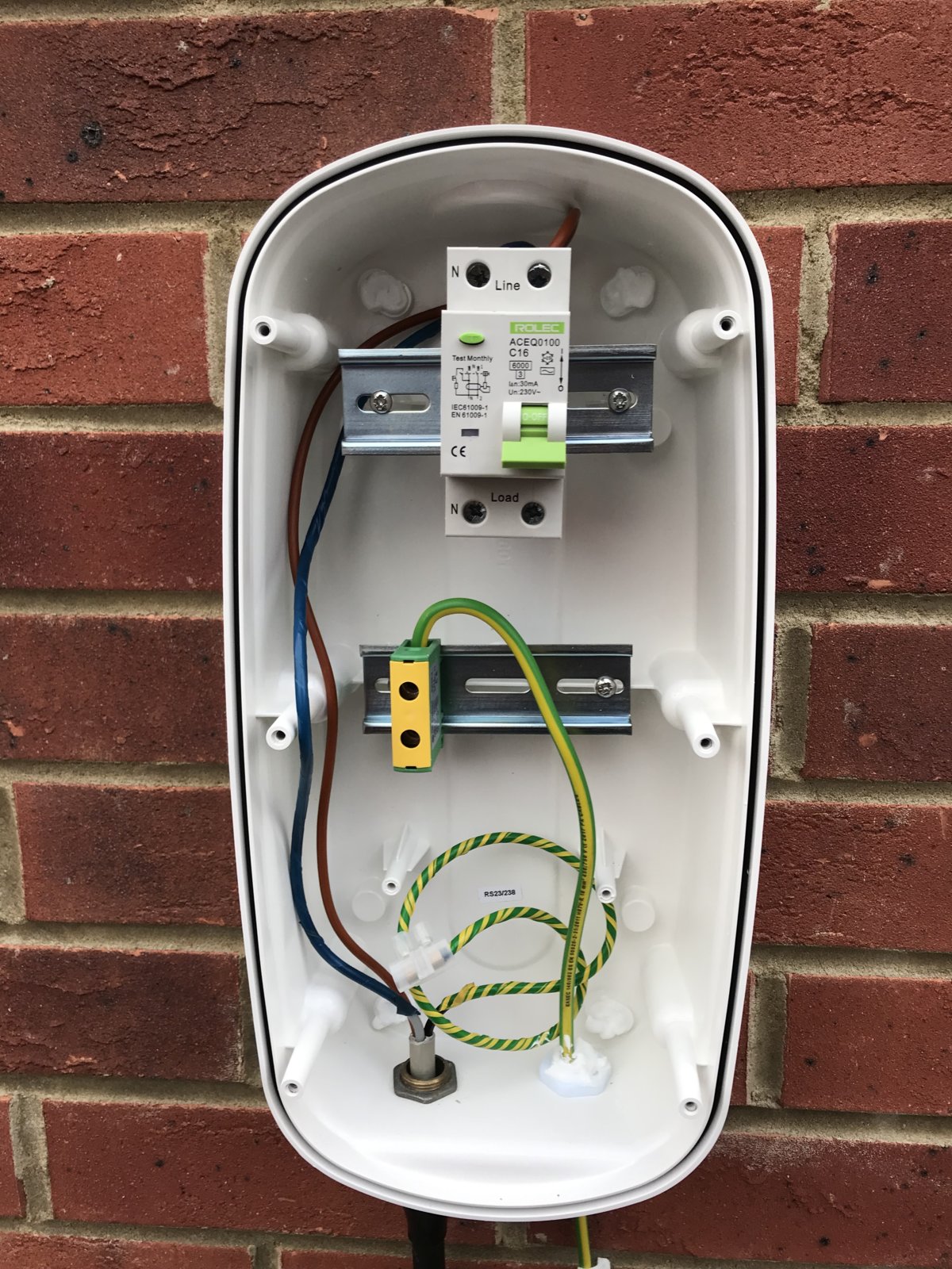

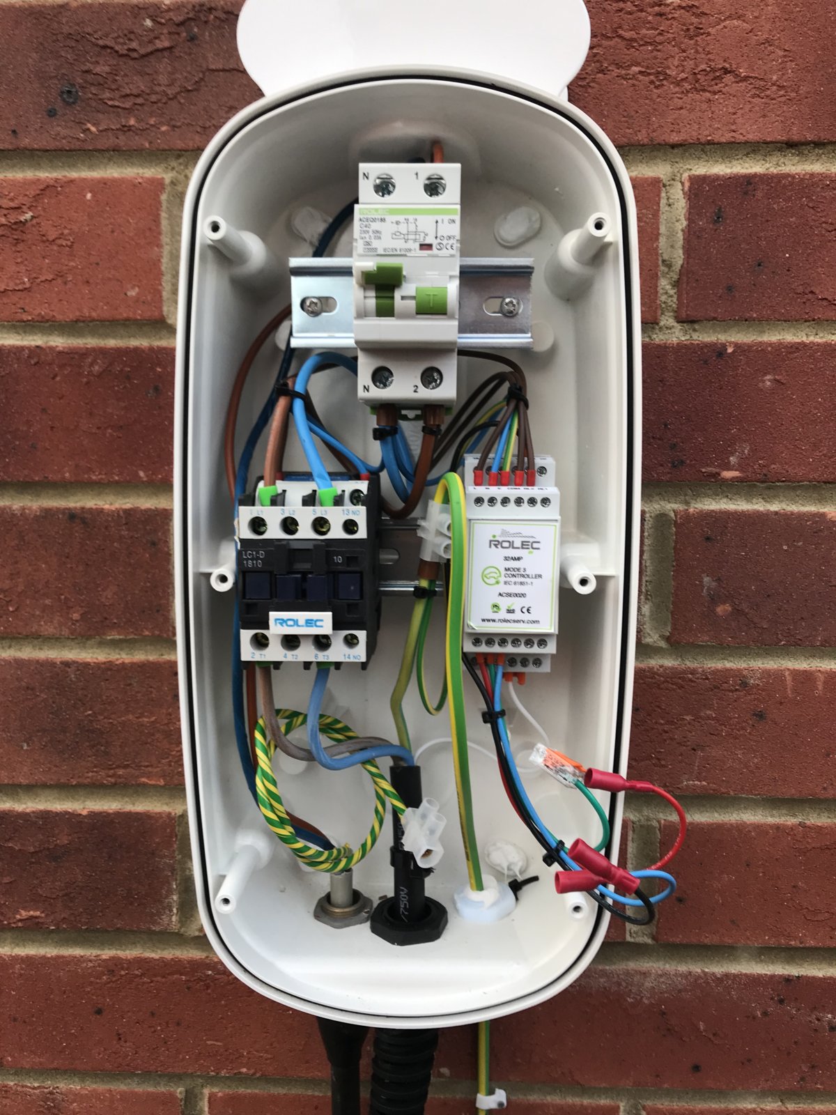

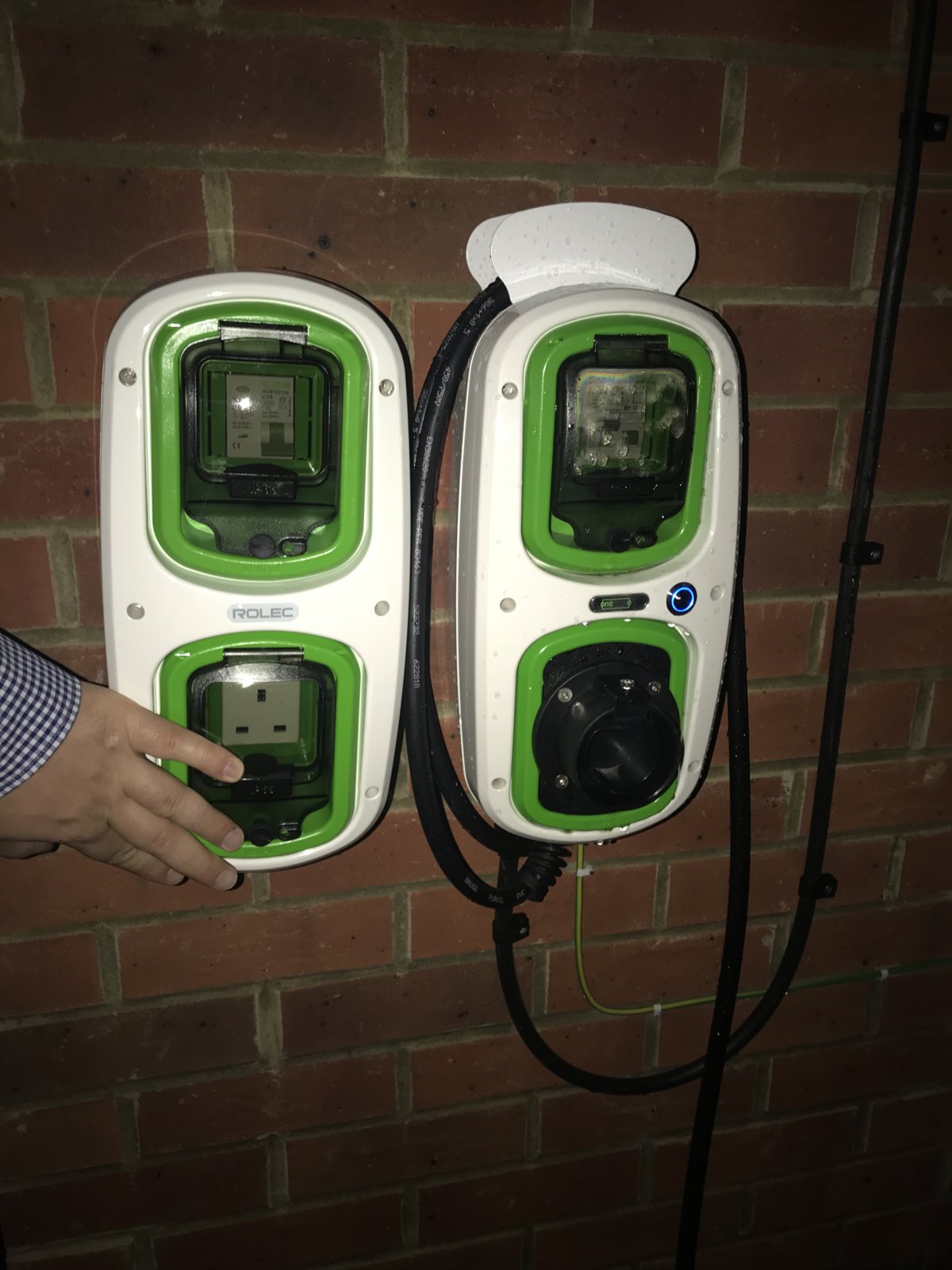

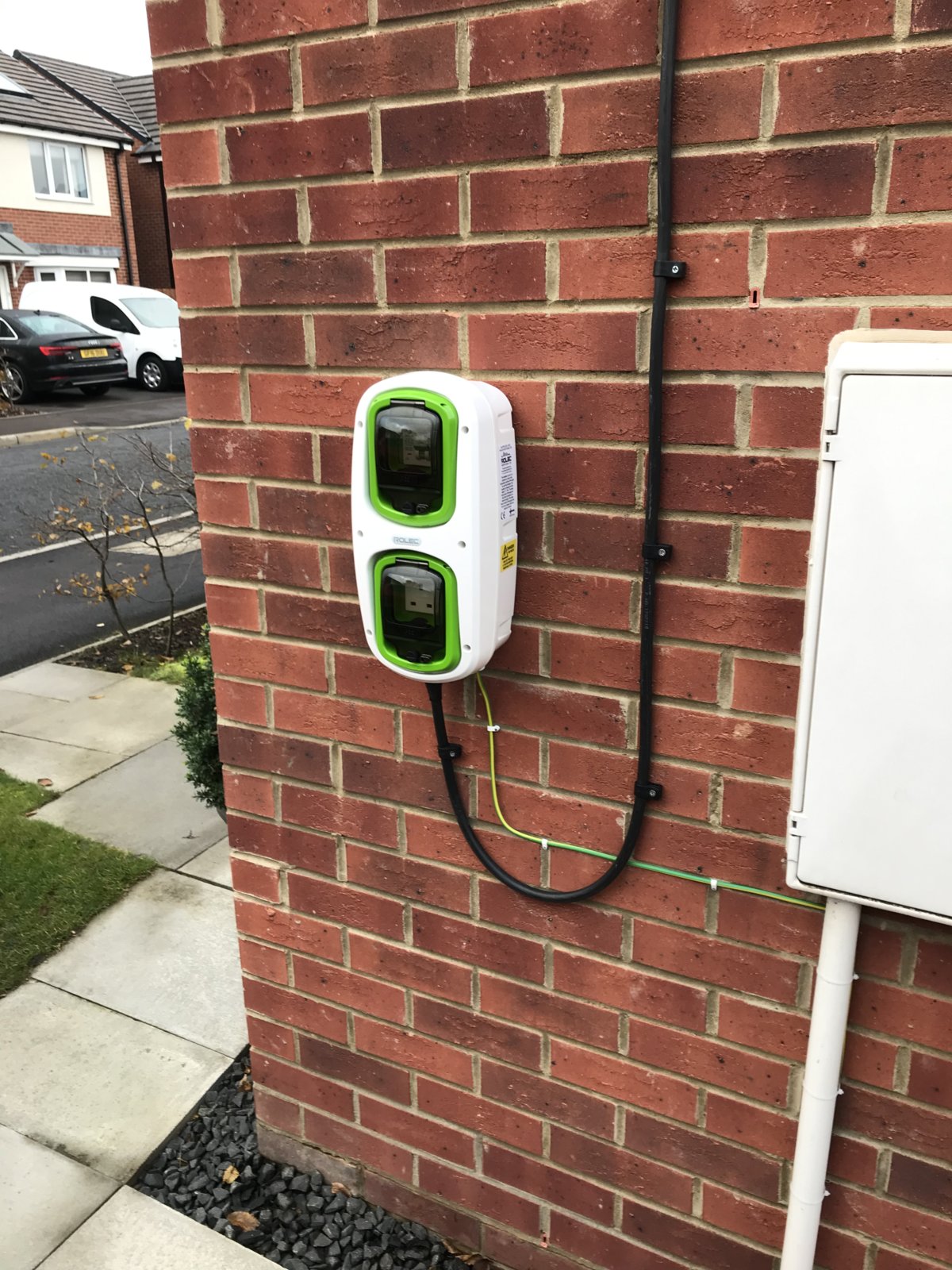

Ok, so decided to go for the option of replacing the charger with a similar outdoor socket from the same manufacturer. Mostly as the buyer’s solicitor was demanding we “make good any damage done by removing the charger to the buyers standards”. Lawyers eh?
Side by side:
So, swapped it over today.
Old:
New:

Am I right in thinking I needed to keep the existing earth arrangement (separate earth rod) to avoid it being notifiable?
Cheers
