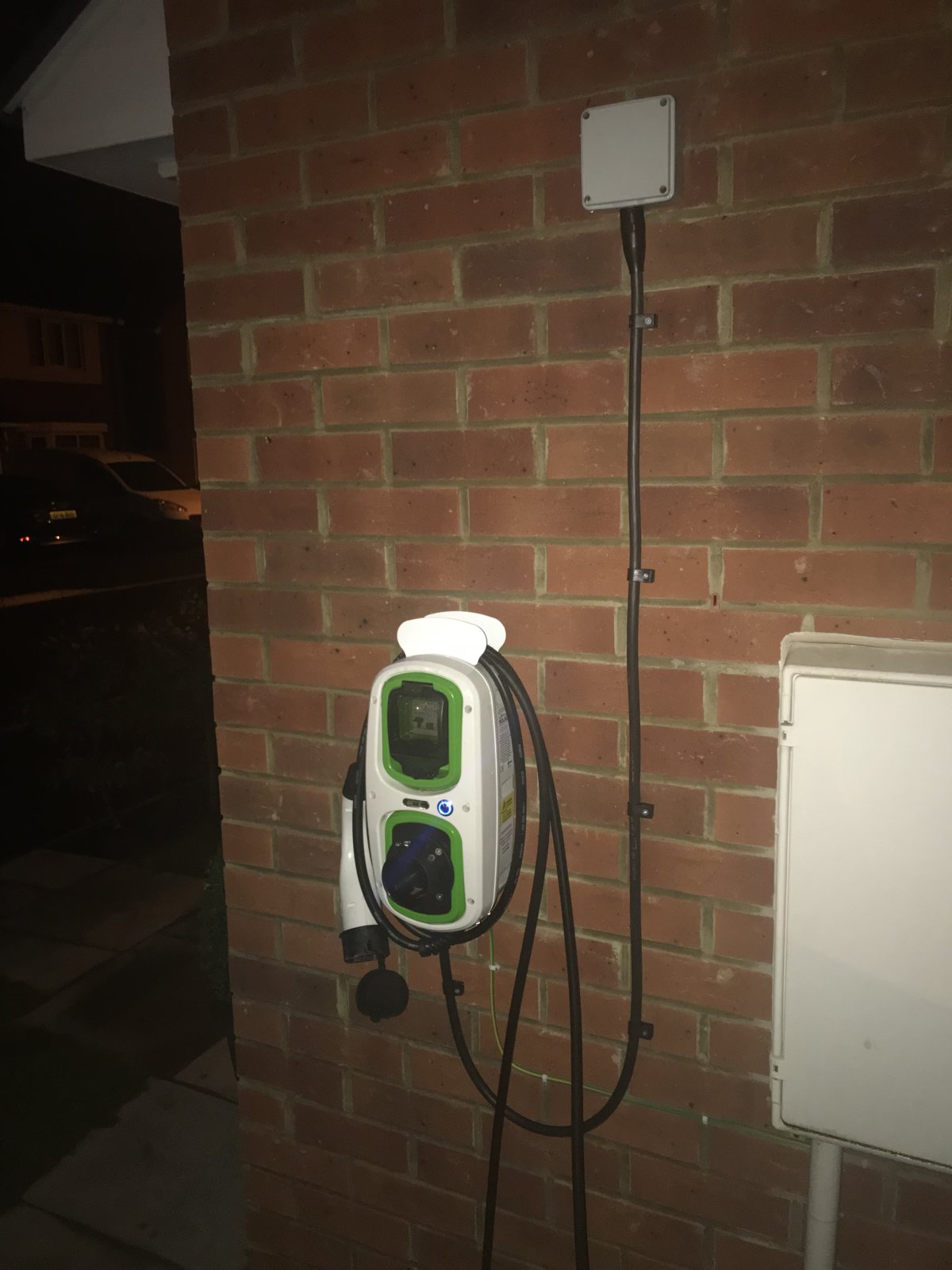

So, this is the current setup:
If I want to avoid having to buy another charger outright, I have three options as I see it.
a) remove the charger, junction box, all wiring and the 40A mcb from CU. But this will leave a huge hole in wall where cable came through from the CU.
b) unscrew the front of the charger unit, leaving behind the baseplate and fit the following for £80, which is basically a glorified outdoor socket. https://evonestop.co.uk/products/wallpod-ev-ready-3pin-uk-domestic-socket
c) last option would be to remove the charger and surface mounted cabling, and put an outdoor light in place of the junction box. It is at the perfect level as there is another light just around the corner.
I value your opinions. Cheers
Now that does sound "punitive" - all you want is the charger. It has to be left safe, but that doesn't mean you need to remove the entire circuit.
Huge?
Or about the size of the cable?
Personally I'd put a single-gang Masterseal or Wiska etc junction box there to make the cable end safe and leave the new owners to decide what they want there.

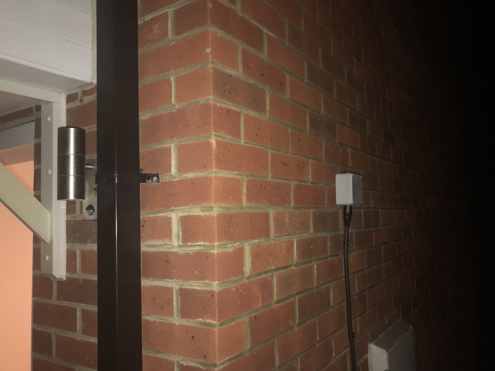

or remove the ugly armoured cable as well and fit a blanking plug in the existing box.
I really should have looked at the photos.
Remove the charger and the surface cable feeding it.
Leave the existing high level JB alone, and put a blanking plug in the bottom to keep spiders out.
