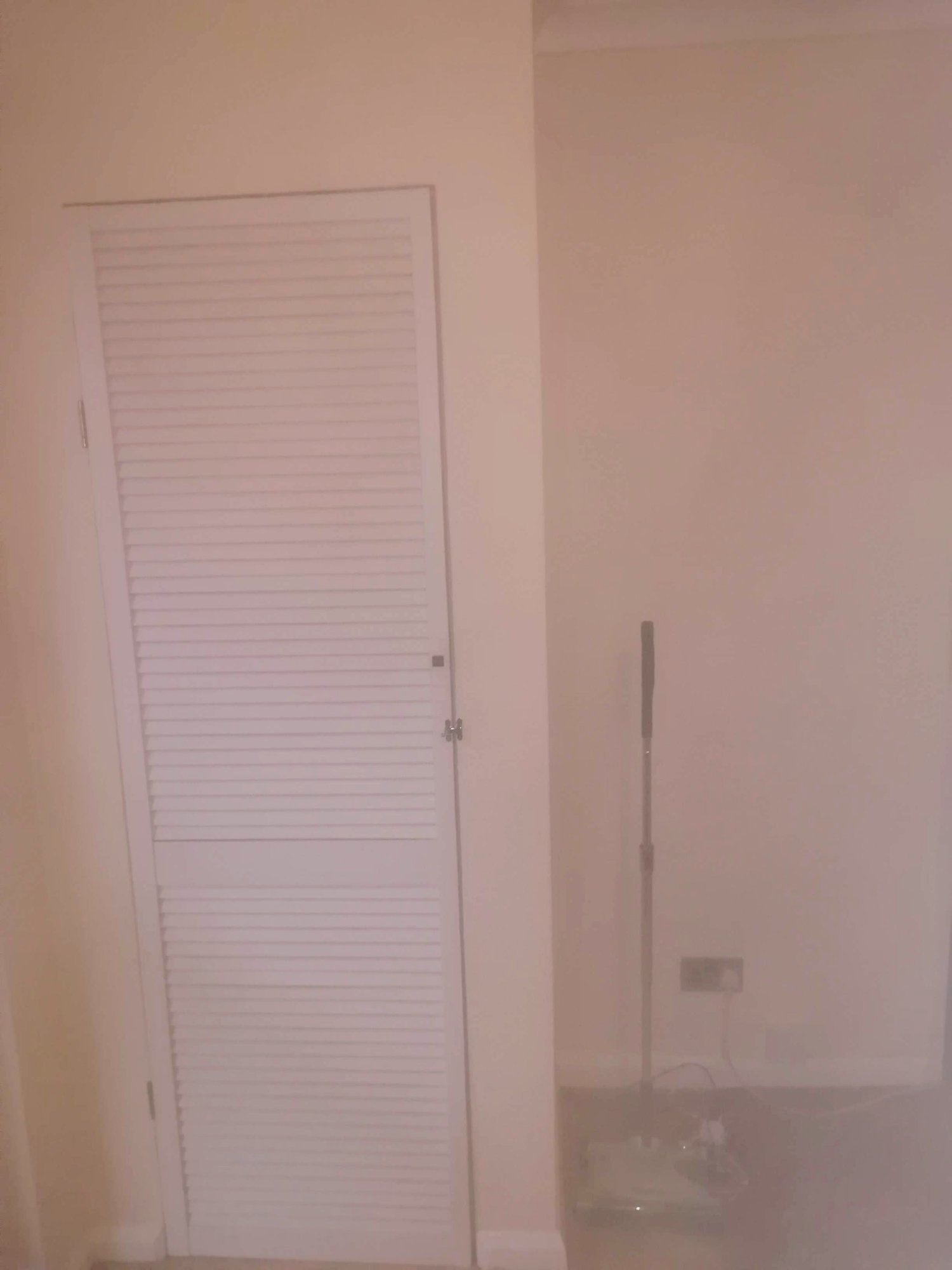

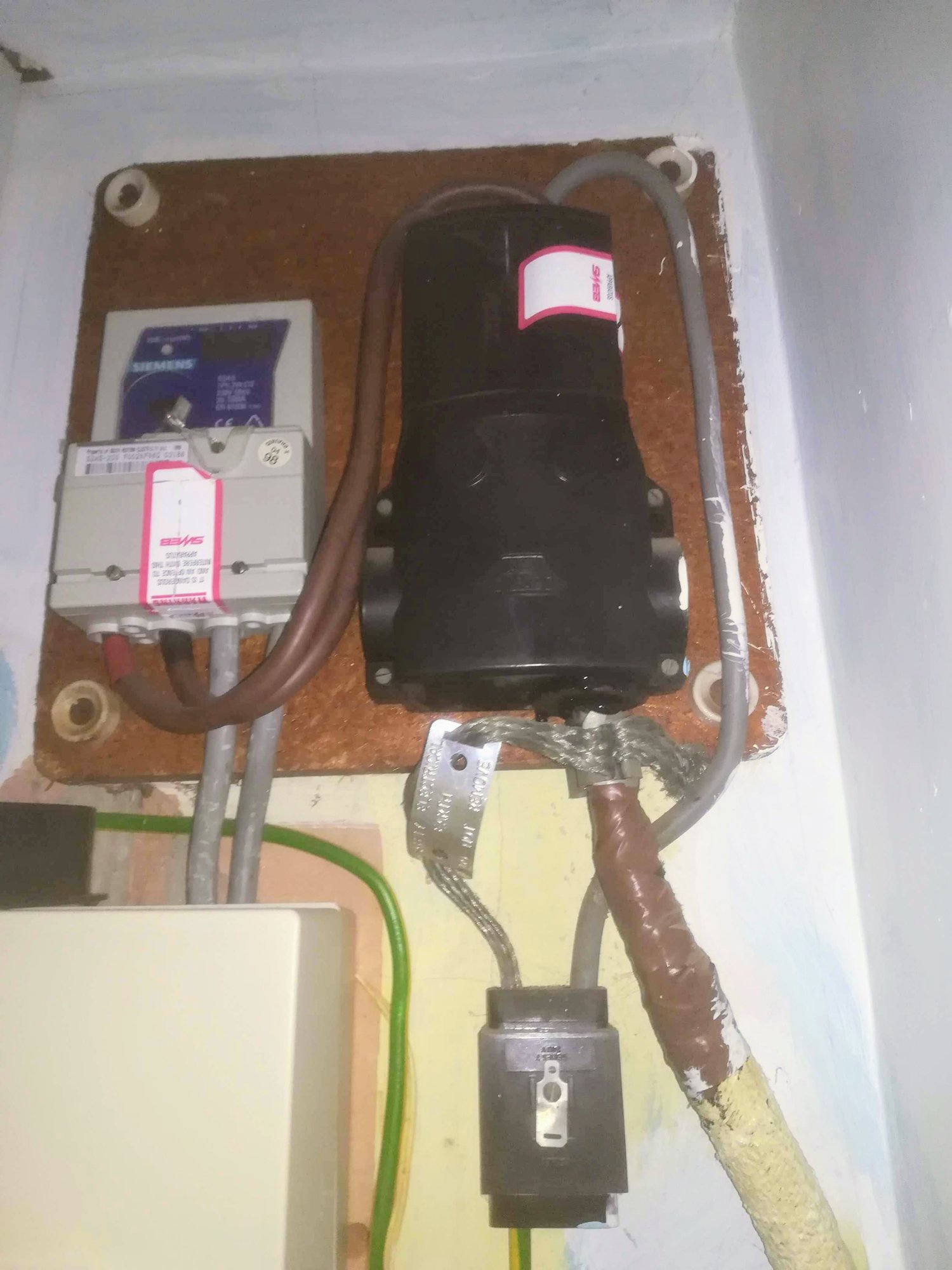

Looks like this, basically the cupboard is going and the cable and fuse just need to be re-positioned to the right and lower down

No chance of moving that without a re-termination.
