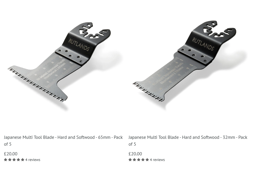

I've not found any better, more aggressive wood blades than these at Rutlands https://www.rutlands.com/collections/oscillating-saw-blades
Nor cheaper alternatives with the same performance :cautious:
