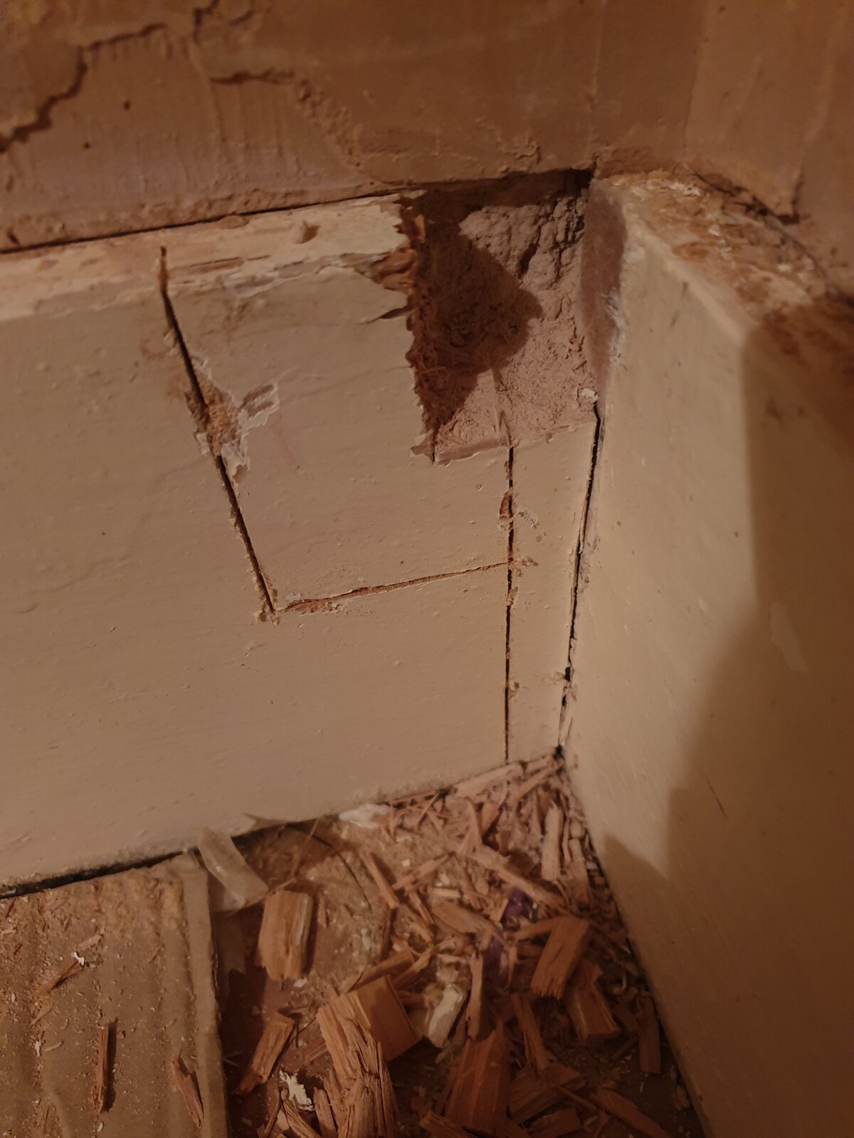

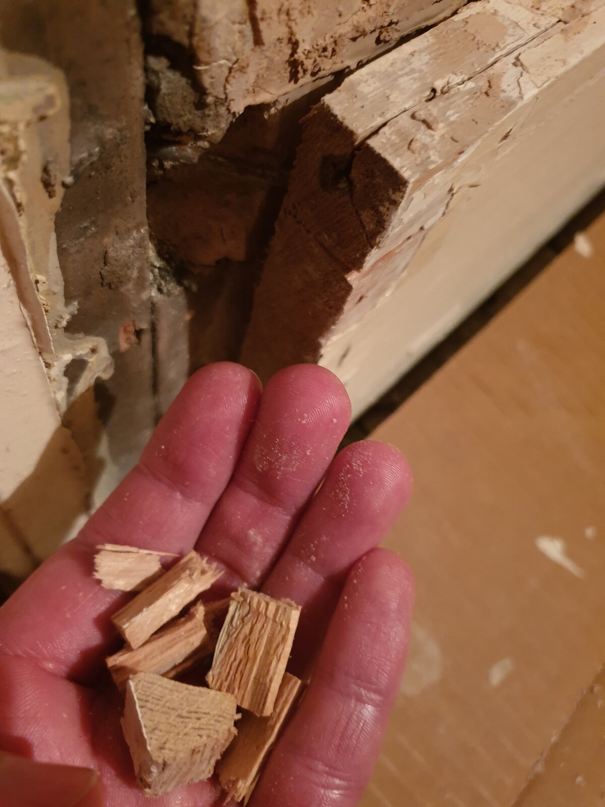

I need to remove a skirting board without damaging the new plaster above it (should have done that beforehand really, I know), so I thought I would just cut it into small pieces and remove them one by one, but my Erbauer multitool wood blade can't cut deeper than the outer layer of this fiberboard/MDF/whatever it is. I chipped a few bits off with a chisel just to see what I'm dealing with.
Is there any blade that would work for this board?

I know it's nails, so I'm not trying to cut it off the wall, but rather trying to cut in a few smaller pieces to deal with them separately. The issue is that my blade cuts just a few mm deep and then keeps scratching it with no progress no matter where I make a cut.

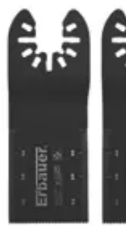

What type of blade is it? Metal cutting and multi material blades with small teeth don't cut quicky. The bigger the teeth the faster it will cut, but you also need to clear waste from the cut and the teeth. As @Koolpc says, try a new blade, prefwrably a wood blade
You need a new blade. Thats my opinion.
You were right, I managed to get by with the old one though, it just required more pressure and patience
It was a wood only blade but the teeth were worn out a bit. I managed to do it in the end with that blade. Time to get a new one now as I ran into a couple of nails along the way
Nails kill blades! Basically, multitool blades are now so cheap that a pack of 20 costs £1 or less a pop
If you think that there may be any metal in what you are cutting (e.g. nails in skirting) then you need to use a bimetallic blade (i.e. with HSS teeth)

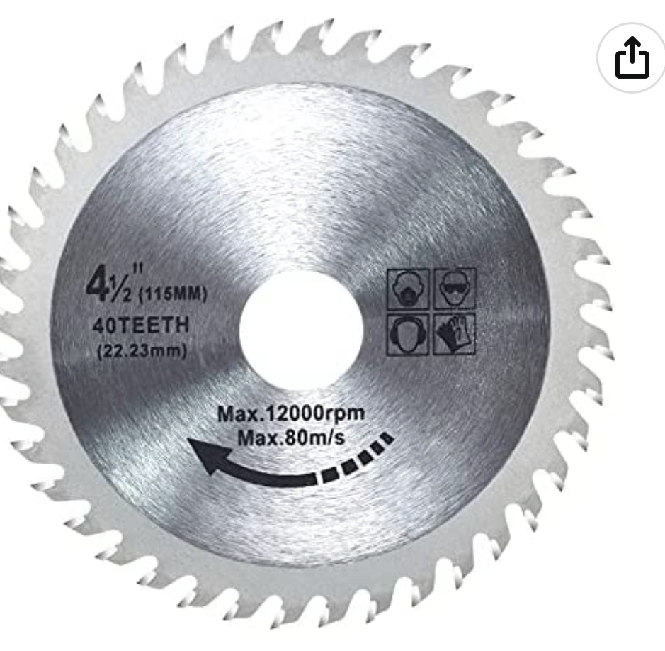

Another alternative is this attached; a TCT saw blade for a grinder. Much more dangerous (potentially life-endingly so) and messy but will plunge cut in awkward spots. You might have to chisel the face of the board off after you cut through it then go deeper with another cut to the back of the board. I find the blade I have for my grinder cuts about 25mm deep but your mileage may vary depending on the shape of your grinder
Do your research and make yourself fully aware of the injury/death risks in using one of these

Another alternative is this attached; a TCT saw blade for a grinder. Much more dangerous and messy but will plunge cut in awkward spots.
Absolutely NOT. A multi tooth circular saw blade should NEVER be used in a grinder. The risk of kickback (because the tool has no base and no riving knife) combined with totally inadequate guarding (as a saw) makes it a stupidly dangerous thing to do. There has been at least one death in the UK of someone using this sort of set-up (search the Leicester Mercury), and saw blades for this purpose have been banned for sale here in the UK for several years
Good job I didn't mention the blades with chainsaw chains mounted on them then!
J&K's point is valid; these blades are incredibly dangerous and you need to be really comfortable with the risks you take using them. I'm not sure I'd use one in an AC grinder, but I've no qualms using one with extreme care in a battery grinder (with a half charged battery)
If you want a lower risk option you can use slim "for metal" stone cutting wheels, or slim "for stone" diamon cutting wheels to cut through wood with embedded nails. The wood burns more than cuts but it works
