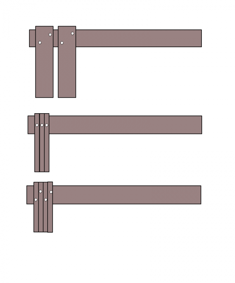

A quick question, I've seen some picket fences where the screws/nails on each pale are offset at an angle instead of parallel to each other (see sketch 1 in attached pic) - what's the reason for positioning the screws in this manner. Is it to prevent the rail from splitting if the screws are too close to each other?
Also the battens I'm using for the pales are only 1 1/2" wide and I want to fix each batten next to each other without any gaps in between. That means each screw between each batten will be spaced approx 1 1/2" apart - won't all these screws being so close to each other risk weakening/splitting the rail - (see sketch 2 in attached pic)?
Or should I be positioning the screws like in sketch 3 in a zig zag fashion. Maybe I'm overthinking.

putting lots of screws in a row increases the risk of splitting, especially if they are not pilot-drilled. It is worse in thin sections.
Outdoor timber swells and shrinks a lot with the weather, so is very prone to splitting.

So how would you suggest I fasten the battens?
your third picture.
If you can fit in three rows, even better
