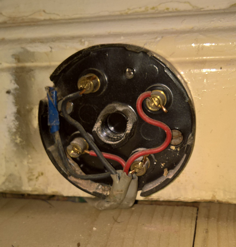

Hi all, I have this old electrical terminal attached to the wall. It's all cracked up so I want to replace it and take it off the wall and put it under the floorboard.
Is this as simple as switching off the mains, buying a new terminal and putting the wires into that?
Also something of concern. I used a mains tester screwdriver on all the wires. A black wire and one of the red showed nothing. However one of the red showed having current as well as the other black which is the one taped up with blue tape in the image, so seems kinda dangerous!
Will a 6 terminal junction box like this one in the link below be ok to replace even if one terminal will not be used? Also some of these boxes have an AMP number. How would I know which amp I need? cheers

Ideally you need to find the location of the upstream supply to this junction and disconnect it there, rather than terminating underfloor.
It will not be current that you are reading but voltage and the equipment that you are using to perform this test is not a reliable one. Ideally a two pole/probe voltage indicator will measure a voltage.
A maintenance free Hager junction box (20 amp) would be ideal.
Be certain you have safely isolated the supply to this old jb fully. If in doubt get an electrician in.

I think you need to find out where those two cables go.
One possibility is that your socket ring is no longer a ring because those two cables are not connected together.
I had assumed these were lighting cables, but now you have mentioned 'socket' further investigation is required, as said.
A 20 amp JB MAY not be suitable if these are socket cables, and as said, MAY need further investigation.
The wiring and JB look very old, how are you so sure this was a socket once?
It looks like a lighting junction box to me, and as you say its live, possibly a two way Where is it situated, is it possible it is connected to a nearby Fused Spur box to give some sort of extra lighting ?

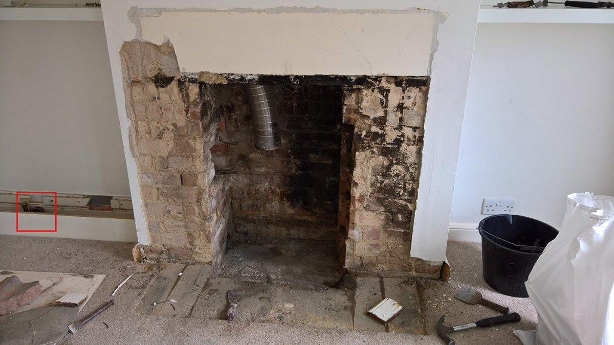

Here is a pic to show it's location. So it was originaly boxed up with what looked to be remnents of back boiler plumbing. I only assumed it was a socket as there was a filled in hole in the wall that grey square near it. Though thinking about it it's more likely it fed into the old backboiler. What do you think?

That's a possibility, but you really need to know for sure. Do you own a multimeter?
There are various approaches, but one option is:
TURN OFF ALL THE POWER FIRST.
Find all the cables that might be the other end of those two.
Disconnect from whatever they're currently connected to.
Measure the resistance between the red and black wires.
Then join the two wires together at the other end, and measure again.
If you get very high / infinite resistance when they are not joined and then very low / zero resistance when they are joined, then you know it's the other end of the cable. (Or, it's joined to it somehow.)
Old location for some kind of central heating programmer? These are old feeds to the pump/room stat/back boiler supply?? Too many options to try and guess....
