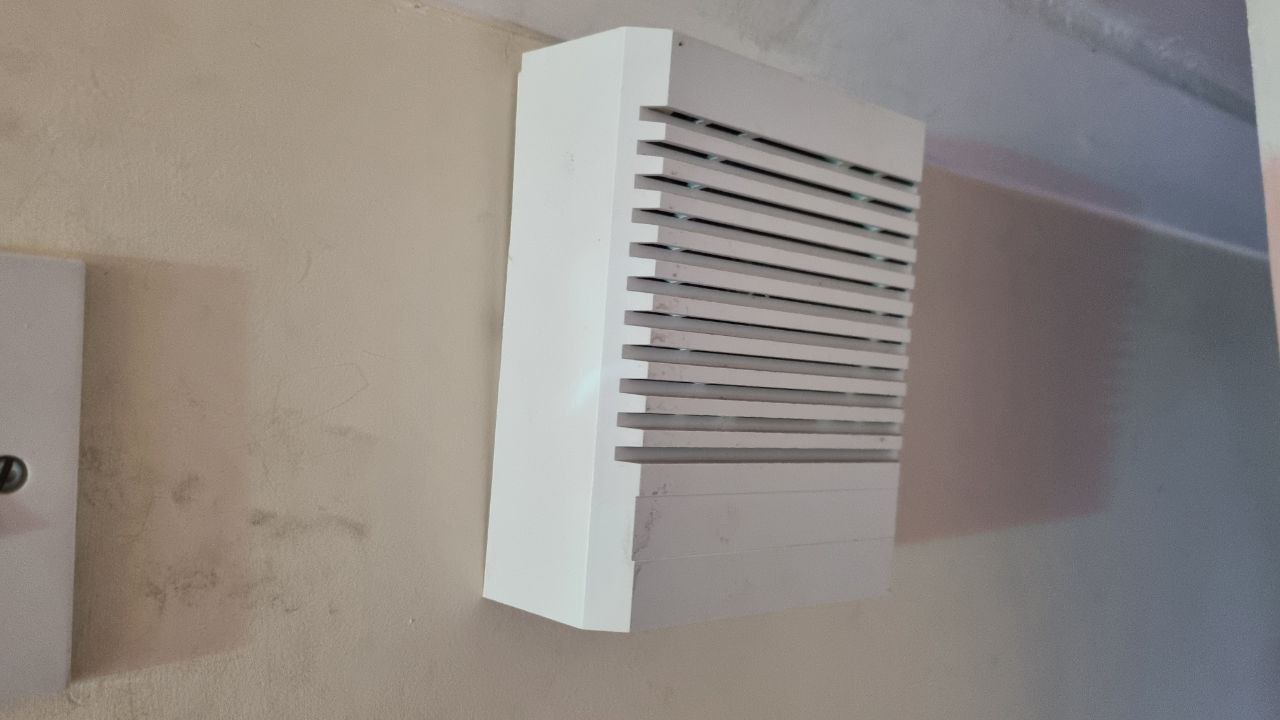

Just wondering if you can help me. I have an old Risco GT600P alarm panel as below and I need to disconnect the internal sounder box then reconnect it in order to re-locate it due to building works. I’m hoping to do this carefully with the system powered up, as I’m not an alarm guy and having to drill down into the panel’s menu and re-config doesn’t’ appeal unless necessary.

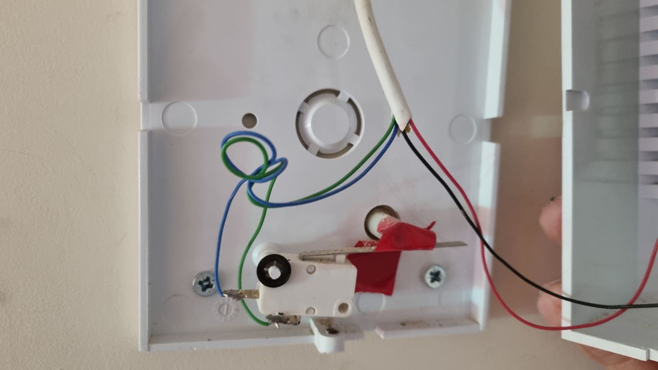

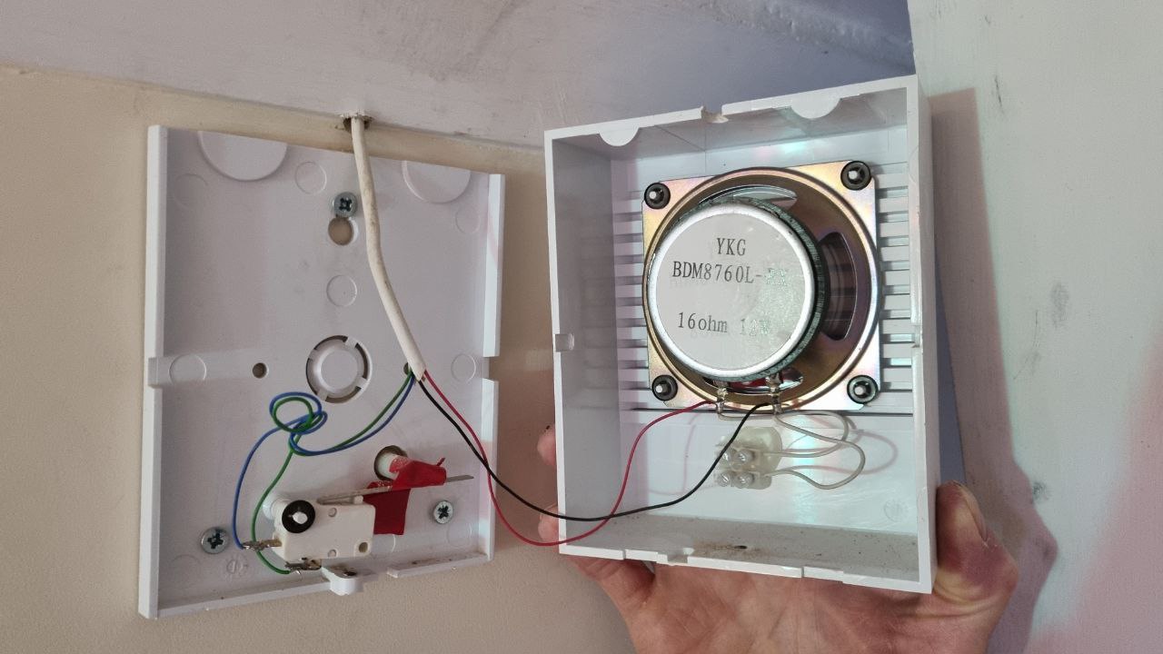

Fortunately I have the engineering code and while in this mode I’ve opened the sounder box to see what I’m up against (see photos). From what I see, all looks straight forward being a 4 wire system with the green and blue wires across the tamper switch and the red and black ones across the speaker, corresponding to these terminals on the control panel, i.e.:
Cont Panel terminal “SPKR +” = red wire
Cont Panel terminal “SPKR -” = black wire
Cont Panel terminal “TZ +” = green wire
Cont Panel terminal “TZ -” = blue wire
Assuming that the micro switch is normally closed, and the act of me removing the case screw at the bottom (holding the switch closed) hasn’t set any sounders off, I’m guessing that I could remove the switch wires without an issue while in Eng mode.
As for the speaker, I’m not sure if there’s anything special I have to do to before disconnecting it and insulating the wires. I’m a bit curious about the choc block across the speaker… I’m hoping this isn’t provision to prevent the panel detecting an open circuit if the speaker is removed is it? Just wondering if a specific resistor is needed across the speaker terminals as a dummy load while the speaker is absent as an additional security feature. Or am I over thinking it? I would be grateful if someone knowledgeable could tell me to just disconnect all the wires, move the box, then reconnect them. Or, whatever else I need to do instead.
