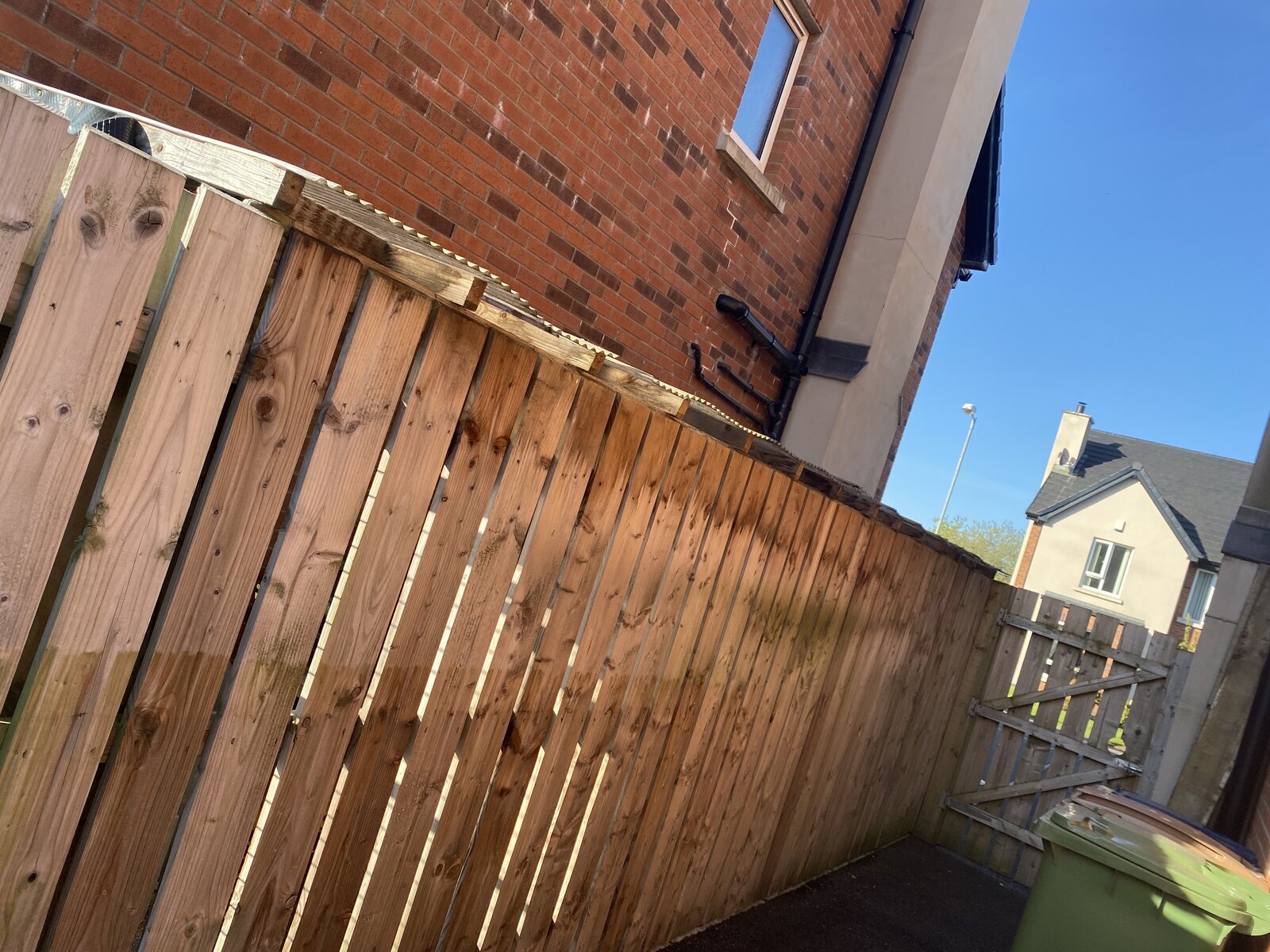

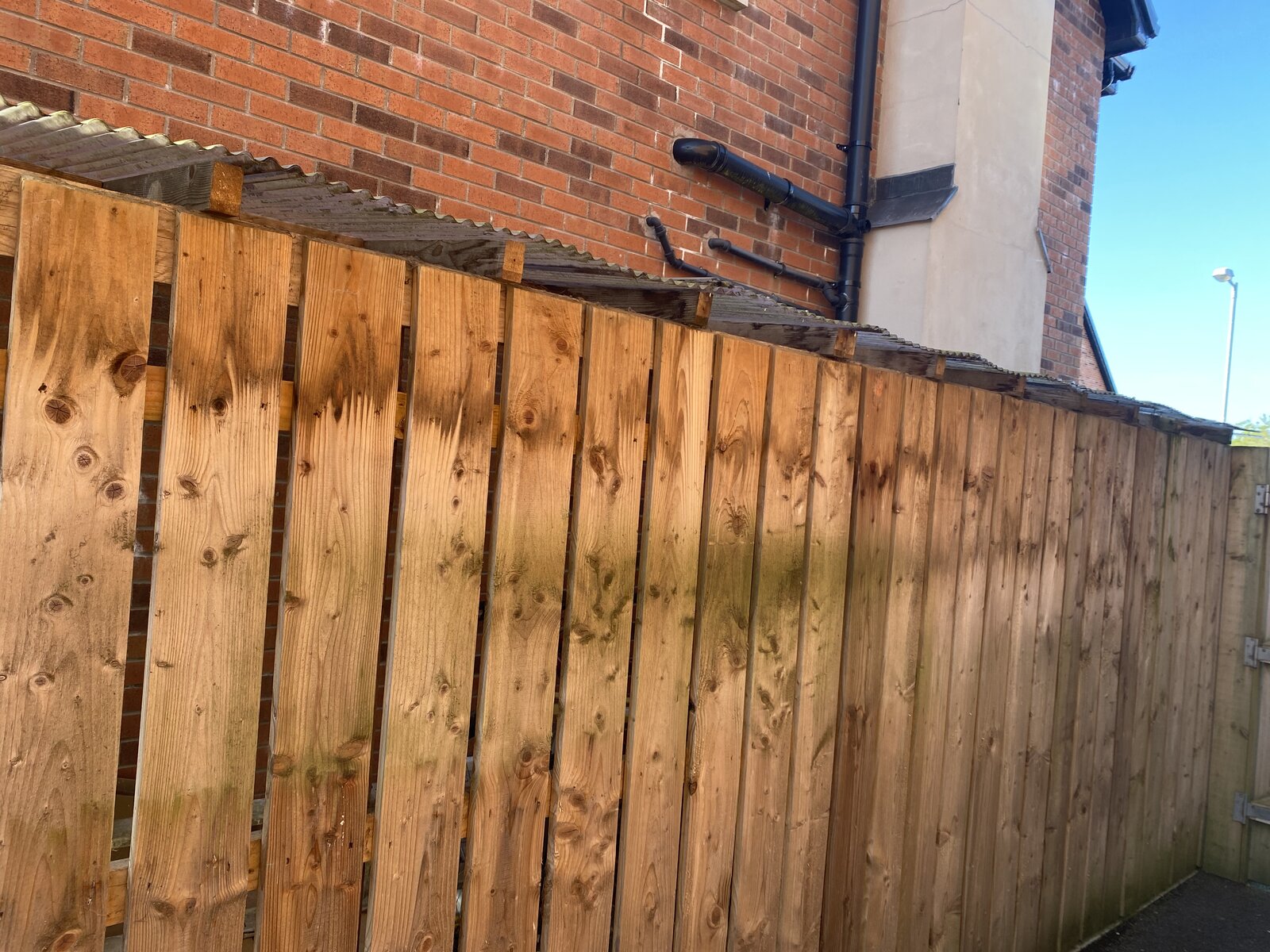

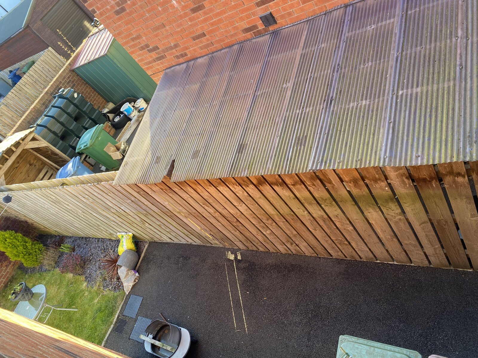

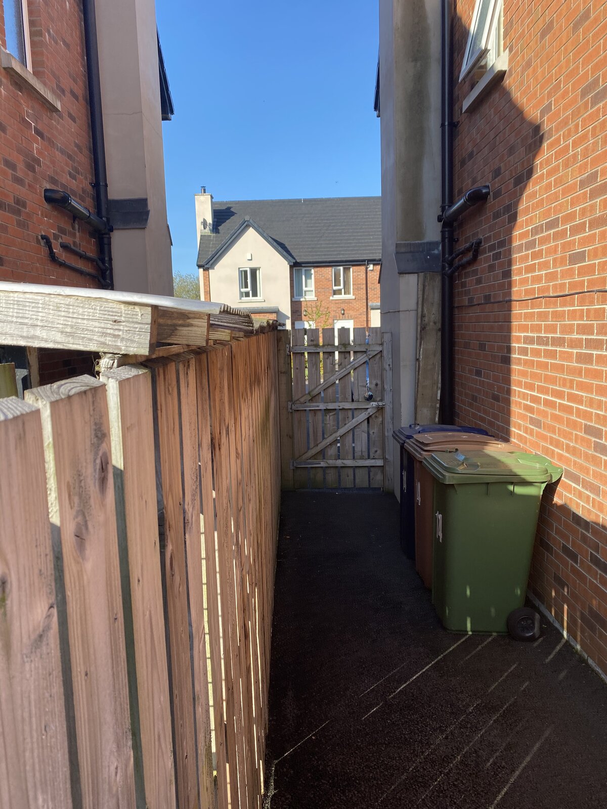

Just after some advice. My neighbour has a lean to that is supported by and crosses my fence area!
Prior to the pandemic, I have approached him and asked him nicely to remove it, I have explained that the runoff from the side of the house in particularly wet weather is leaving our area saturated and overwhelming the drains. I have also explained that it is damaging our fence etc. He acknowledged it was there, gave me a friendly ‘ok’ and then did nothing whatsoever to rectify this.
Now however over time there are strips coming loose, bits of wood and corrugated plastic fall into my garden. This year we are having a landscaper in as we have not long welcomed our first baby and I’m keen to have a nice area for him to toddle about in!
It’s not even worth my while currently painting the fence or anything because the runoff will just ruin it! As seen in the photos.

Hi tiger cub rider! I’m not sure - I had sort of assumed it was. These were new build houses and the fencing was provided by the builder. The photographed area is between the two tarmac areas. At the bottom part of the garden, where the grass would be, there are two fences sort of back to back with the post supports in between, so one facing into my garden, and the other into his and then this single fence, runs right from the fence facing into my side up to the gates.

Looking at your 'photos I see there is a boundary marker in the ground underneath the fence, the white concrete kerb strip. The fence appears to be directly above that with the 'good' side facing you - in my book that means it's your neighbours fence.
The water coming off the roof is shortening the life of the facing boarding.
Now lets talk about the corrugated roof he has. The sheeting is NOT properly supported as each sheet should be fixed at every third ridge to at least 3 purlins (crossrails running the length of the roof; 1 about 3inchs from the bottom, 1 on or close to the wall and 1 central to the other 2 unless that span is 3 feet or less with plastic sheeting). As it is it will breakup sooner rather than later.
I'd suggest that you meet him halfway; allow him to put a gutter up on your side provided he drains the gutter onto his side. Get that agreement in writing, counter signed by a solicitor, the original lodged with your deeds and you both keep copies to hand.

I'm going to reply to my own posting for continuity. Looking at your final posting which you posted as I was writing the above it's pretty clear he has put additional boards on his, reverse, side of the fence as he or his other half didn't like the look. From what he's done he could support the joists on his side of the fence and then cut back the joists and the sheeting so that he can fit a gutter over the gap between the leaves of the fence and then drain it to his side.
