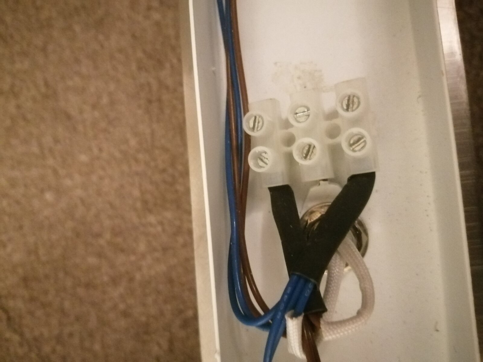

I've uploaded two pics, the second one shows the connections inside my kitchen light

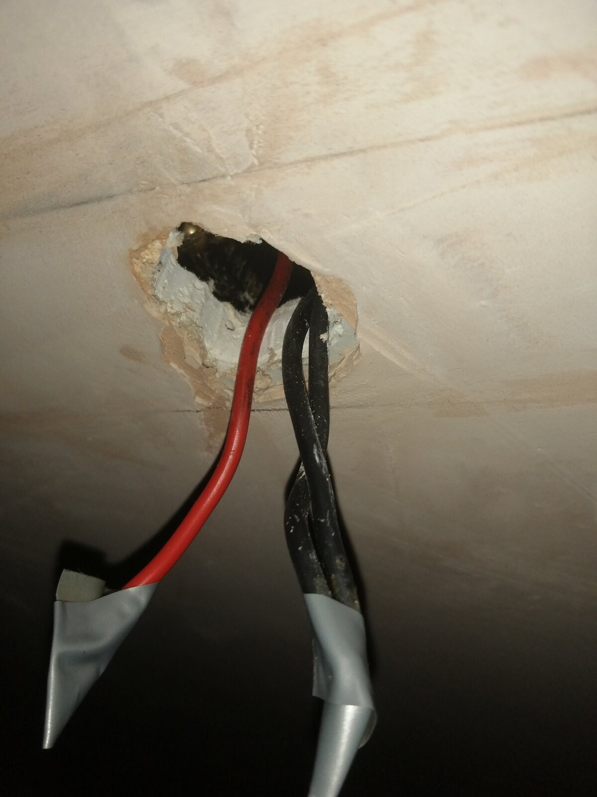

Can you take a picture inside the ceiling void (i.e. turn on flash and put the lens in the hole)? We need to see where the black and red wires enter the white / grey cable sheath.

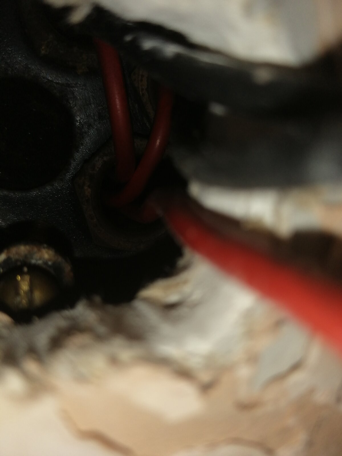

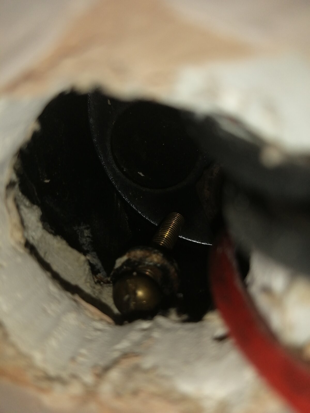

Here are some more photos - best i could get

Looks like a besa box and conduit with single ,unsheathed conductors.
It would need to be checked and tested ,but it could well be earthed.

Your fitting looks like a fluorescent ,strip light ? If it is there appears to be enough black and red wire length to get them into the fitting ,albeit they will not reach its terminal strip.
If so you can put your new terminal block inside the fitting , and run flex from it to the fittings terminal block.
That does not however alter the fact that it is not earthed. That needs an electrician to test the box in the ceiling / conduit is an effective earthing point . If it is ,then it can be used to provide an earth connection to the fitting.
