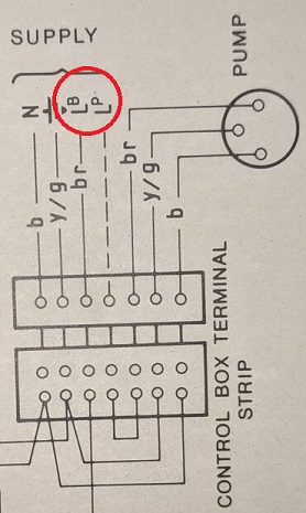

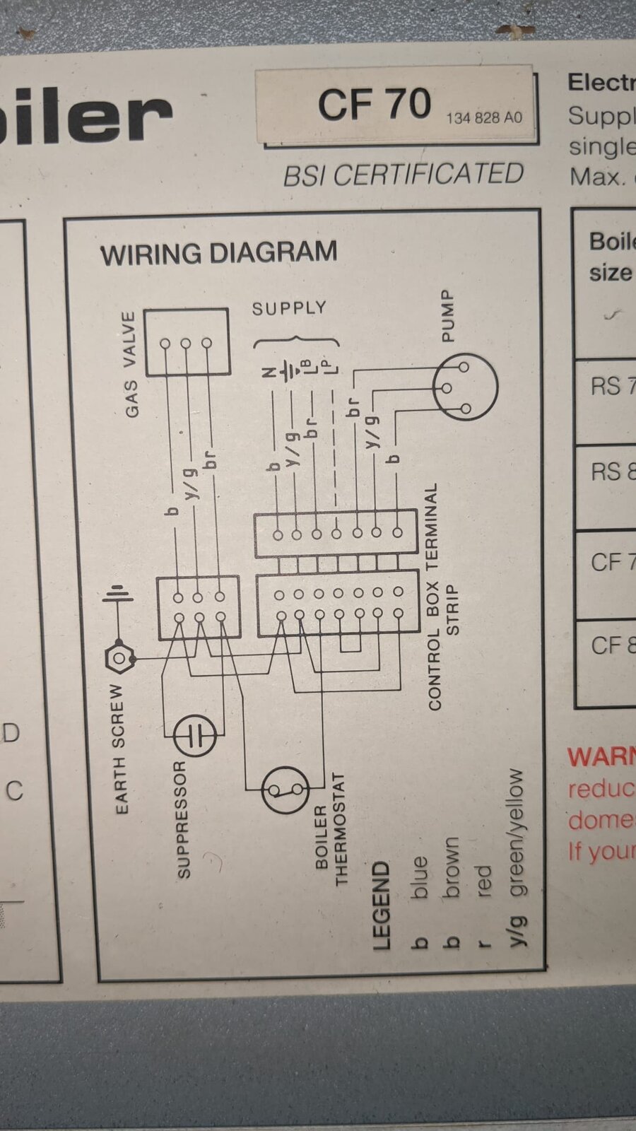

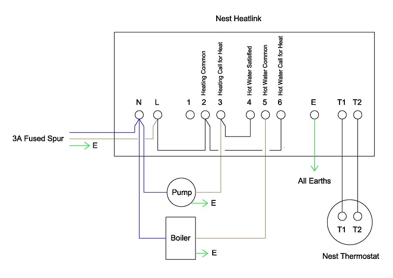

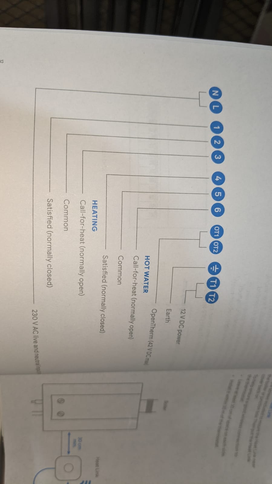

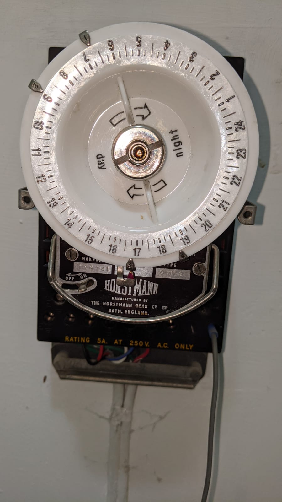

Hi, We have just moved in to an old property with a Ideal Mexico 2 boiler controlled from a Horstmann Potterton controller. The timer function has just stopped working and I thought I could upgrade the potterton controller to a Nest thermostat with heat link. I think the Ideal Mexico 2 is a Gravity fed Hotwater system with No cylinder stat and Pumped Central heating.

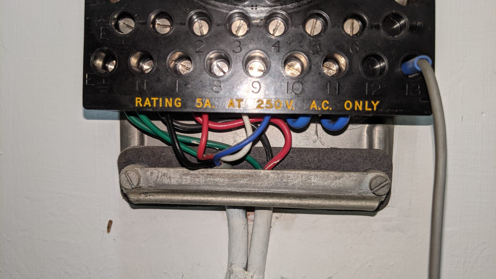

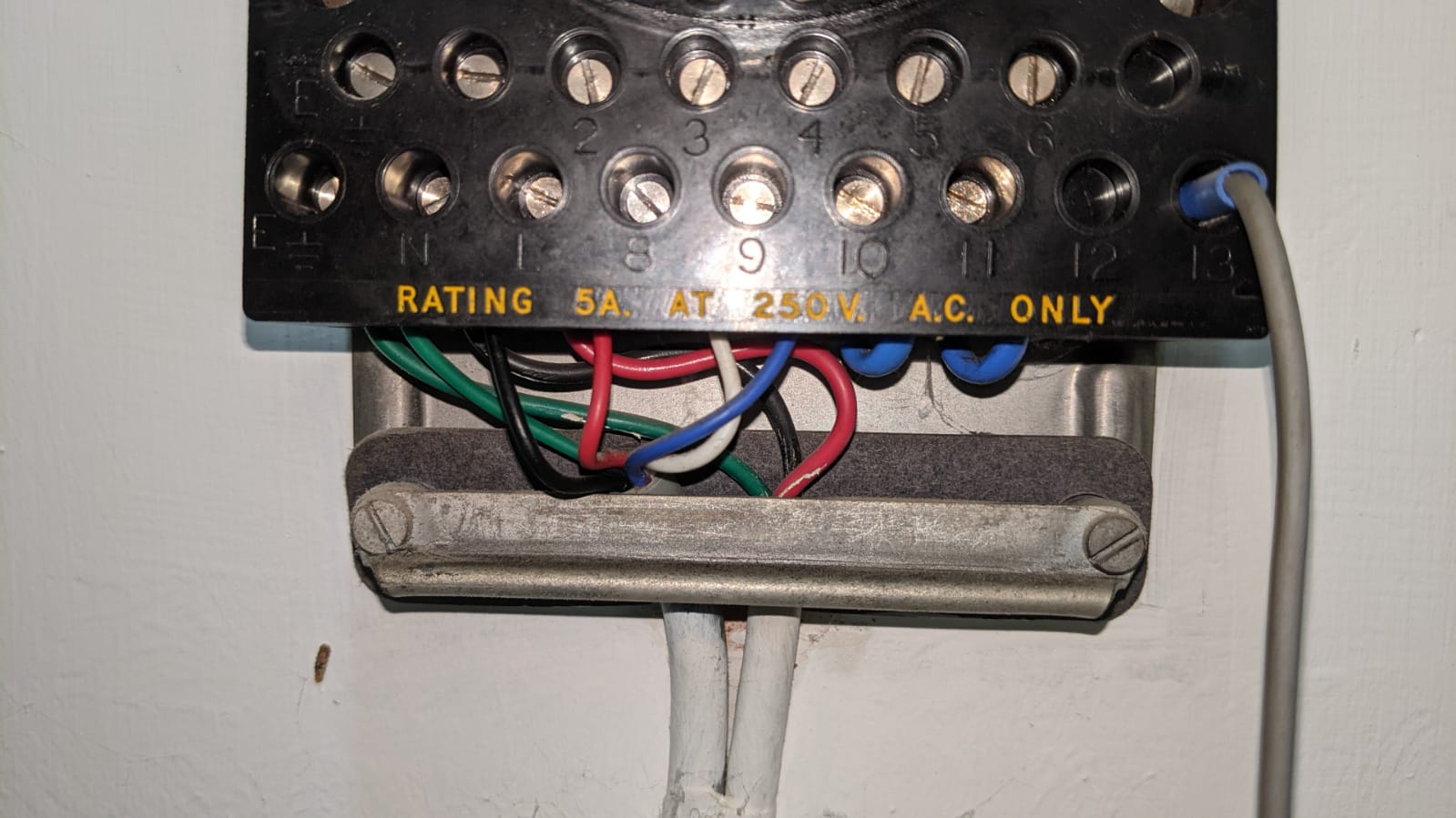

I can see the power goes in on the back row of the potterton, but don't understand the what the
Rating (BLK)
5A. (RED)
AT (WHITE)
250v (BLUE)
would get mapped to on the Nest.
Thanks for you help in advance.
G
Rating (BLK)
5A. (RED)
AT (WHITE)
250v (BLUE)
G
