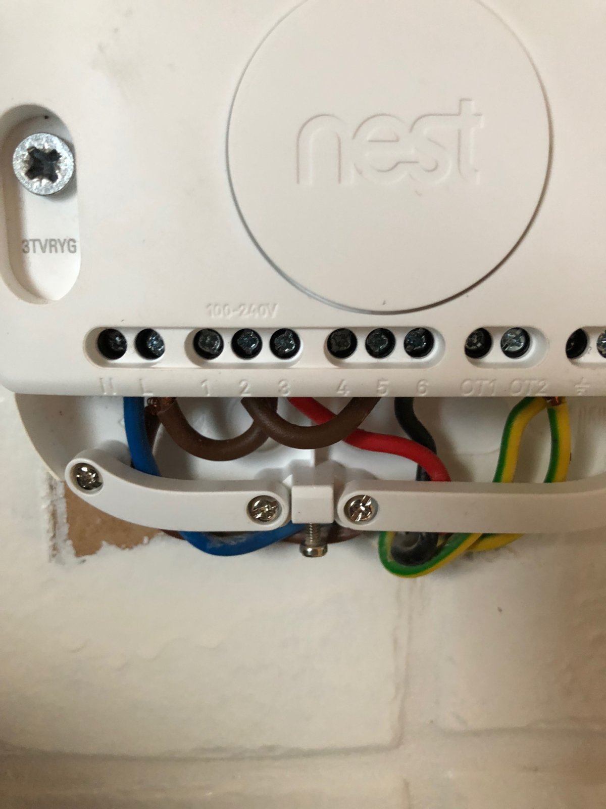

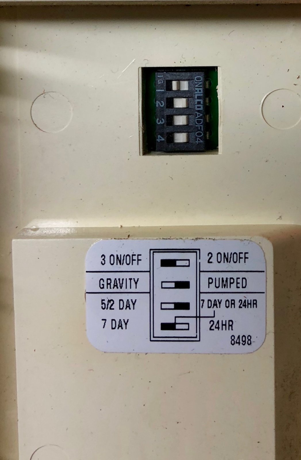

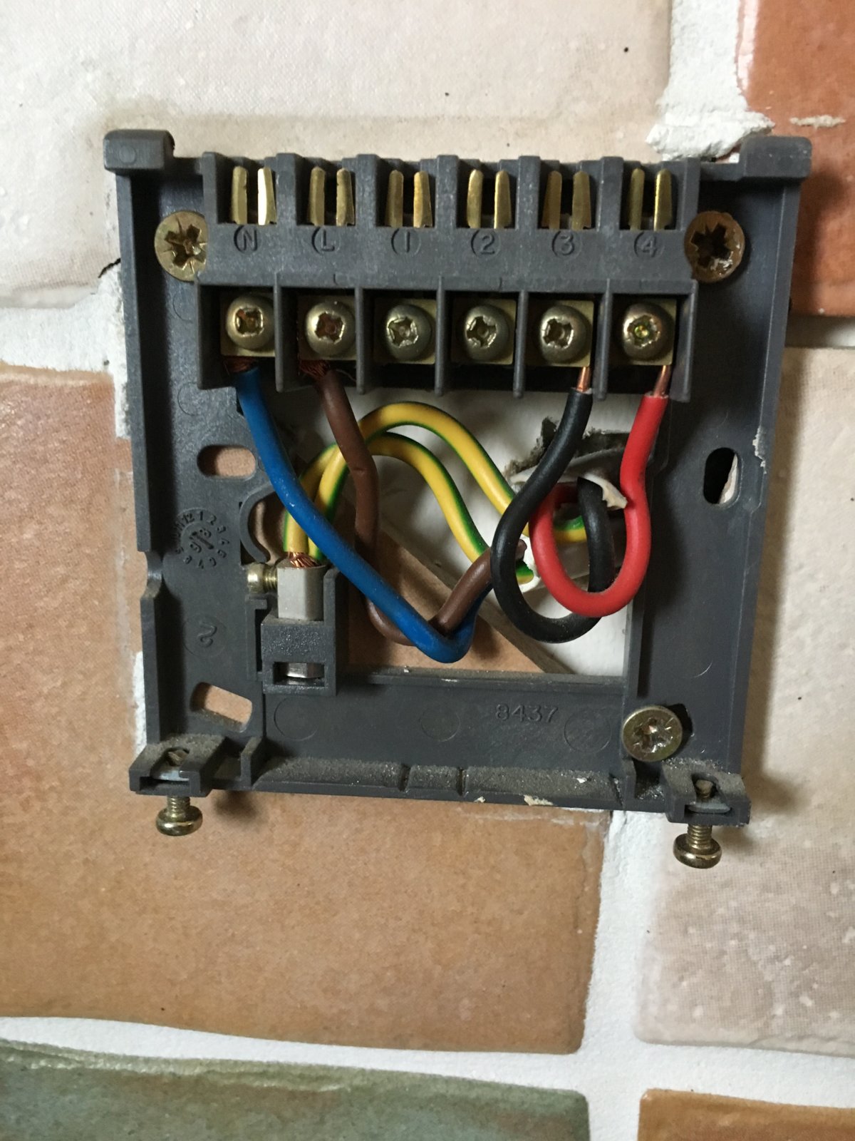

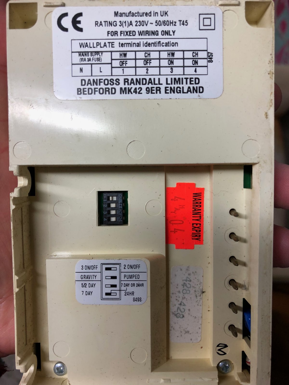

I know there is many a thread on this sort of thing but the issue i am having is a strange one so i wanted to double check what I have done. I replaced my danfloss programmer with a nest about 6 months ago. It works as expected so programs, call for heat and water all work perfectly. It does fire tho for 3 minutes twice every hour without us calling for anything. The boiler is in the kitchen and the megaflo is in the airing cupboard so i know its not frost protection kicking in. It has made me want to double check my wiring before i look at the zone valve.
Please find below the original wiring and what i have wired in.
Thanks in advance to anyone who can give it a once over :)

You have swapped them over so that the wiring is 'like for like' in that what you have now with the Nest, replicates what you had before. I can't really say more than that without knowing what's connected to the other end of each of the wires. However, what you have done to swap them over, is exactly what I would have done.
I can't determine which position the switches are set to on the original programmer though, but I can't see how that would cause the symptoms you describe. Most of them relate to the programmer functions so are irrelevant in this instance, the only one that could have an effect is the 'pumped / gravity' switch but from your reference to the Megaflow and the wiring photos, I would expect that you have two port motorised valves that control the heating and hot water and so it would have been set to 'pumped' which is what the Nest needs. [A gravity system with a Nest is a bit complicated]

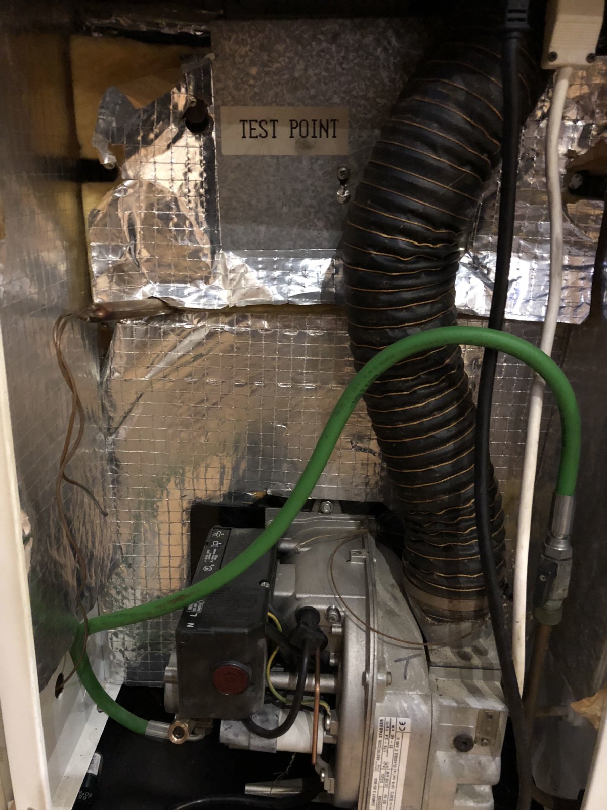

Thanks for the sanity check. I was pretty sure the wiring was the right way as the system but its great to have a second opinion. In answer to your question the heating and water dont come on when the boiler decides to wake itself up. Just runs for about those three minutes twice an hour and then shuts off. I never hear the pump kick into life. Its almost like its just keeping its storage warm. I checked the boiler manual which is for my Camray 5 that i have and it says:
1:5.9 FROST PROTECTION If there is any danger that your Boiler may freeze up during severe weather conditions, it is recommended that you consult your installer who will be able to advise you on an appropriate course of action, either by installing a frost thermostat or the addition of system anti-freeze

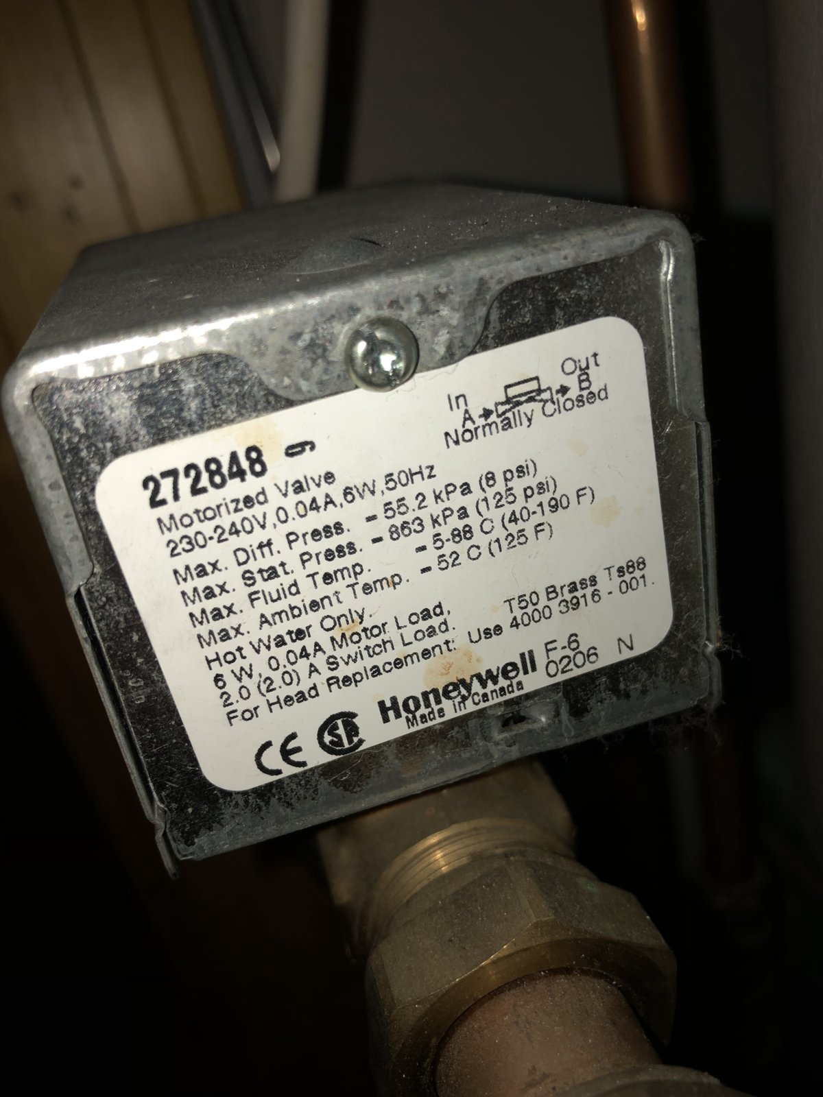

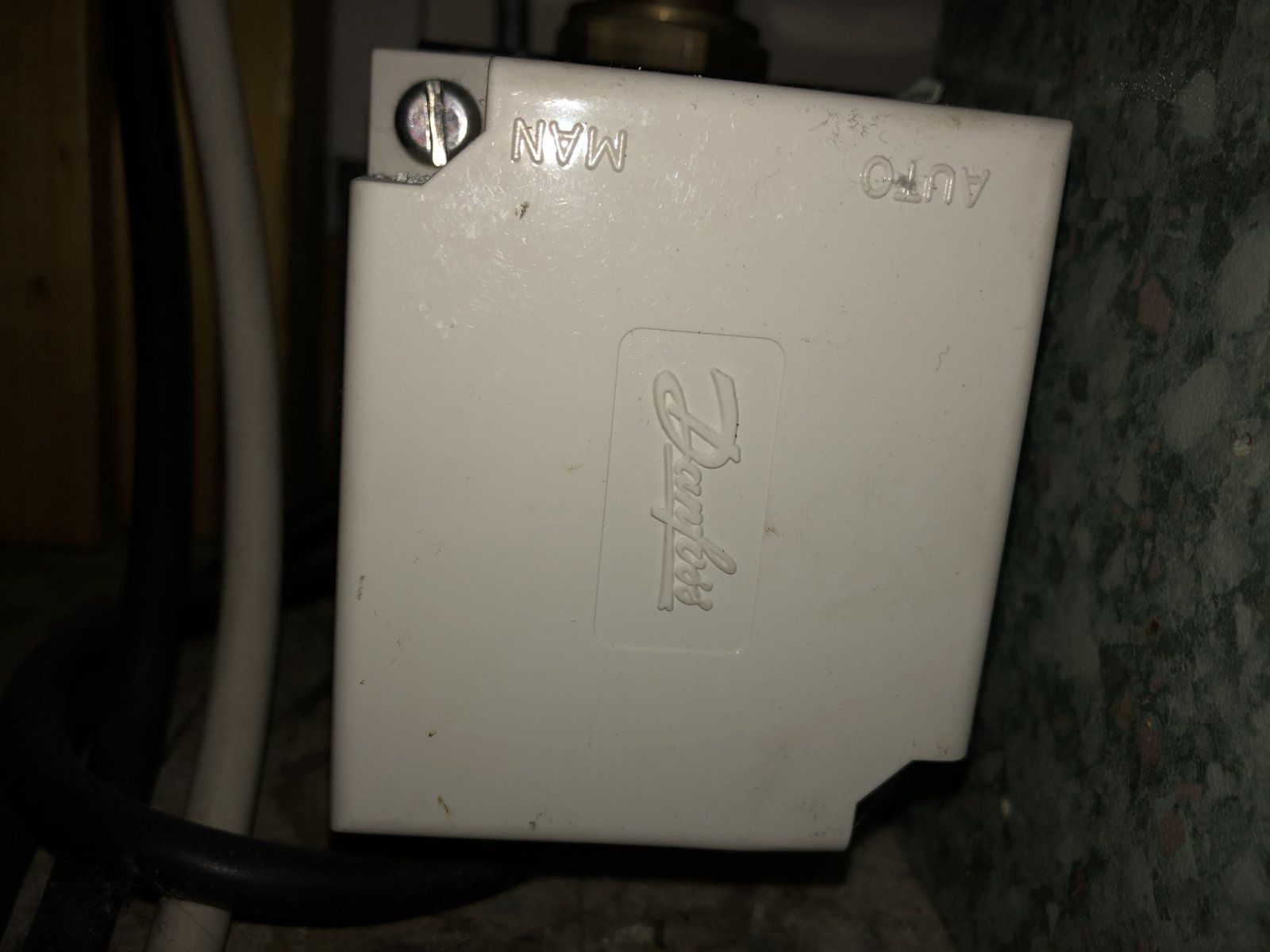

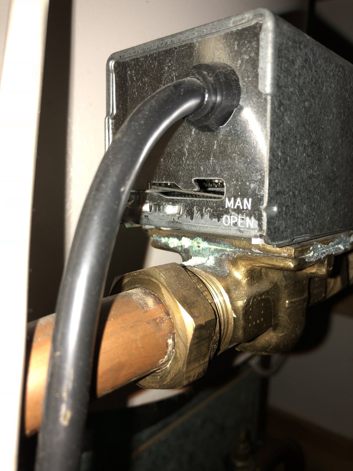

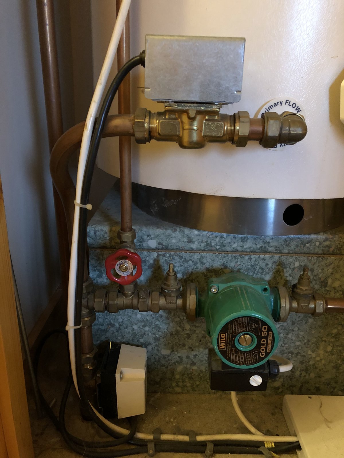

So it looks like it doesnt have a frost stat by default in it and i havent seen one anywhere. I have included a picture of the boiler. I have no idea what that contol stat phail does on the right hand side of the picture but it does have the word stat in it :) Its just sort of hanging in the boiler cavity. I have also included pictures of the megaflo valves. They are always at auto and seem to be working.

I took your advice but sods law could not find my multimeter yesterday so i just went old school with it. I pulled out the CH heat wire from the nest and left it hanging for two hours while i watched the football in the kitchen (good excuse ;). The boiler never fired once. Screwed it back in and now the boiler isn't calling for heat randomly. My best guess is that it was somehow touching the live wire beside it and completing the circuit and therefore calling for heat all the time. Going to leave it for a couple of days but fingers crossed that's it. I have also ordered a new motor capacitor as i think that is what is causing my random lockouts. The future is looking brighter :) Thanks to all that took the time to look and reply.
