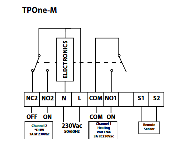

I appreciate you're going down a different route now, but to get back to the programmer, Danfoss confirm that the 975 is no longer available. They do a TPOne-M, which for some reason has volt-free on the CH side, but not the HW. That would still be suitable, as volt-free is not needed on HW for the Vitodens data sheet.

The boiler needed extra pipework for PDHW because that's how the boiler is designed. I'd have thought it far simpler to put an OpenTherm system boiler in, keep all existing pipework and swap the Y plan for S plan using EPH OT controls to achieve PDHW.
Here's an update for anyone interested. I had a Viessmann 050 25kw combi with weather compensation, and an EPH controller connected Open Therm fitted by a local company, glad I went with them, good communication and got the job done. Original installer never got back to me with a quote after I decided to have combi fitted. Really good customer service, and I'm pleased with the outcome. There was minimal disruption, fitted in a day and a half.
