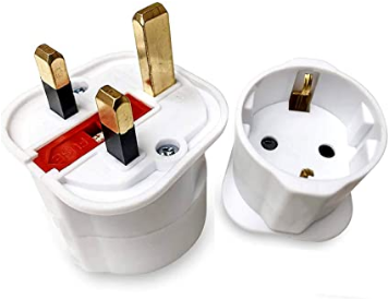

This means had the supplier simply cut the plug off it would have complied as it could be said it is intended to be permanently connected to fixed wiring in the same way as a central heating boiler, or immersion heater.The Plugs and Sockets etc. (Safety) Regulations 1994 said:SCHEDULE 3 EXCLUDED APPLIANCES
7. Any appliance which is intended to be permanently connected to the fixed wiring of the mains system other than by means of a plug and socket.
I am sure current one is the same, we have not been allowed to have Schuko sockets in this country for some time.BS7671:2008 said:553.1.2 Except for SELV or a special circuit from Regulation 553.1.5, every plug and socket-outlet shall be of the non-reversible type. with provision for the connection of a protective conductor.
Personally I would simply cut off the Schuko and replace with 13 amp type. Main reason for the adaptors is so a retailer can fit one without using the services of an electrician. With a Schuko plug all on/off switches need to be double pole, as the neutral and line can be swapped around, and you could be switching the neutral, so although switched off there are live parts.
