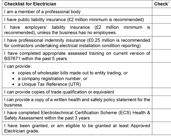

If you see the Scottish Government PRHP site HERE and look for the download on electrics.
