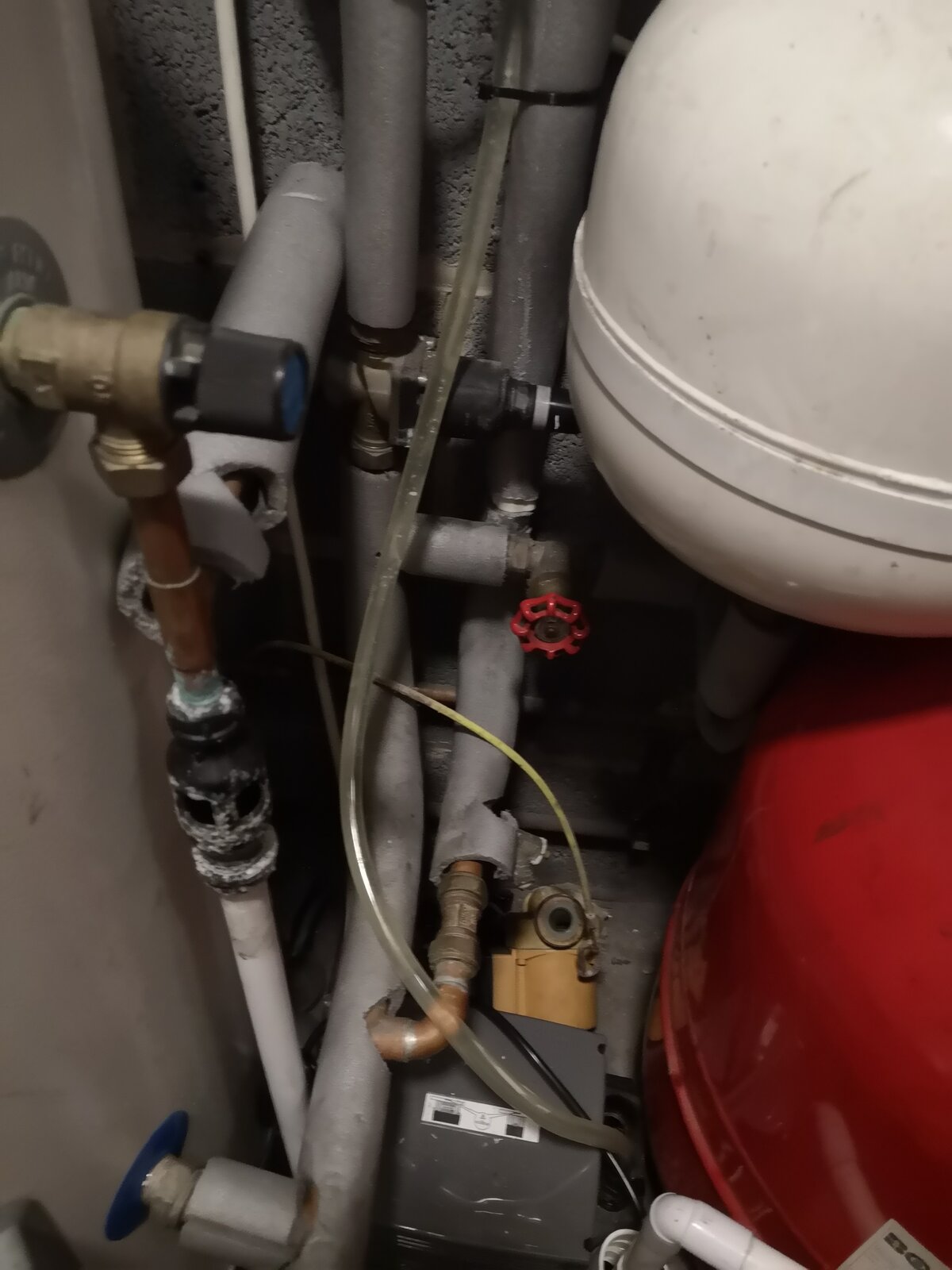

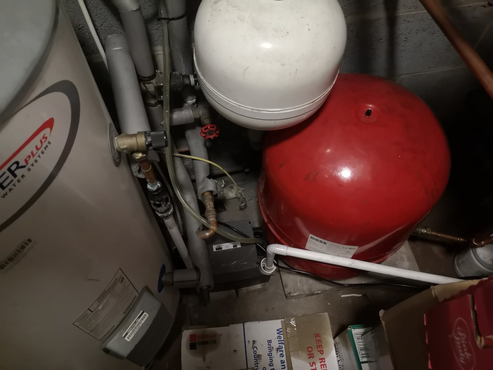

Photos of the installation?

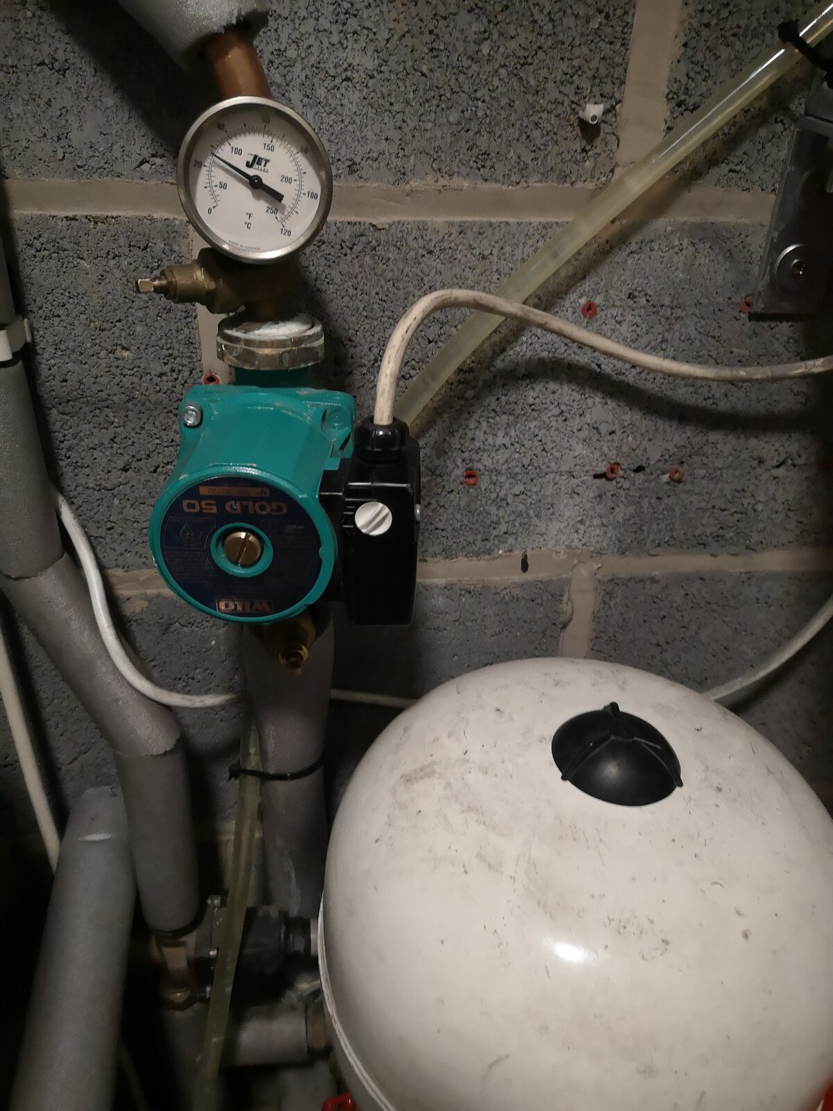

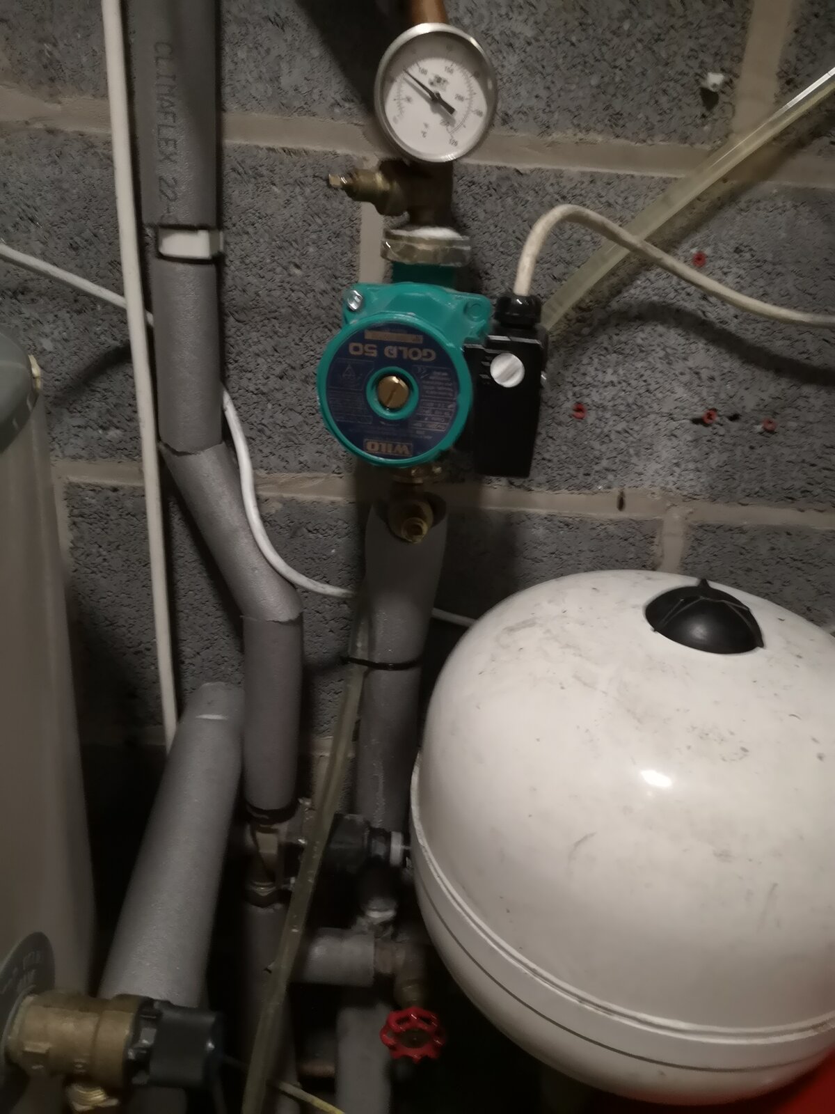

I replaced the normal type gold pump with a more powerful 110 green model which draws water downwards which then
joins the cold inlet at the bottom of the tank. I will take photo's this evening and send in the morning.

You've not provided the requested photos and no amount of trying to describe what you've done is going to help I'm afraid. You also seem to be somewhat confused as you say they have problems with the radiators not heating up, but you've replaced the secondary circulator which has nothing to do with the radiators. I hope you've replaced it with another secondary circulator type and not a standard central heating circulator, which will contaminate the hot water.

The Wilo Gold in the photo is nothing to do with the circulation of the heating system, it's there to circulate hot water around the taps. It's not the correct circulator for the job though - it needs to be one with a bronze or stainless steel body such as the one lying on the floor below it. Can't help with the heating system from these photos, as the only heating system component visible is the expansion vessel which doesn't tell us very much
The white cylinder is an expansion vessel for the hot water system. The hot water system should only be worked on by people with a G3 unvented cylinder qualification.
