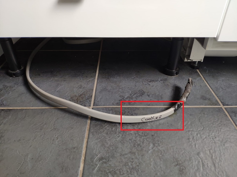

However, I have noticed that in the kitchen, which was recently refurbished, there is a spare cooker switch, with a spare cable all connected to a dedicated fuse in the electrical panel.
The spare switch:
The spare cable under the oven:

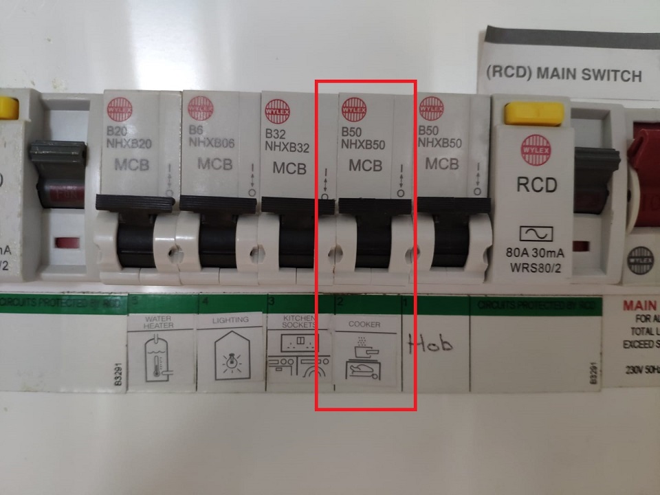

Control Panel:
Do you think it would be possible to wire a new 16 amp oven to the spare cooker cable and switch?

It's an easy job for an electrician.
It will NOT be covered by any retailer installation service.

From what's been posted so far, the work will involve installing a connection plate at the end of that grey cable (usually in the wall behind the oven), connecting a piece of flex from that plate to the new oven, and changing that 50A MCB in the consumer unit to a 16A or 20A type.
Not necessary to add another circuit breaker anywhere.

I can measure the cable, if you like.
Yes the hob is also connected to a B50 with similar setup...
I think it's a 10.
I measure around 17mm the longer cable side.
Is it OK or will I burn down the building?
why can't we tell?
Because we don't know if its 6 or 10mm ?
I was thinking that the cable might run through thermal insulation - when the 50A MCB might be too big.
If not, it's alright as the oven or shower will not overload a 6mm² cable if they are below 47A.
If it is 10mm² then alright apart from insulation derating it.
