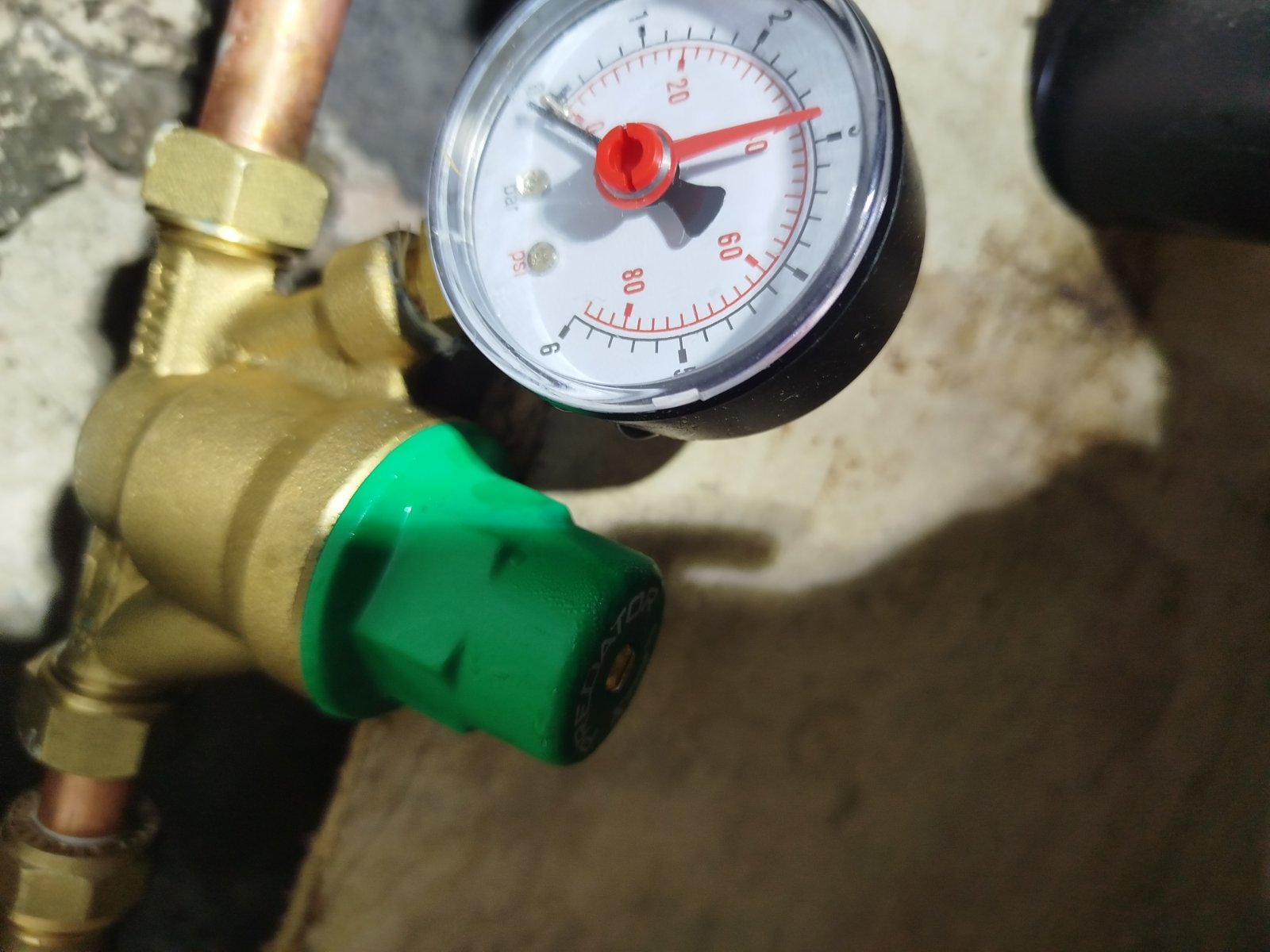

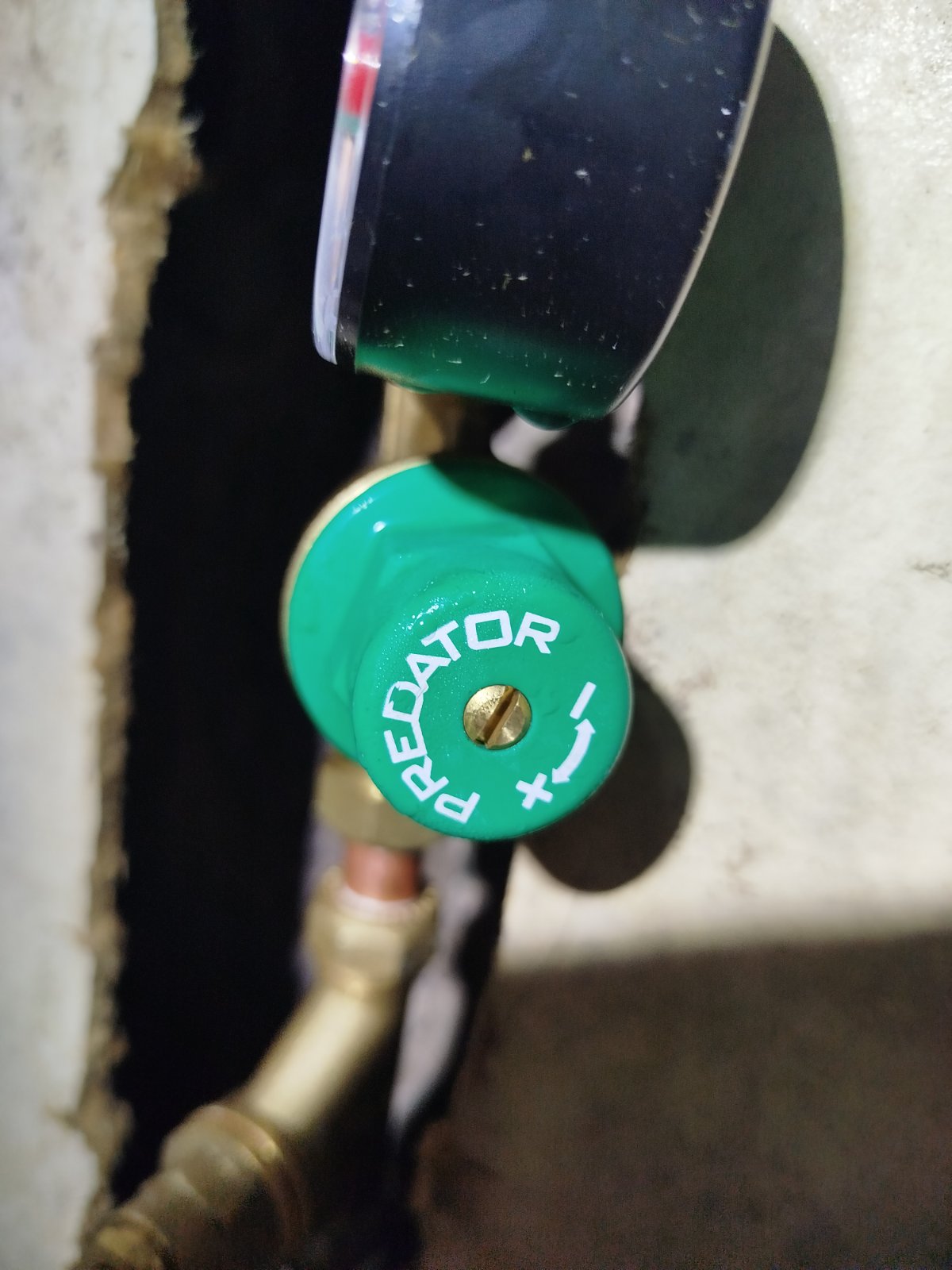

Anyone fit a new pressure reducing valve and the pressure just constantly rises
It will lower the pressure when in use but after using an appliance then pressure dial just keeps rising. So can't set to 3 bar.
That's the valve. Pressure just carries on rising to maximum
Can you just get a very small flow from it and see what pressure does it then show. What pressure is set to. (looks like 3.0bar)
Also the Predator is NOT a drop tight PRV which means the pressure will rise to the full upstream pressure with no demand.

NON Drop Tight PRVs
Caleffi 533
Reliance Predator (PRED800015)
Honeywell D04
Thanks so this pressure reducer don't protect the house from high mains pressure when no appliances are getting used? It will just let the pressure get to the pressure would be anyway without a pressure reducer fitted?
Yes, that's correct, you must install the drop tight type to achieve no flow set point pressure.
Thanks I've just looked online and it suggests the predator is of the drop tight kind. I've fit one before to protect a water heater from 7 bar pressure and it held at 3 bar.
Yes, it does show it as drop tight. Can you check the actual model number, the one I have in my file as being non drop tight is (Reliance Predator) (PRED800015).
Can you remove the down stream pipe and then see if it holds its pressure, if it doesn't then I would contact Reliance for confirmation that it is drop tight and maybe get a replacement one FOC since its obviously faulty?.
Yes it's a Reliance Predator (Pred800015). It doesn't slowly creep to mains pressure it just goes straight to mains pressure when not in use. I'm sure I have fit one of these before to take a 7bar supply down to 3 bar and it held at 3 bar when not in use.
Well, must be faulty then, a bit surprising though, maybe worth looking to see if there's any crap under the valve seat.
It must be faulty. If it is genuinely a drop tight one. It says so on the online literature. I think it's serviceable i.e can replace the valve head instead of the whole body?
Even if there not drop tight ones do they only slowly creep to mains pressure?
Yes, I wouldn't expect them to just shoot up instantly, what I would suggest is to crack open a tap somewhere just enough to reduce/maintain the setpoint and measure the flowrate.
