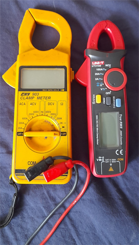

The old clamp on Clamp-meter-small.jpg to left only went to 0.01 amp (10 mA) increments, and never found any leakage with it, the new one to right got so a) 0.001 amp (1 mA) increments and b) measure DC amps, the latter however not really as good as hoped, as slight movement of meter can change the zero point, so not really much good for testing to see if 6 mA leakage DC for the limit of a type A RCD, but better than the old hold in place meter 1727003614202.pngwhich I have used for years with cars. But my new clamp on cost me £35 cheapest I could find with DC and 1 mA increments, but even AC only find a meter with 1 mA increments seems to be hard even expensive clamp on meters often only 10 mA, I do wonder who buys them when one needs another one for earth leakage?

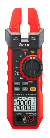

But this one 1727004181015.png£10 from toolstation, but can't find what increments. spec sheet here it will measure up to 200 amp and is auto ranging, but what I want to know is down to amps.

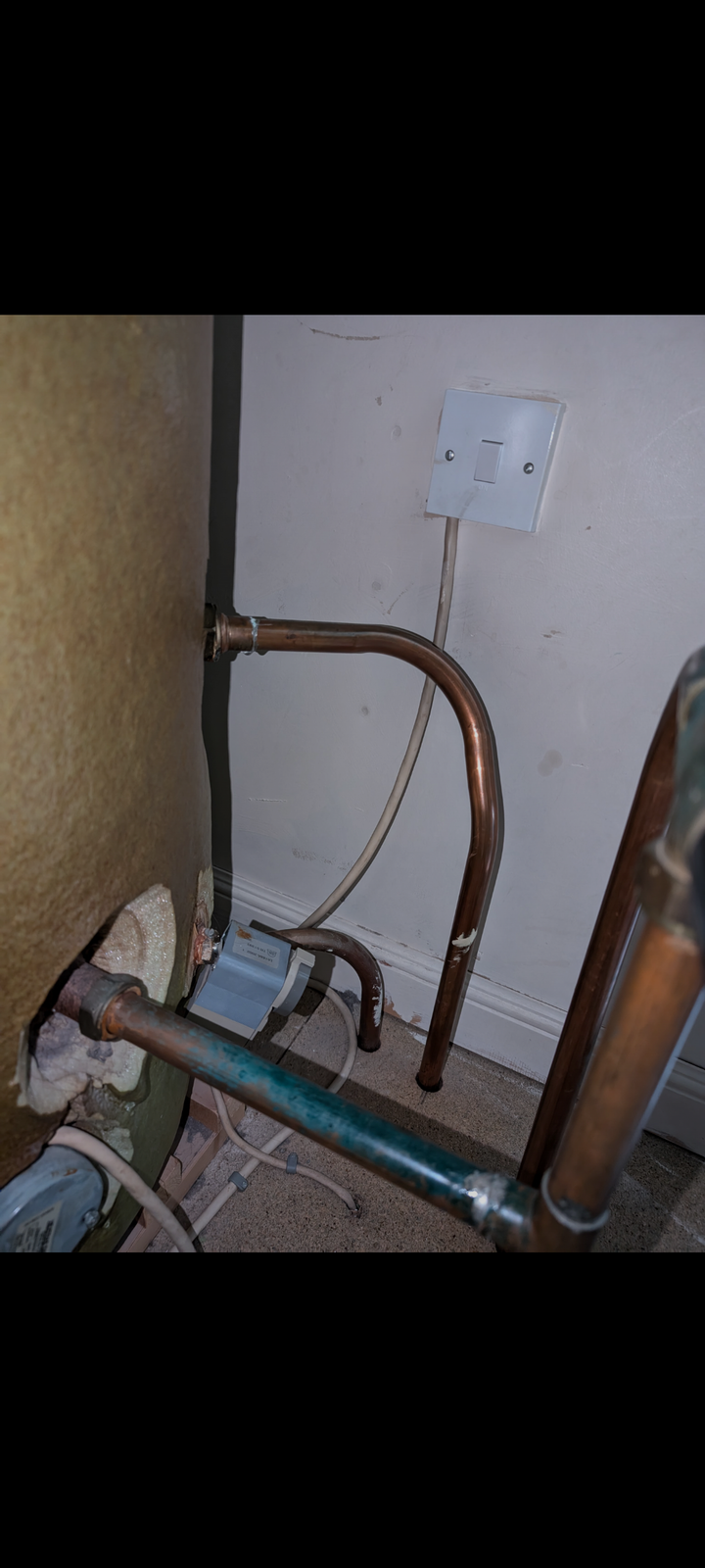

This morning I have checked which circuits are in that half of the board. It's the 2 ring mains, my garage (which has it's own local RCD) and the water heater (immersion tank heater I assume - I don't know much about these, the water tank is heated by the boiler so I assume this electrical heating element is for boost mode only?)
I have also went round and physically unplugged the dishwasher and under counter instant hit water heater, both of these were left by previous owners.
I'm guessing the immersion tank heating element would be a prime suspect here? I've isolated the circuit at the CU but appreciate that for a N-E earth fault this won't do anything

The immersion heater, will be like mine - just installed as a backup, for if/when the boiler fails. Using it, will cost you 3 to four times as much as simply using the gas boiler, to heat it, assuming you don't have an off-peak rate.
