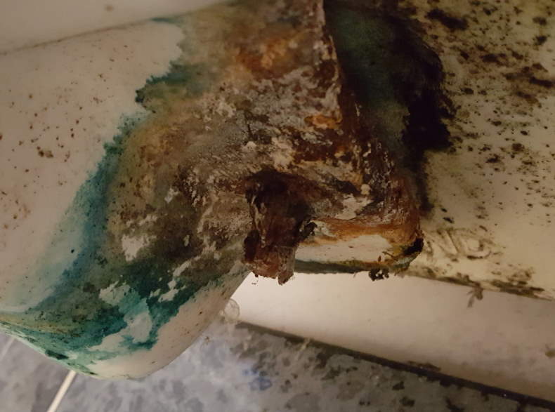

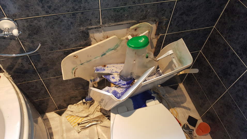

OK, well, that was a bit of a laugh – everything rusted up absolutely solid, cistern to pan fixing bolts just rotating when I tried to unscrew the nuts etc etc etc.
There was no way in the world I was ever going to get the bolts out, so I took a deep breath and pulled the cistern hard. Any doubts about whether I needed to replace it or not because of its being cracked were dispelled when it came to pieces in my hands.
Note to people like me who haven't done this sort of thing before: the pieces of pottery are as sharp as glass, and will shred your fingers if you're not careful. Anybody want to guess if I was careful…
Anyway, one thing I AM good at is breaking things:

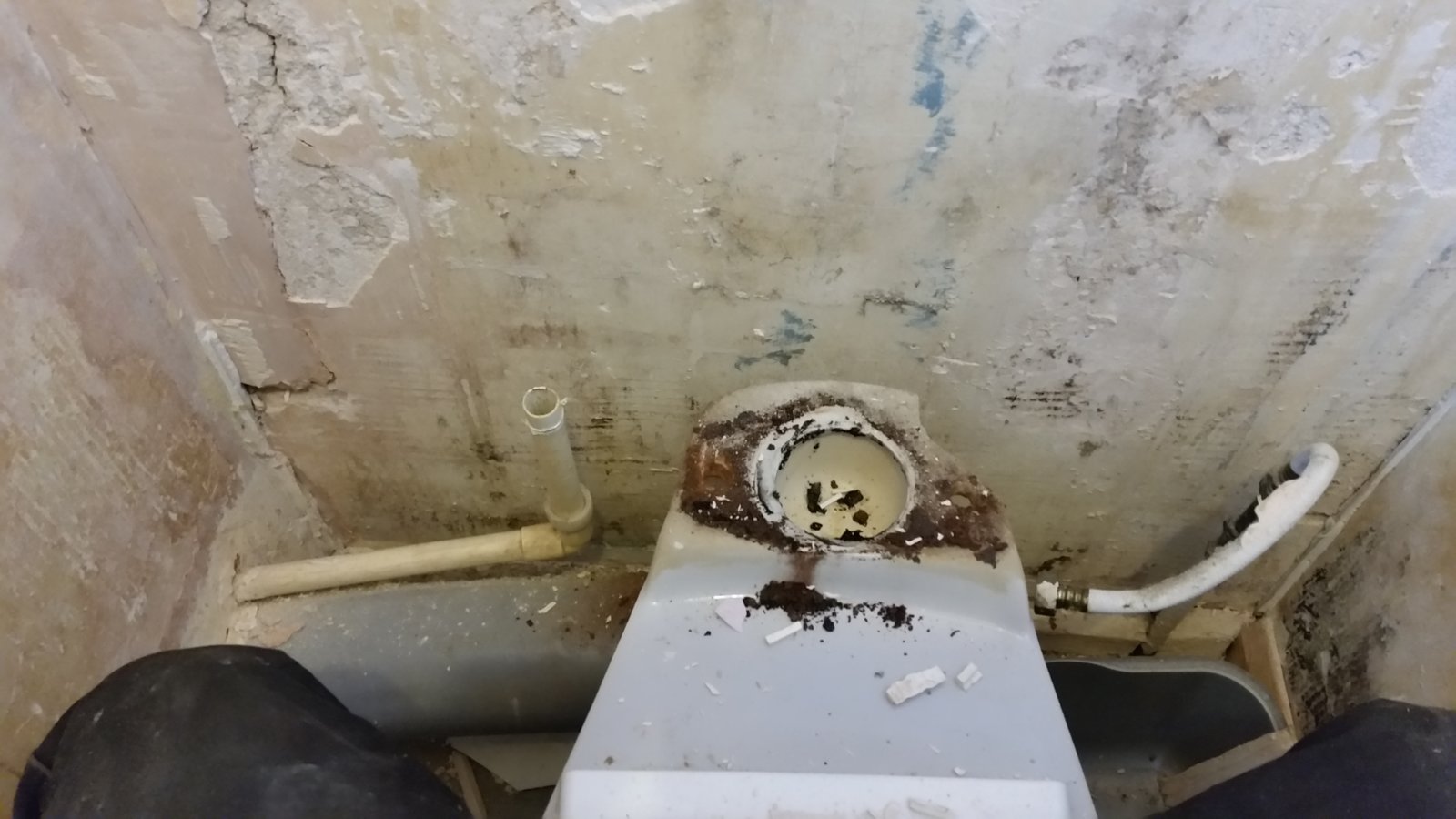

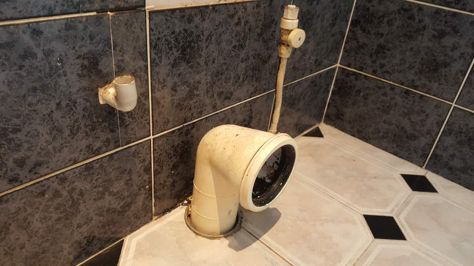

So now all I have to do is fit the new one. Is there any way of me knowing what kind of waste pipe to buy from Screwfix’s bewildering range, to directly replace this one? The new toilet spigot appears to be tapered slightly, but at its end, the outside diameter is 100mm.

Well, I'm going to tackle that next, having... errmmm... uninstalled the old toilet...
Clean it up and reuse it. Your new toilet should push straight onto that and it should be able to be moved up to down in the pipe that’s in the floor.
If you want to change it, try it for size with just the pan fitted and if all okay, pull the connector out of the soil pipe and take it with you to get one exactly the same.
Well, I got one anyway, as it was cheap - but I really did mean that the old seal looks to be in perfect condition, and seems a good fit... Maybe I'll throw a few buckets of water in the pan to see if anything leaks, then just keep the old one if it's OK...
