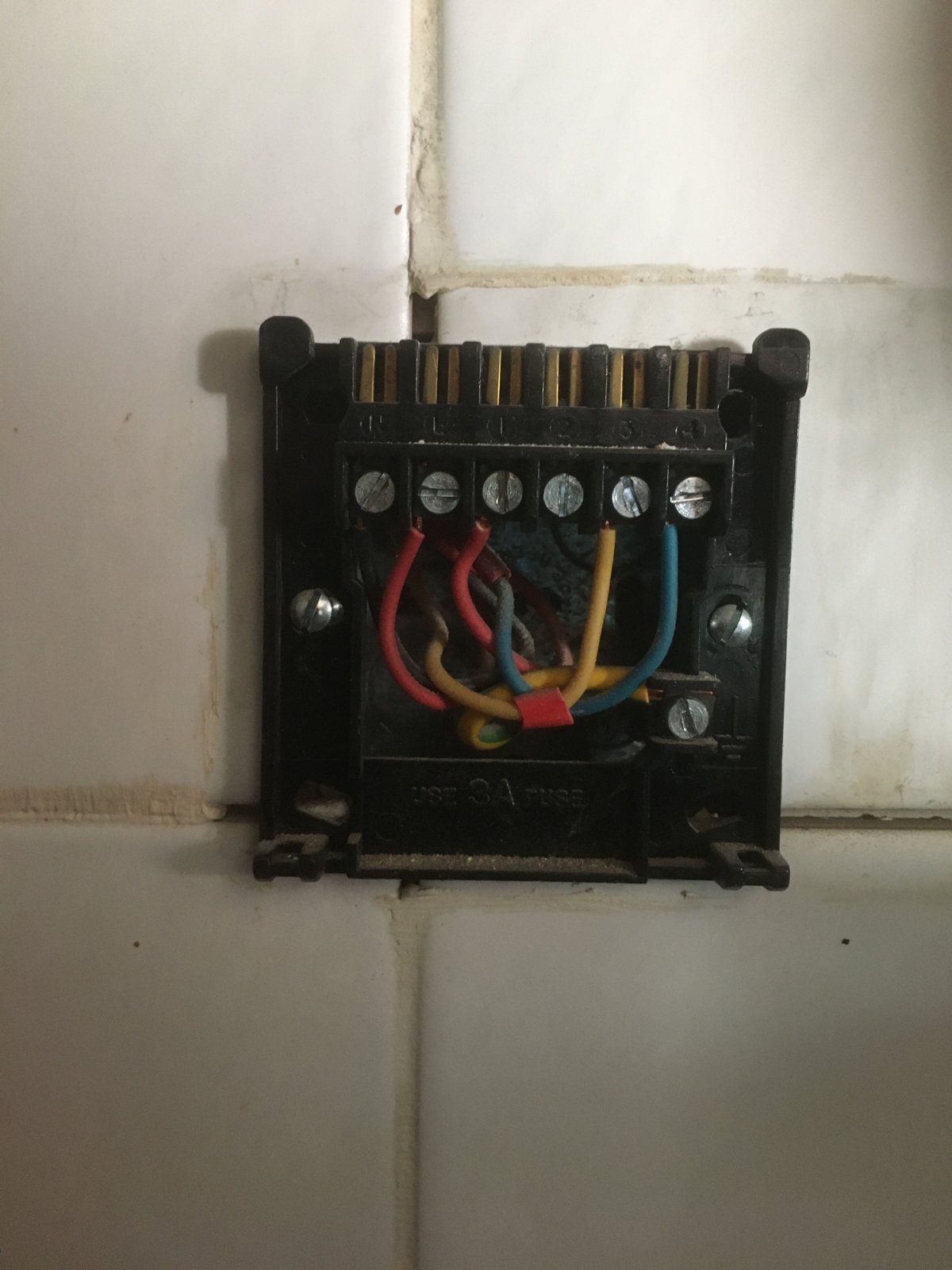

No CH. Changed Synchron Motor. Still Not Working
because you need a HW off signal which is why I asked for a pic of your programmer wiring

Here's the wiring.
FYI, I've just re-checked what I did yesterday. I've had the power off while I took the photo, so the valve went back to the default HW position. I've turned the power back on, CH is set to ON on the programmer, the thermostat is calling for heat but the motor is stuck at the HW position. The voltage being supplied to the motor is 77V.

Have you checked for any loose wiring in wiring centre or at the motor? - you might have a pinched cable at motor connection?
yes it has the HW off wired in, as a test, turn off the power, make a temp link between L,1 &4 on the programmer back plate, turn room thermostat to full, do not put the programmer back on, turn the power on and valve should motor to CH only and boiler should come on
