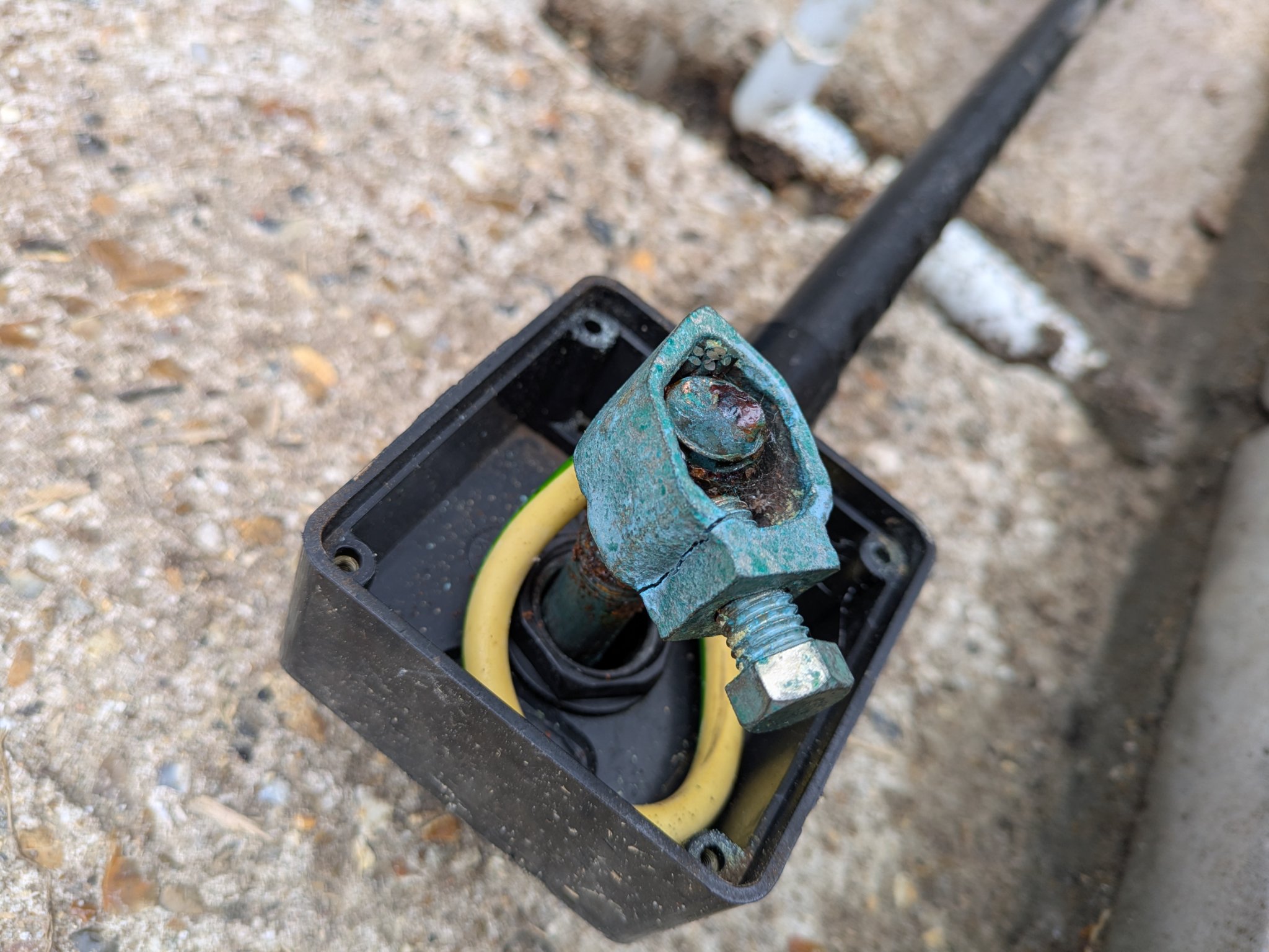

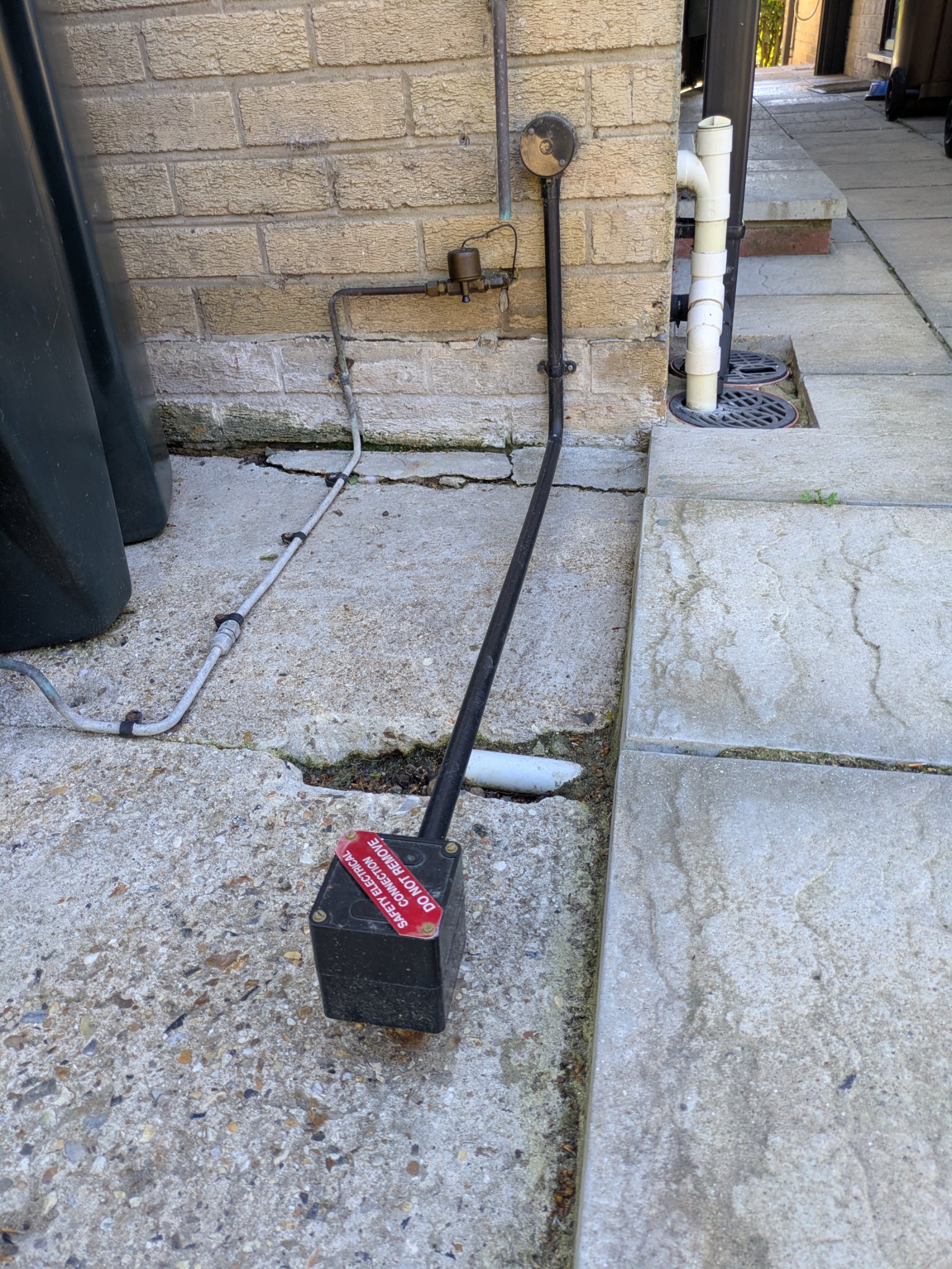

Hi all,
I've failed now three times to get even a quotation out of nearby electricians to do this job.

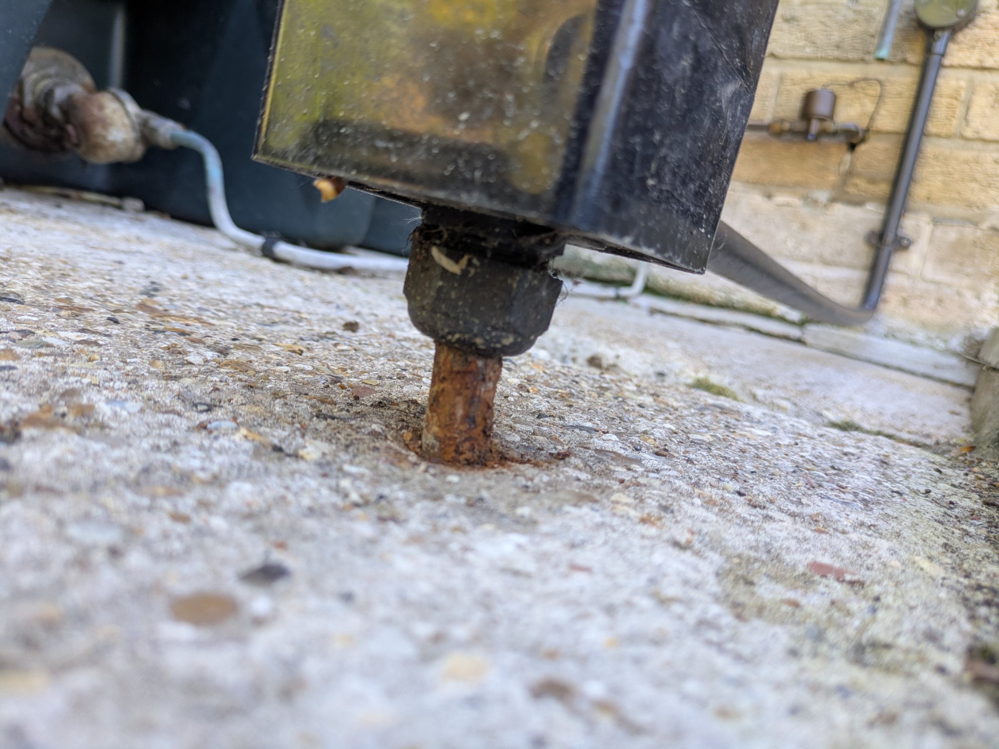

Power comes to my house overhead, and we have a ground earth rod in the back garden. For some reason, years ago, the inspection pit was installed proud of the concrete base that it passes through and the condition is poor in the following ways:
- Rod appears heavily corroded. Perhaps it's fine under the surface rust?
- Clamp cracked
- Whole thing is a bit loose (kids play football out there).
I feel it needs replacing with new one nearby, installed right to ground level ideally with recessed pit. Connected up, and tested.
What am I missing?
If you were being asked to do this job, would you prefer if the home owner had already set the new rod into the ground and just asked you for connection & test?
At the very least, surely a new clamp is needed.
Grateful :-)

1% of that work is electrical. The rest is construction.
It's also going to be a right old malarkey of a job, given:
the concrete and paving all around
the very high likelihood of concealed things underground which will require a survey before anything else is done
the oil tank right next to it with the oil line attached to that very same concrete,
and there is already a joint in the line just waiting to leak.
Book an EICR in they will test it, buy a new clamp and say...
"alright mate I've done you a cup of tea and I've got you some chocolate biscuits" half hour later say " I bought a new clamp as that one looks a bit rubbish, as you seem a great electrician would you mind replacing it for me?
Then give him 20 quid extra. :) (y)
Thanks for your responses - I'm pretty sure the rod needs replacing too, not just the clamp. Perhaps I could drive a new rod in alongside the existing one and just swap it over with a new clamp, then EICR to follow?
Keen not to hit services (although I believe there are none in that area. Hence thinking new rod alongside old rod seems the best spot?
I believe you can get the rod/earth path tested, which is why I think the suggestion of an eicr.
Can't you dig around the rod and remove it?
Then install a new one and get an electrician to connect it.

Would it be legal for me to flip my master switch off, pull the old rod out (might not be easy, granted, I envisage vice grips, water, vibration, maybe a car jack), install a new one in the same place and connect it back up with a new clamp, and then get an EICR as soon as I can find a willing electrician? Or, during the period that the house is relying on my new rod and the EICR taking place, would I be in trouble?
Grateful
Grateful
I would do it as close as possible to the EICR (the day before maybe) just incase theres no decent earth from the rod.
Have you tried to twist/slacken the old one and put a new one in its place?
Basining on the assumption that the existing one had never hit anything untowards!

Well, there is no gas in my area and the mains cables are overhead. Mains water and sewers come and and go out of the property elsewhere. I think my risk of services is therefore limited to drains/gulleys from/under the patio. It's also a bit close the the wall (foundations) but it's only a garage wall, single skin, 1970's build. The current location looks sufficiently far out to avoid footings. Soil type is clay by the way, which Google tells me is favourable for earthing.

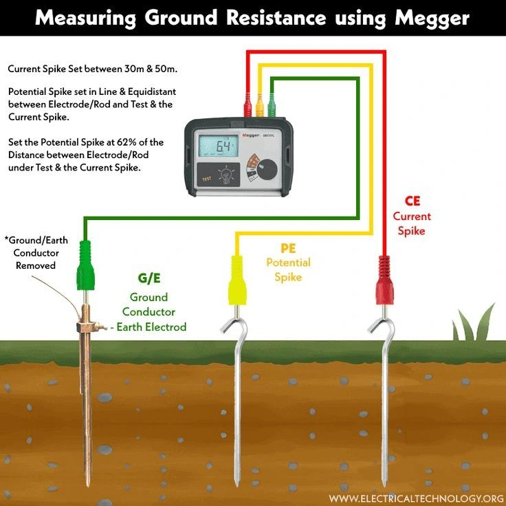

There are two ways to test the dead test is like this 1778151941524.png and the problem is getting the distance away from the main rod for the test probes, it says 30 to 50 meters, often that ends up in someone else's property so are forced to instead do a live test, and compare our earth to the DNOs earth, this is not as accurate as we are adding up the DNOs earth mats resistance, the cables' resistance, and our earth rods resistance, so the reading is on the high side.

However clearly a builder is unlikely to have the meters required for testing, and as a professional the electrician would need to give you proper readings, so would need the earth rod testing kit and the room to use it.

I've seen the box at a silly height before, when it was previously in a flower bed that was later levelled and concrete laid. It would have been better to reposition before laying the concrete.
I think you could cut a new square in the concrete to fit a box. If it was me I would do it round the old one. The spike can be hammered in or driven with rotostop and the concrete patched round the new box afterwards. You could do all that with a cheap SDS+ kit from Screwfux. The Titan is very heavy and primitive but ideal for this job. The guarantee will last much longer than the work.
