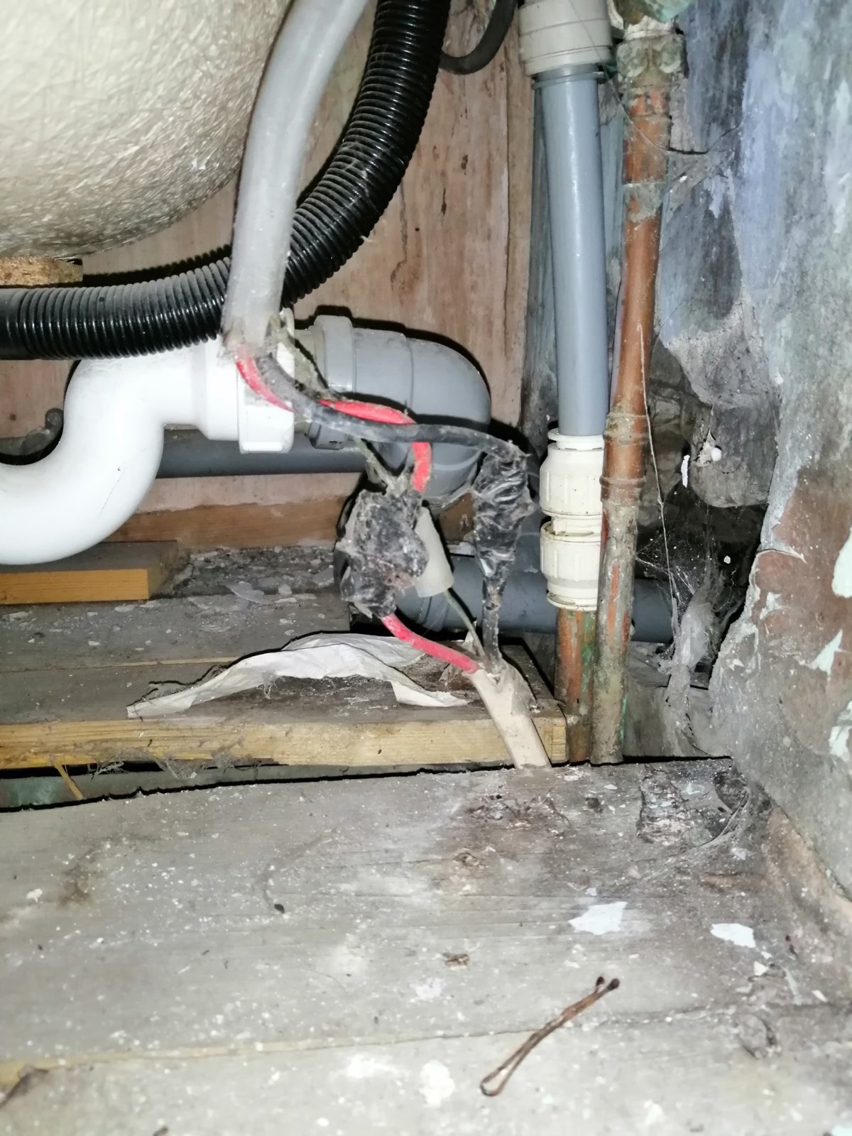

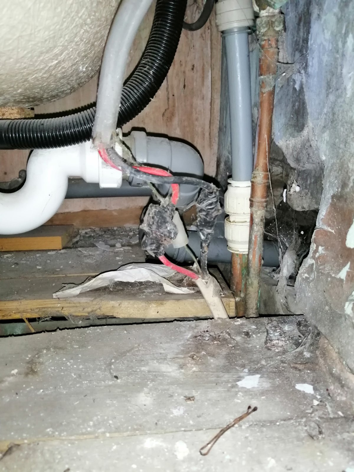

Would this be suffice?

Have you taken voltage readings on the cables under the bath ?
I would use a waterproof junction box ,as its below the bath.
So I pinned into the supply and earth above where its connected and I had no reading, did the same below the connection and I had no reading, now my electrical knowledge and testing knowledge isn't the best but at either side of where I was pinning in I would be making a full circuit so if the fault was above or below I would have had a reading but I had no reading at either side of the connection.
I've found the wiring and it goes straight from the MCU in the little hall way, underneath to the kitchen the straight up the back wall to underneath the bath as I've pushed the wiring up and it's lifted it straight up as you can see in this image to the previous one I posted.
Now is a straight supply/earth/neutral only with a breaker in the circuit a bit cowboy/dangerous?

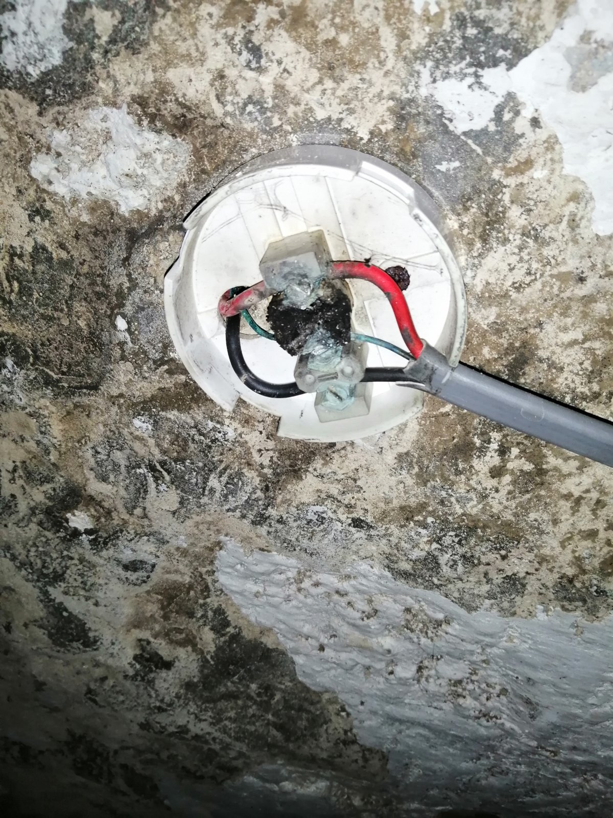

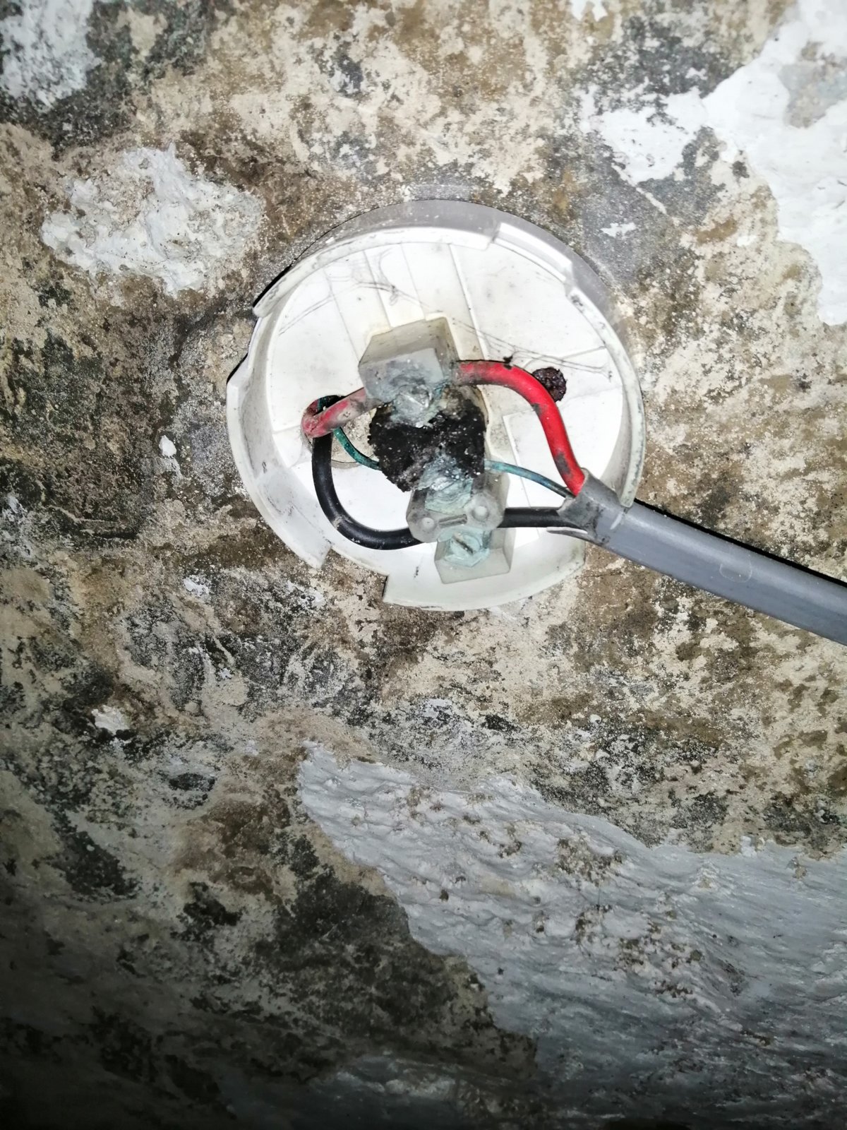

And this is what I'm sure is the other connection which is in the cellar.
I'll test this on both sidea with the breaker on and off to make sure I'm on the right power supply line and if so it may be this at fault.

There is no requirement in the wiring regulations to have a seperate isolation switch on your shower circuit ,either ceiling or wall mounted ,over and above the isolation provided at the consumer unit. Having said that ,one is nearly always fitted.
The way the cable has been " joined together" however ,is another matter !!

You ought to consider re wiring the shower circuit. Without the joins. And get the rest of the installation checked out .

Yeah it looks like that's the only fix, I checked the junction box in the cellar and it has a reading of 240v either side but I've double checked the reading underneath the bath and there's no reading either side so the issue is between where it leaves the cellar and where I can see it running up the wall underneath upstairs floor.

What do you mean by " it has a reading of 240 v either side " ??
If at the cellar jb you measured 240 v ,line to neutral , same line to earth ,
But below bath 0 volts line to neutral ,line to earth. Then there is a break in the cable ,or it is not the same cable !!

I measured across the live and earth before it goes into the junction box and had a reading of 240V then I measured it as it comes out the junction box to cancel out the junction box being at fault.
Which as you've said leaves the wiring at fault as there's no voltage underneath the bath so the break is between the wiring coming through the cellar and entering below the bath.

Is the cellar jb screwed to the ceiling ?
Have you tried to unscrew it and check the cables where they enter what looks like concrete ? Judging by the condition shown in your pic , I think its more likely an issue there ,rather than higher up in the kitchen ,unless you have had work done in kitchen recently.
