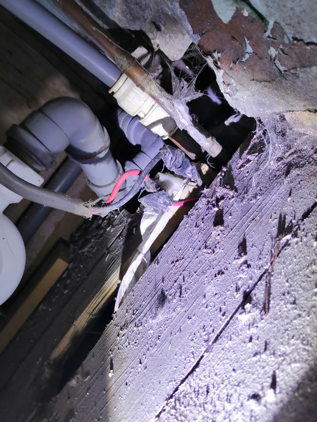

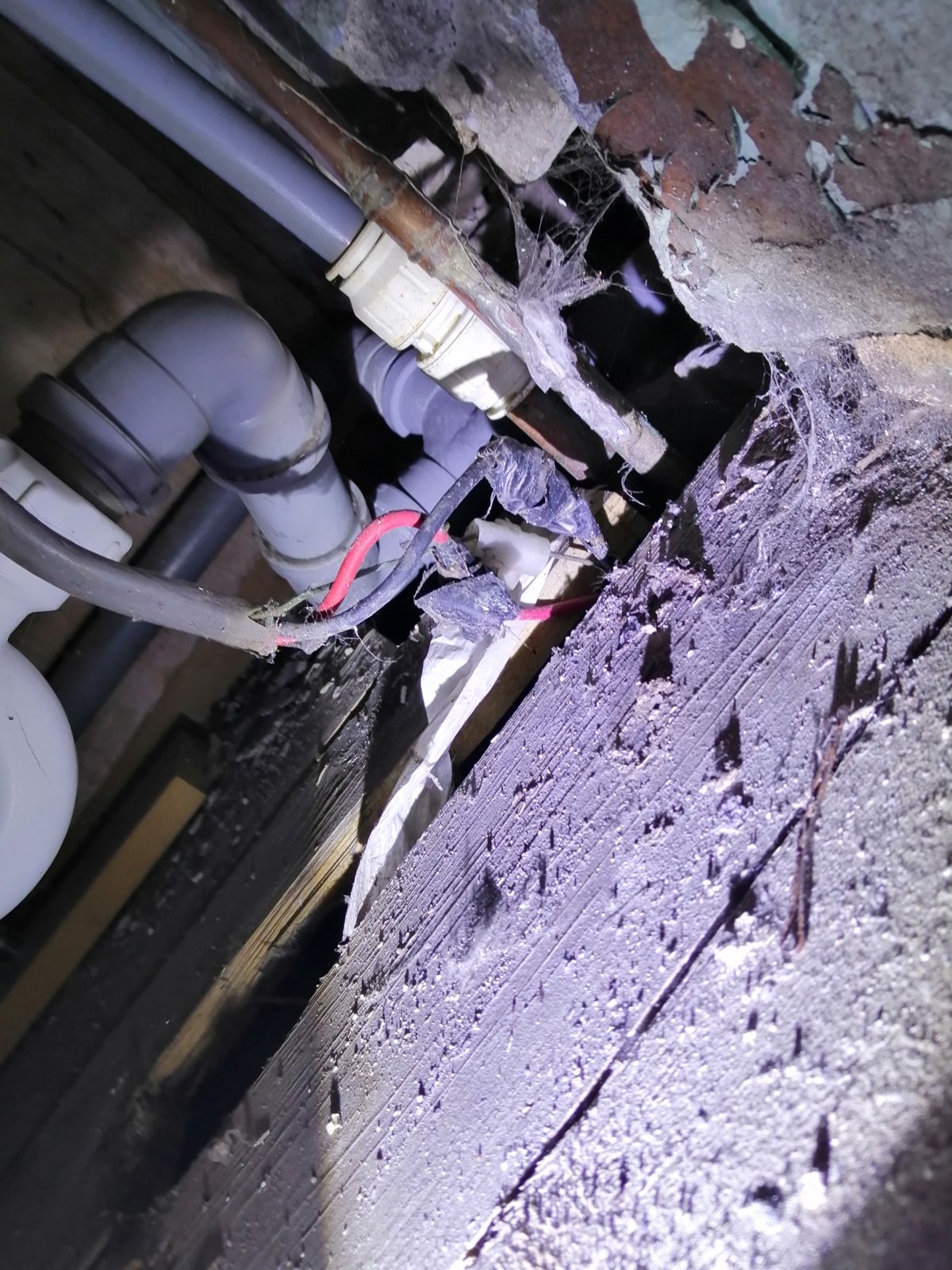

Well I'm underneath the bath, there's no switch or fuse but the earth, neutral and feed seem to be connected here, the earth and feed have insulation tape wrapped around and the neutral is connected with a scotch lock.
I'm from the motor trade and we rarely see jobs this bad anymore, looks like a mate has done this rather than a professional but it could be the norm for all I know but I'm gonna have to test either side of the connection to see if this is my fault but the access is crap!
So I've pinned into either side of where it looks like they're connected and I'm not getting any readings, I've been in the loft and can't see an isolation switch, there's no pull cord isolation switch but everything checked out in the MBU as I've literally just triple checked, switched off all the power and removed the earth and neutral just to check their connections.
Maybe the earth connection is fine as I've checked in the MBU just on the showers earth with the breaker feed and I'm getting a reading, so if I check either side of the supply where its joined underneath the bath that should tell me if the connection is fine but how do I check that with the multimeter?

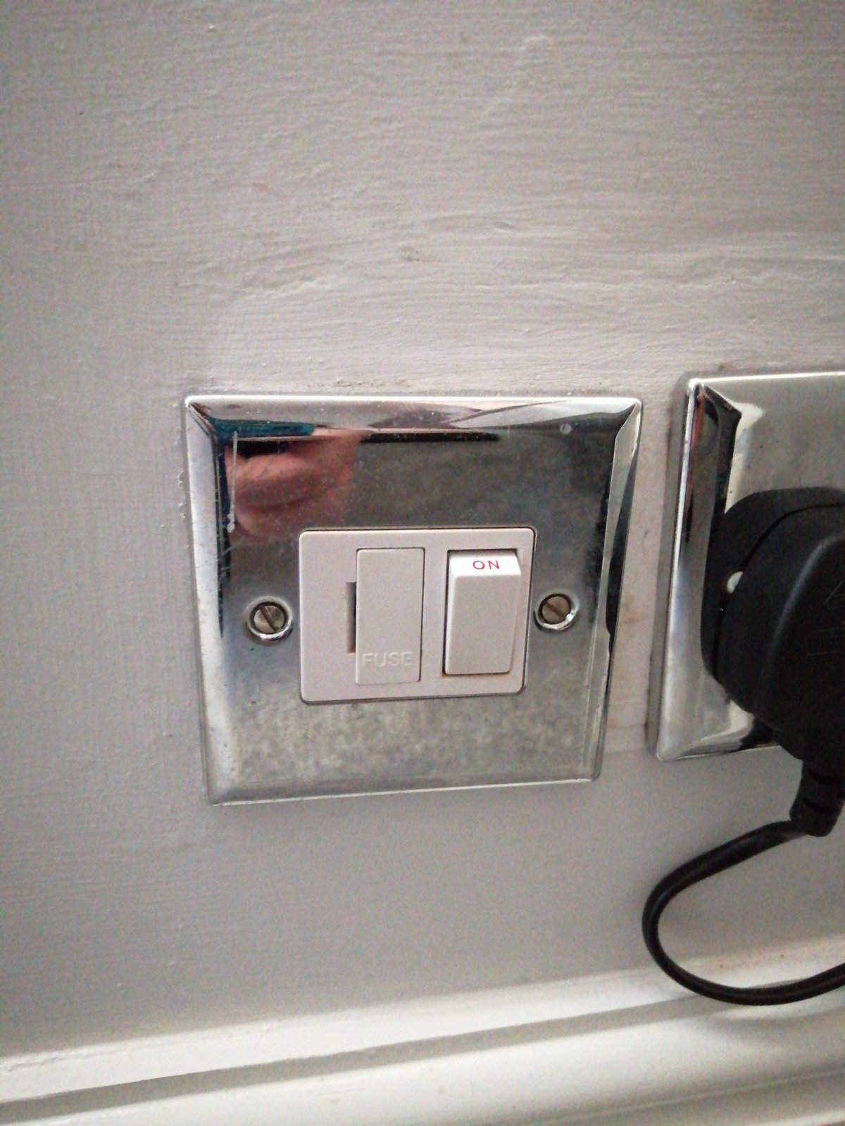

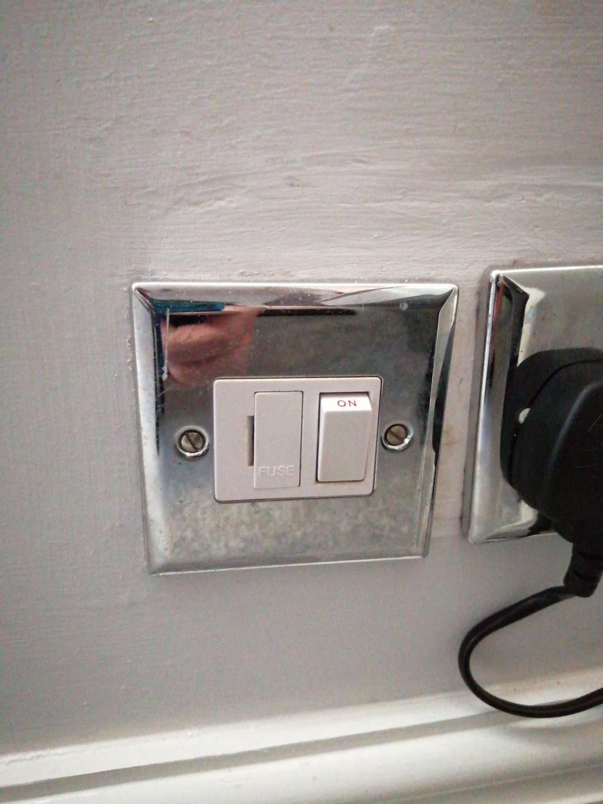

We have this switch but it's only got a 5amp fuse in and I've swapped it.
Does anyone know what it is? It's in our main bedroom.
Its a switched ,fused ,connection unit. Does it feed an outside light ,possibly ?
Certainly not something you would have on an instantaneous electric shower circuit.

You should remake the connections in a suitable junction box ,what you have is a right bodge.
What are you using to test that the line conductor is live ?
Multimeter ? Measure voltage Line to neutral ,and line to earth ?

I agree it's a mess, I'll pick one up from screwfix anything I need to look out for or just any 3 way junction box? I'm using a multimeter just checking voltage across the power and earth line, I've left the neutral out as I should have a reading across those two.
Must be for an old outside light I guess, doesn't seem to switch anything off in the house.
Have you taken voltage readings on the cables under the bath ?
I would use a waterproof junction box ,as its below the bath.
