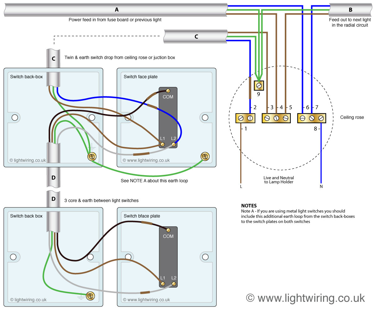

you have both cores 2 & 3 Core
If you ONLY have 2 switches that control 1 load - like a light - then its
2 way switch (3 wire system, new harmonised cable colours)
you can see the wiring diagram here , on the LINK
And you should be able to MATCH that to the wires you have in each switch -
BUT its only showing for 1 circuit - so 2 switches controlling 1 light
Remember in your setup you HAVE 2 GANGS - 2 switches - so you have the circuit twice - BUT the are completely seperate - so just focus on the one 3 core cable - and its associated 2 core cable - for 1
circuit
hope that helps

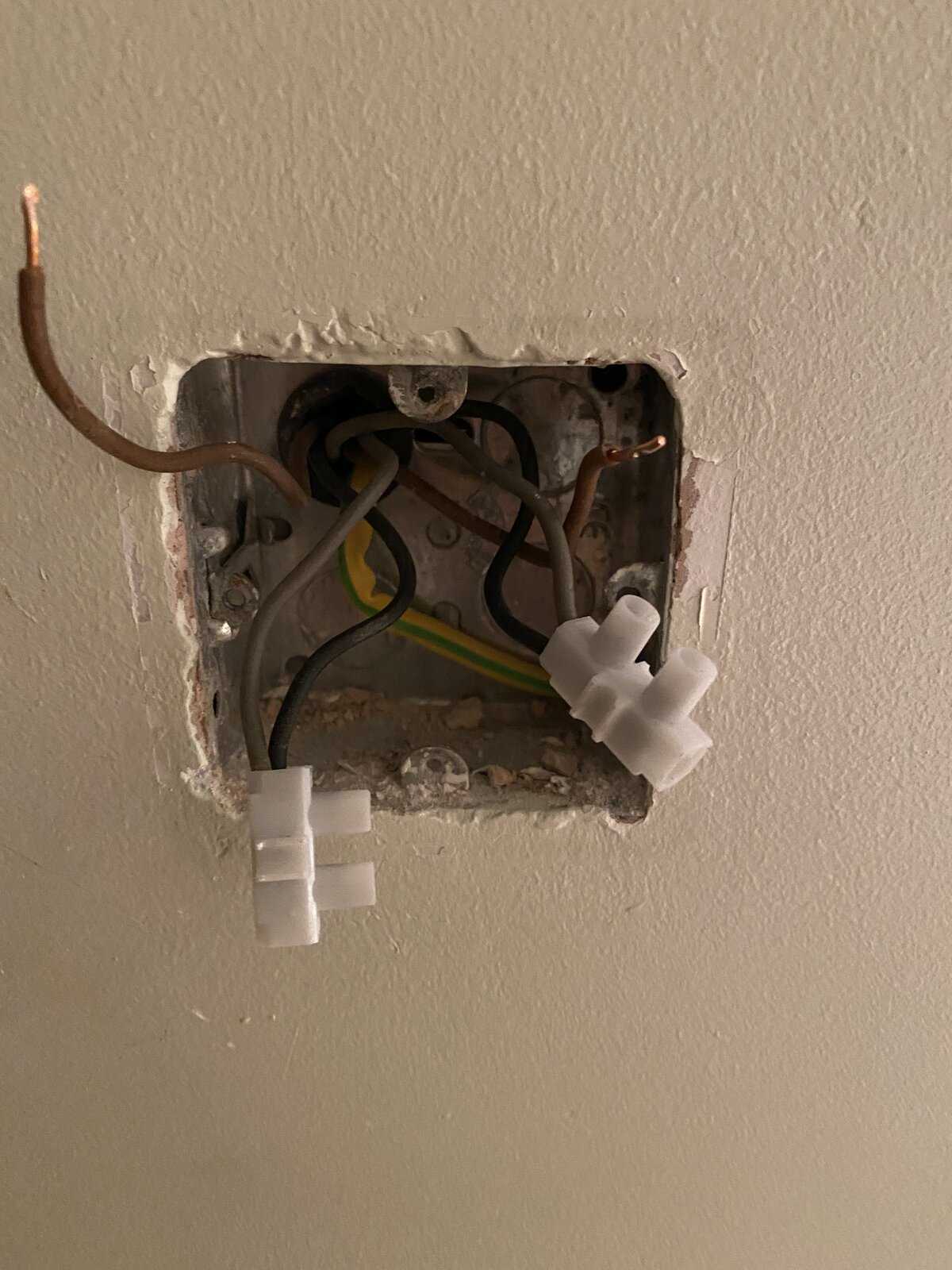

See image. I connected the black and grey on each set with each other in a connector block.
On the other switch, I touched one probe to black and the other to grey.
I did it for both sets.
The reading did not even register. It stayed at 1, which seems to be default.
JH
OK - so now those are shorted out
at the other end - the meter with a probe on grey and a probe on black should read zero
