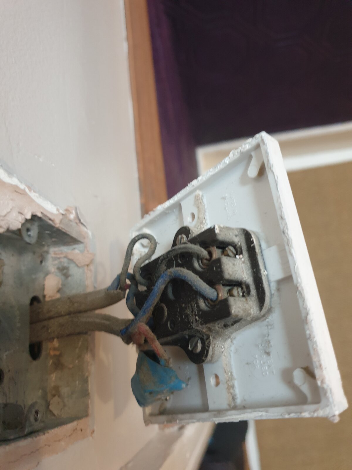

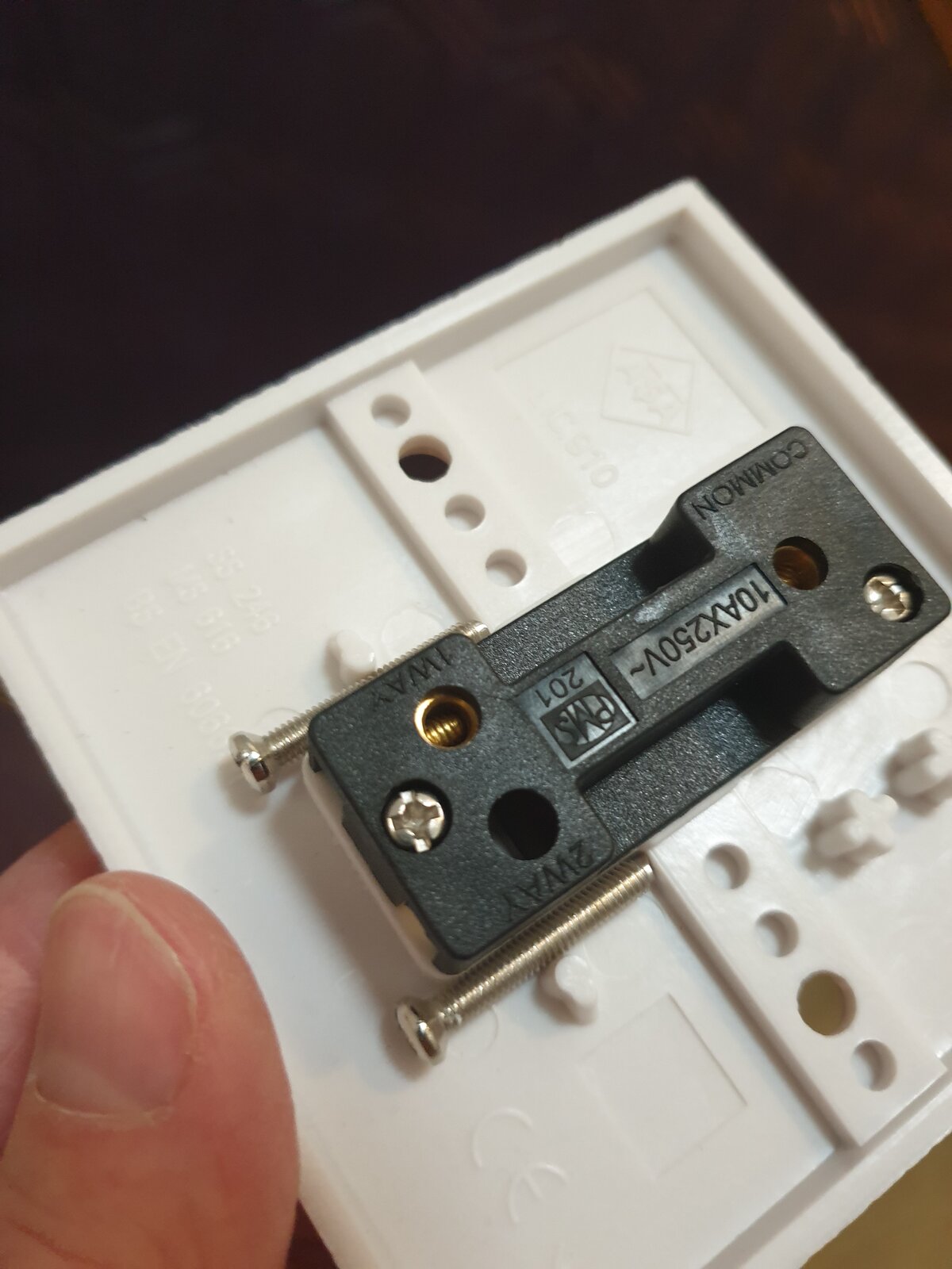

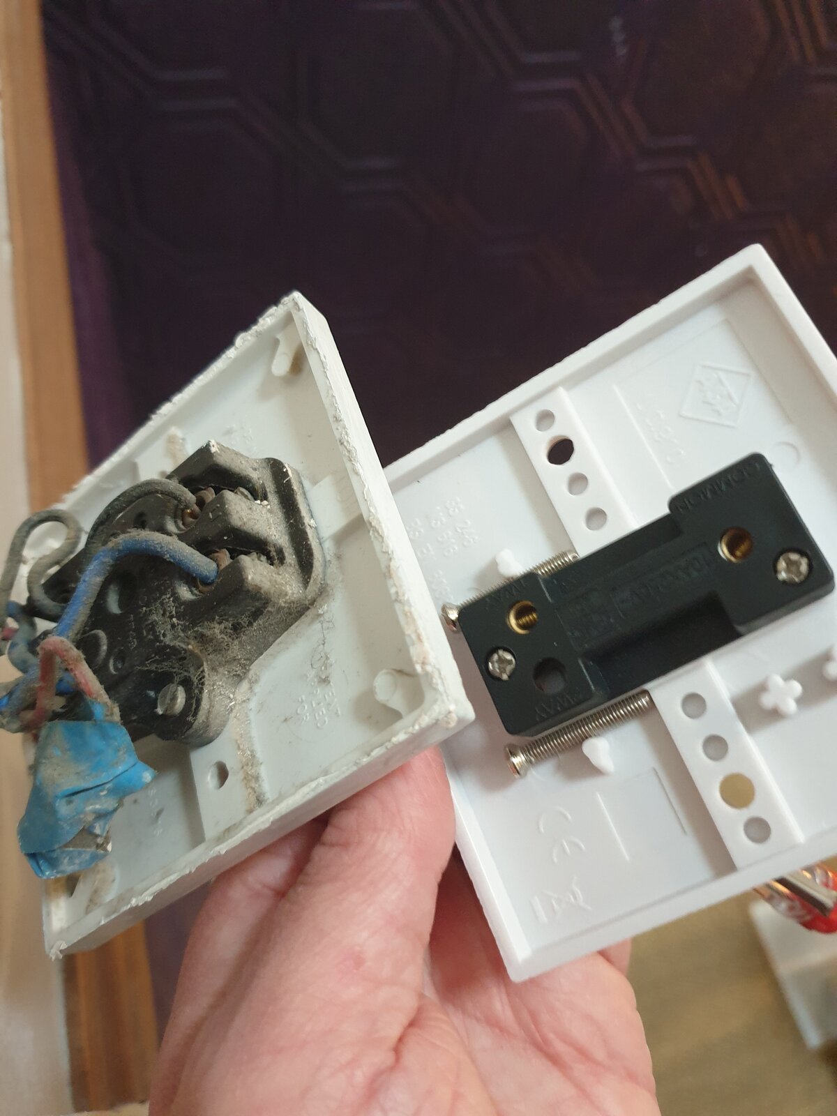

I bought a new switch to replace the scratched one in my hall. Can anyone tell me if its possible to use it? When i unscrewed what's on there it looks more complicated than i expected.

It's not easy to see what wires go to which terminals, but the switch you have bought looks like it only has two terminals and the existing one more.
Perhaps, what you deem to be a 'standard switch', could actually an 'intermediate switch'.
How many switches actually control the operating light in the hall?
Difficult to be certain, but your older switch looks like what is known as an 'intermediate switch', you new one is a simple one-way switch and therefore not suitable.
An intermediate switch, allows you to have three switches operating one (or more) lights, via 2 two ways switches, one either end, and an intermediate in the middle. The Intermediate switch will have four terminals.
Thanks for the responses. There are two other switches that control this light so three in all - it must be an intermediate switch so i'll have a search on ebay for that.
