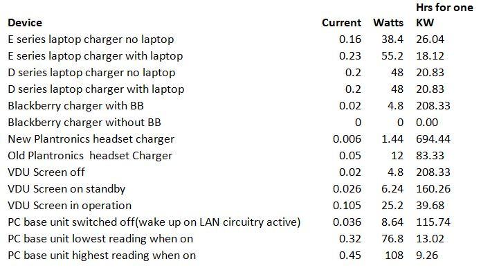

I was hoping someone on here may be able to help me. My office is on a drive to be green and energy efficient. We are looking at the impact of unplugging laptop chargers vs keeping them plugged in. From internet research we have found that our modern laptop chargers go into a standby mode when they are either unplugged from the laptop or the laptop battery is fully charged. The manufacturer state that the power draw should be lower than 0.5w. Now whilst this is still a power saving, it isn't really that big even when you multiply it by the number of desks on site.
One of our team then came on site with a FLUKE multimeter and found that the power supplies were actually drawing ~35w of power despite being unplugged from the laptop. His view was that the manufacturers tests do not state at what phase they were testing at and the difference is a result of capacitive load being different to inductive load.

Here are the readings he got:
This is what he said:

With a multimeter you can only measure apparent power because you can only measure voltage and current seperately. To get the full picture you really need an oscilloscope with mains rated differential probes. Unfortunately those don't come cheap.
Since your guy was almost certainly measuring apparent power it's possible the discrepancy could be explained by the manufacturer specifying real power but frankly for an unloaded laptop PSU 35VA of apparent power still seems very high.
It's also possible that the meter is not capable of accurately measuring currents at frequencies other than 50Hz. I'd be especially suspiscious of this if the current measurement was made with a clamp meter.
Simple - he's measured the current and made the incorrect assumption that the power factor is unity (which it won't be).
Buy a plug in energy meter that includes power factor and real power - it'll tell you that the power factor is "poor" and the actual power drawn is "quite low".

If the adapter were actually dissipating 35W+ with no load, it would be very noticably warm. Simple enough to test.

True, but it would have to be spectacularly poor to not show the difference between (say) 35W apparent power and (say) 0.5W real power & a "poor" power factor.

Intrigued by this and having the test equipment to hand I did a quick test on my laptop power supply.
Testing a Lenovo 90W 20V AC adaptor with a Voltech PM100 I got:
Off load
230.6V
16.4mA
500mW
3.8VA
PF 0.13
On load but with fully charged battery
230.1V
160mA
13.8W
36VA
PF 0.37
The on load readings were difficult to take as they fluctuated quite a lot - probably due to the battery management system
As you can see the PF is far from 1, especially off load. The 38W off load reading taken by the OP is wildly high. Something is wrong here I think.
