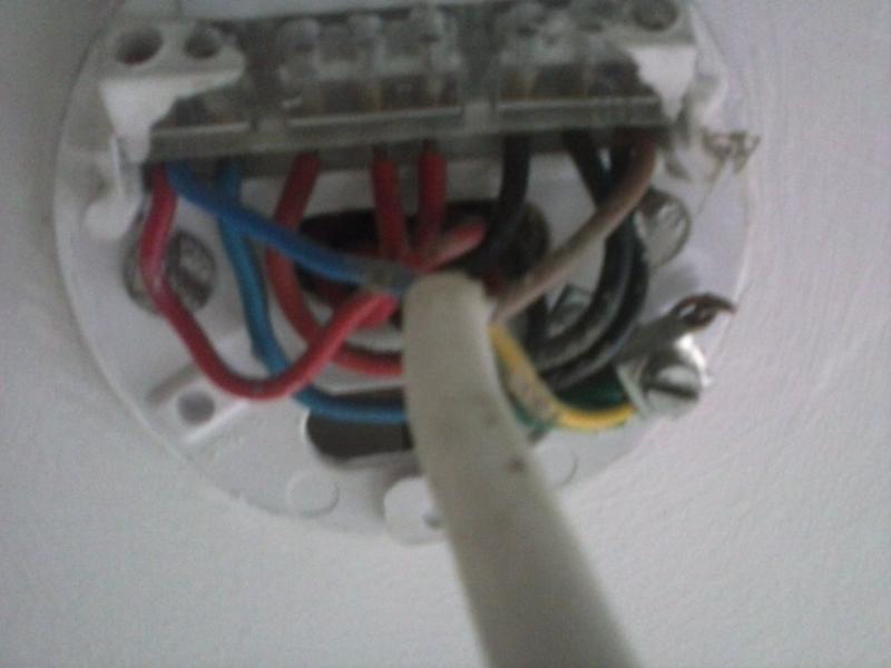

Hiya everyone, I have been a fan of the forum for a while but just got round to doing my first post...
Unscrewed a ceiling rose the other day and I found a strange looking setup - the cable from the lamp seems to be the wrong way round, and there are two extra wires stuck in there. Is this wired up correctly? I want to replace the rose - shoudl I wire anything differently?
Thanks!
My gut feeling is that there is a second light on the switch, the flex to the lampholder is wired with reverse polarity and that someone used 3+E for the switch drop with the yellow wire cut off where we can't see it.
Would that fit with what you have? is there a second light on the switch? what is the wiring like at the switch?
Spot on - forgot to mention that bit! There is indeed a second light on the switch. Haven't looked behind the switch but will post a pic when I get in later.
Does that mean it's not dodgy?
Well assuming my assumptions are right there are two dodgy things about it
1: the lampholder flex is fitted the wrong way round.
2: the blue switched live wire should be marked with red/brown sleeving.
