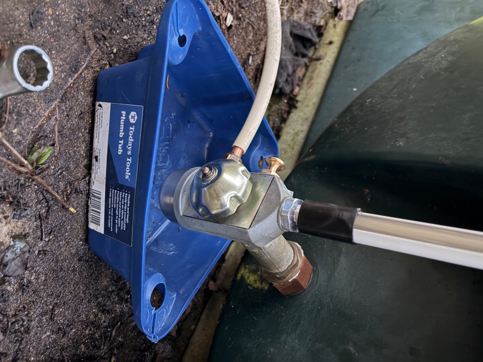

Would you be able to tell this from an image? I have attached one to this response.

I’m not certain it is. That’s the problem. Didn’t want to take it off if it isn’t actually a bit open.

Remove the circlip from the wheel, and if it spins freely it should pull off easily. If it is still tight, then lever it away. If it spins freely and does not operate the valve, you need a new one any way. With the wheel off, you ill see the nut on the valve stem. Give it a soaking an turn it clockwise with a spanner and the valve will close. you will be unable to push the shaft in. To test if it is closed before removing the filter, unscrew the sight tube from the valve and pull the 'to read' plunger. If oil comes through, then the valve is still open. Just make sure the small hole is clear before pulling the knob so that you can be sure that it is not a blocked hole.

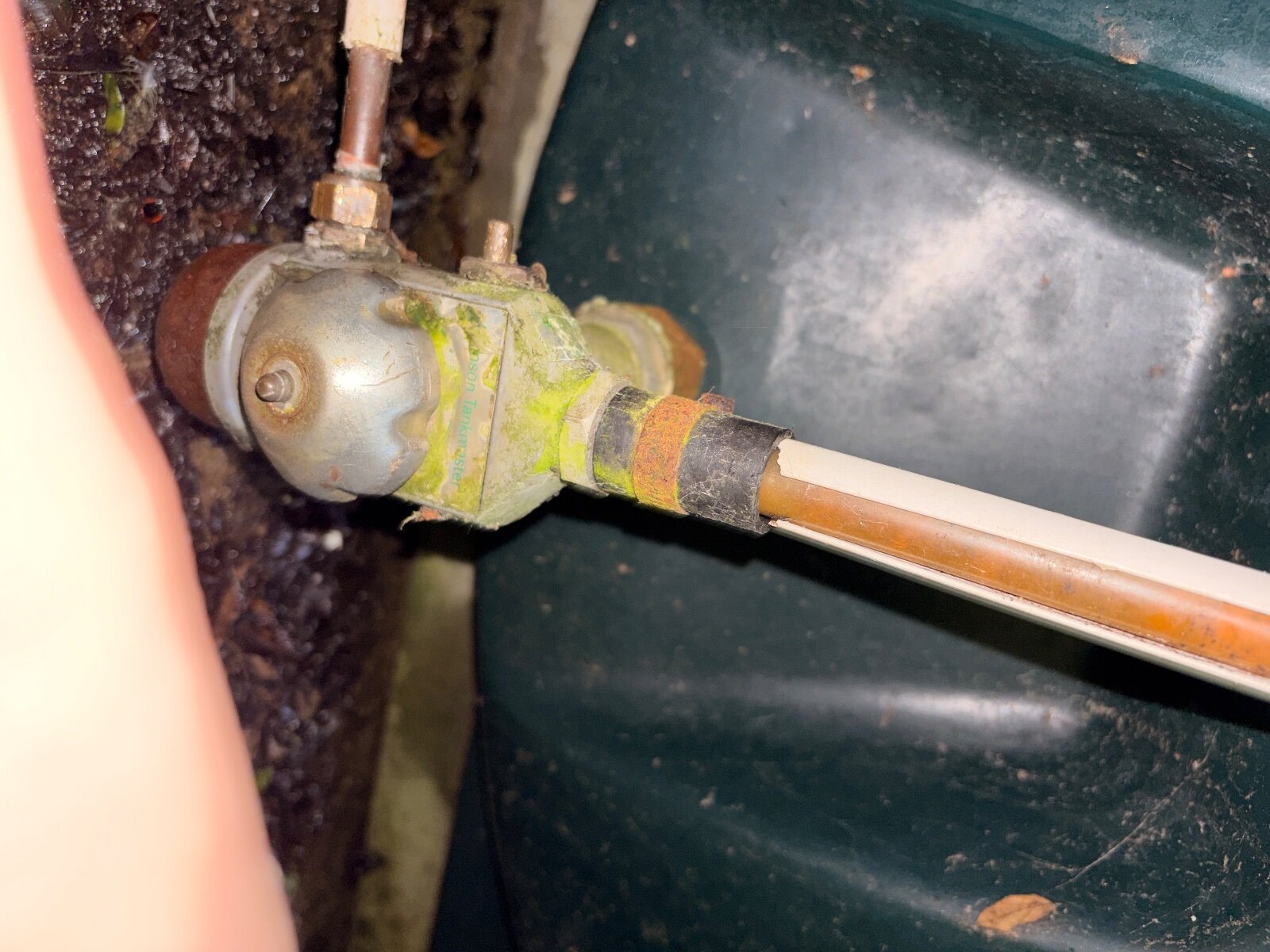

Hello again. Thanks for your help so far. I’ve got the wheel off (what a pain) is the nut you are talking about the bit I’ve highlighted. Sorry I know that’s probably a very dumb question but I just want to be sure!
Turn that clockwise to stop oil? If I turn it anti clockwise will that allow me to slide off the whole body and replace the entire unit?
Not that big nut. Using grips, turn the copper coloured sleeve clockwise, and you will see the centre spindle come outwards and that will turn off the oil.

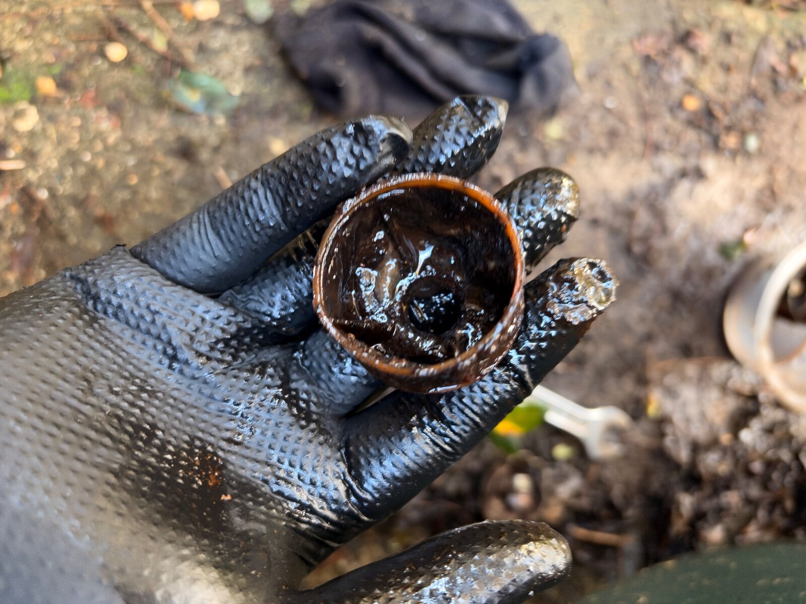

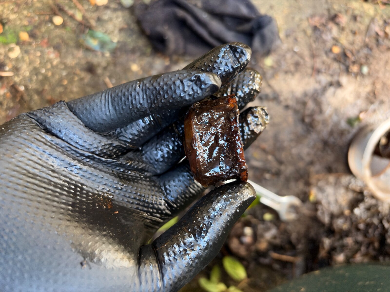

Just wanted to say thank you for all your help for everyone that replied and helped me. I’ve managed to fully replace the entire Tankmaster unit, bleed the line and get my boiler restarted and heating on.
Couple of pics attached to show the state of the filter and the new unit. Thanks again all, particularly Oilhead, check your private messages mate.

Looking at those photos it might be worth checking your tank for water ingress.
I wouldn’t be surprised if it’s never been changed!!! But thank you noted and I will make that my next job.
In the meantime best leave the heating switched off for half an hour or so after future oil deliveries just in case.
