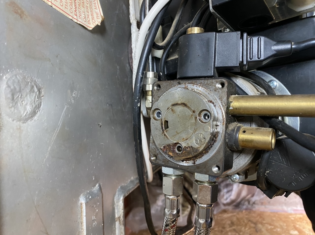

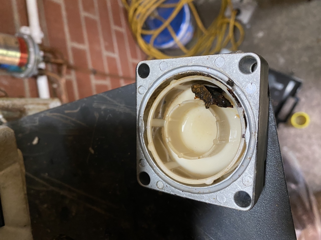

It’s fixed, went back today and measured the fuel pressure.
It was running at 105psi which is a little low so I stripped the pump and found a large deposit of something in the filter.
cleaned the pump, put it back together amd it was then running at approx 117 psi, reset to to 110 and it’s now fine.
Filter and pump
