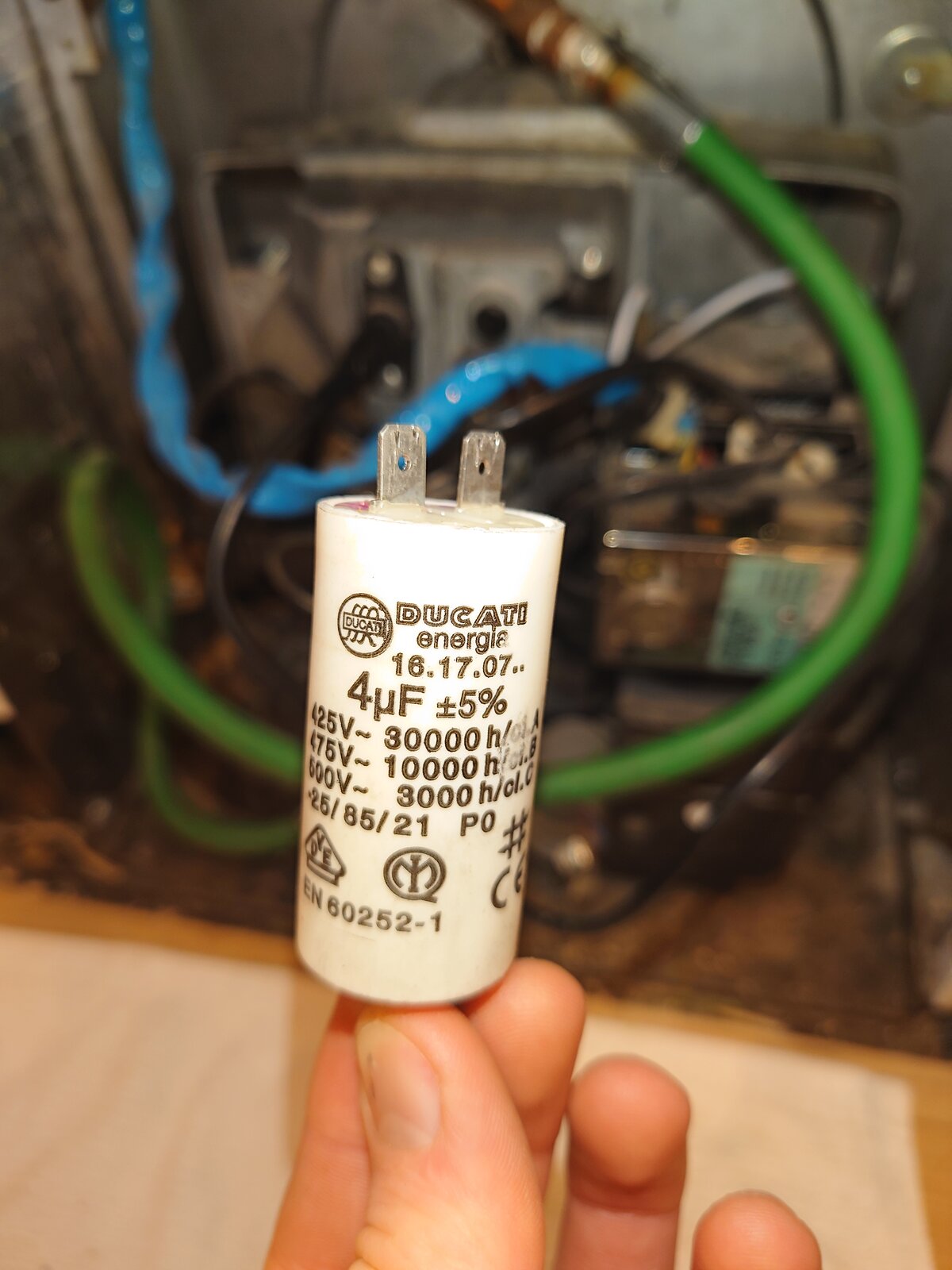

The problem is more burner related
Worcester heatslave 15 19 oil boiler
It is a bentone b9 burner made in 1999
With a danfoss bfp 21 l3 oil pump .
The boiler will run fine with heating on but about 1 in every 3 or 4 times it goes to start up it will lock out , I will press the lockout button and it will run again .
I can tell when it's going to lock out as i can hear a buzzing noise instead of it starting up like normal with the fan and then the ignition .
It will only lock out like this on start up and never while running .
I have changed the solenoid coil on the burner and checked and cleaned the filter ,
Checked the photocell which was clean .
Checked oil is coming as it could and bled the oil pump. Also checked the fan motor was spinning nice and freely which it was ,
I am looking for advice before I go and further spending more money and taking more apart .
And advice would be greatly appreciated

Thanks , I will search online for more info on this now .
is there any way of checking it is this and not the motor itself or the oil pump ?
The oil pump does turn and is not siezed , but could I try run the boiler with the drive of the motor not attached to the oil pump ?
If you have a multimeter with a capacitance range measure it.
The cap provides the phase change to give a rotating magnetic field.
Under no load conditions it will probably work.
Thanks , I'm not great with a multimeter , .I have been able to source a new motor with capacitor , and I may aswell get a new oil pump too as it's probably well over due , I will fit these tomorrow and let you know how I get on ,

A 4mf capacitor of any size/mount can be employed and held to the motor by cable ties. There are only 2 connections and they are not polarised.
Great , is there anywhere other than a heating supply shop that I might get one on a Saturday?
Going to try my best with a multimeter tonight .
