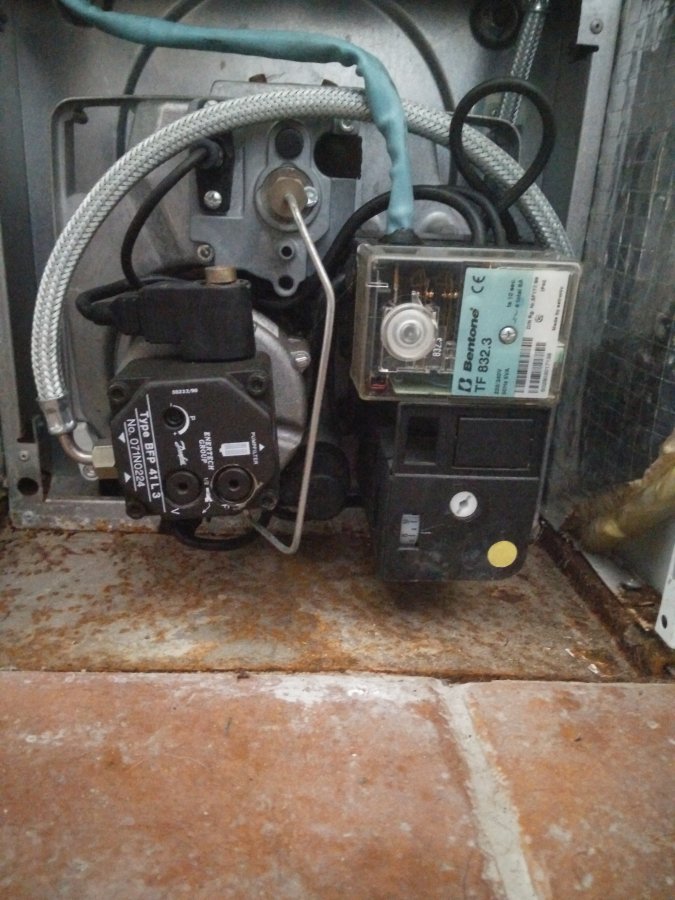

I can see no lock out light. This is what I have under the hood of that.
Any ideas? the clear box has a button which you can press, tried that - nothing. The boiler has power as the pump runs when you select 'heating for radiator' mode.

The clear button is in fact the burner lock out / reset switch......if the burner has tried to light but failed, it will glow red.
So, yours doesn't so there has to be some sort of power failure to the burner.
Can you confirm the upper of the two lights on the front panel is lit?
If it is, there will be an overheat trip usually situated top left of the boiler interior, front panel off. It's in fact at the bottom of the control panel housing, and you push it vertically upwards.
Failing that, there's a fuse within the control panel, on the circuit board that needs checking. If I remember, it's 3.12 amp, slow blow.
John :)

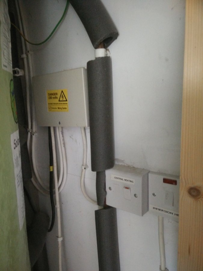

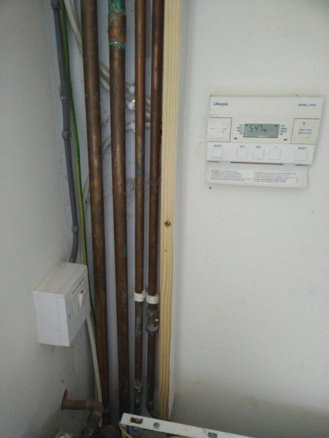

Okay so after looking.
The boiler has a white mains cable which comes out, and up in to the timer box, which controls when the boiler comes on/off. See photo here:
This timer box has power, is on and works. If I switch the boiler to 'central heating mode' so the radiators should warm. The pump inside the boiler starts (not the boiler heater part however)
Cables then leave the timer control box, up over the ceiling and to the water tank area where I have this! (see next post)
Goes to this (pic2)
There is a fused spur here, could it be here that has blown? The immersion heater switch lights up when you press it (assume this is working still)
Jon
