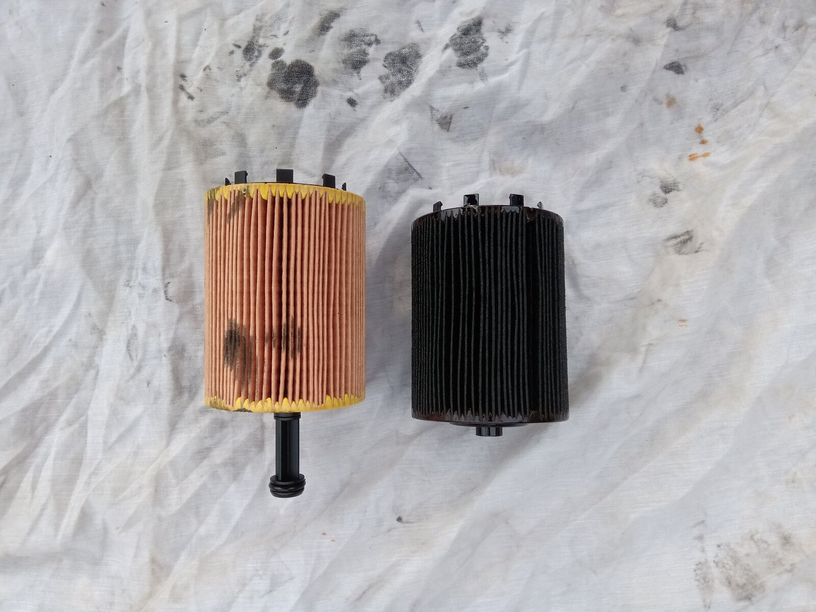

Hello, I finally got round to changing the oil and had to stop half way through.
After taking the old filter out I realised the stalk/pin bit wasn't on the filter. I looked in the housing and it's stuck there. I tried a gentle pull but hand but no luck. I'm not sure when it broke as the big paper part unscrewed with the cap.
Any ideas what to do. Should i try with a tool?
I'll show a photo of the two filters in case I've not explained it well.
Cheers
A coach screw (wood screw thread, tapered end) from the local diy shop should do the job. Just slight larger than the stem's inner so it gets a bite. Twist in and pull.
I presume the new filter is a quality brand?
Mercifully I've never come across this one, and I've changed so many! It looks like the break may be at the cruciform section so hopefully it can be gripped somehow.
If this is a VW P.D. engine with the filter on the top I seem to think if the bottom of the oil cooler section is undone the broken section could maybe be pushed out from below.....the cooler may have a screw on cap just like the filter top - but that was a long time ago.

Thanks fellas, got it out. I wont say whos advice I took as the other two will get jealous :)

Well there was enough sticking up to get pliers on. I put one of the prongs inside the tube, as i thought it less likely to break that way. I think they would have all worked as long as there was enough to get on to.
It may be that your Bosch filter was made by Mann.
Hope so, mind you it was a Mann one that broke.
