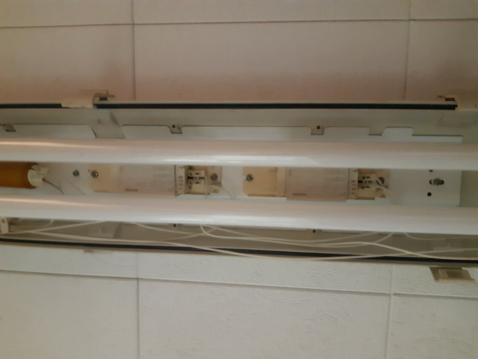

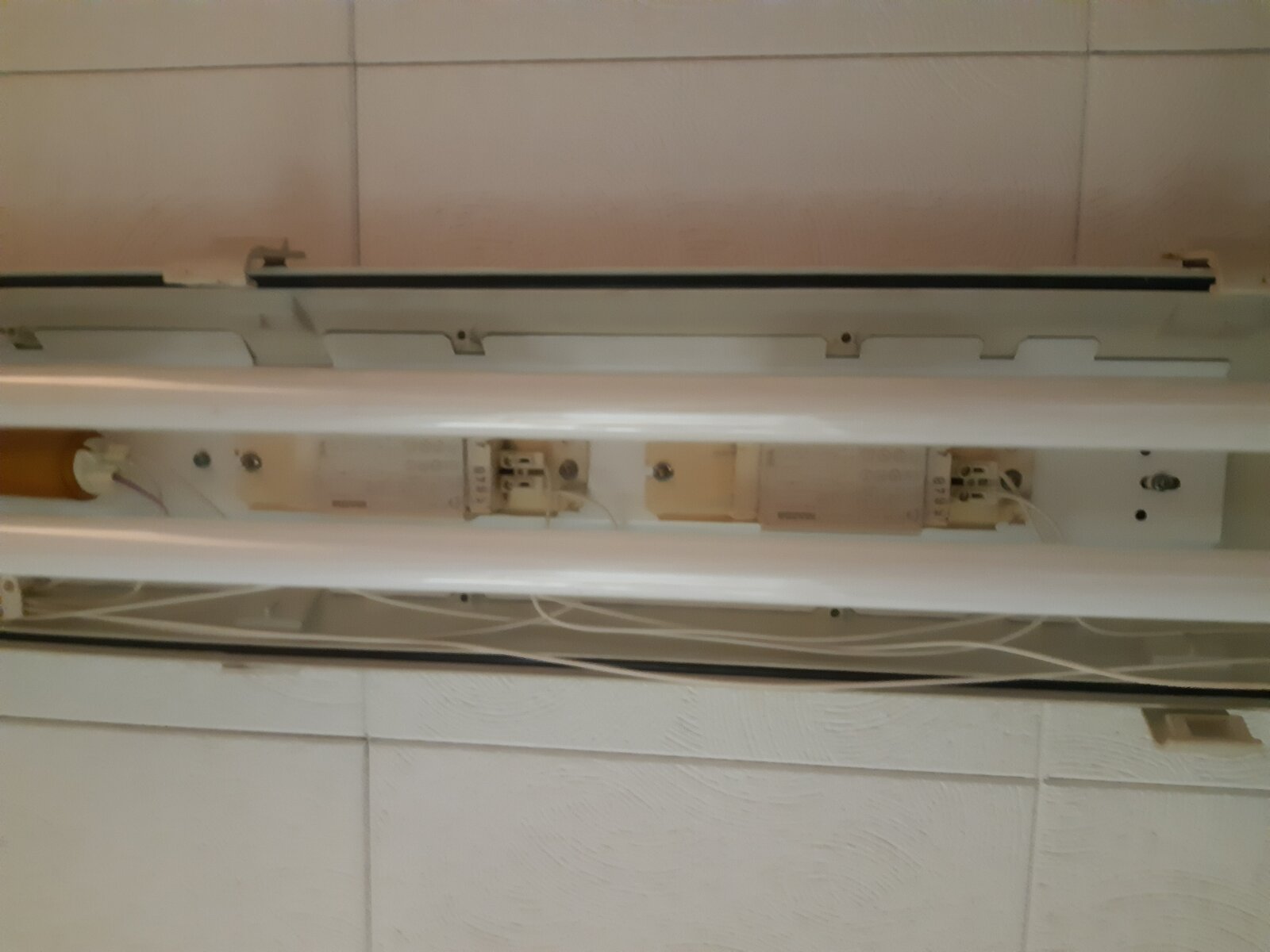

I have an old twin tube fluorescent strip light that doesn't come on anymore. The ends of the tubes light up and they look in decent condition.

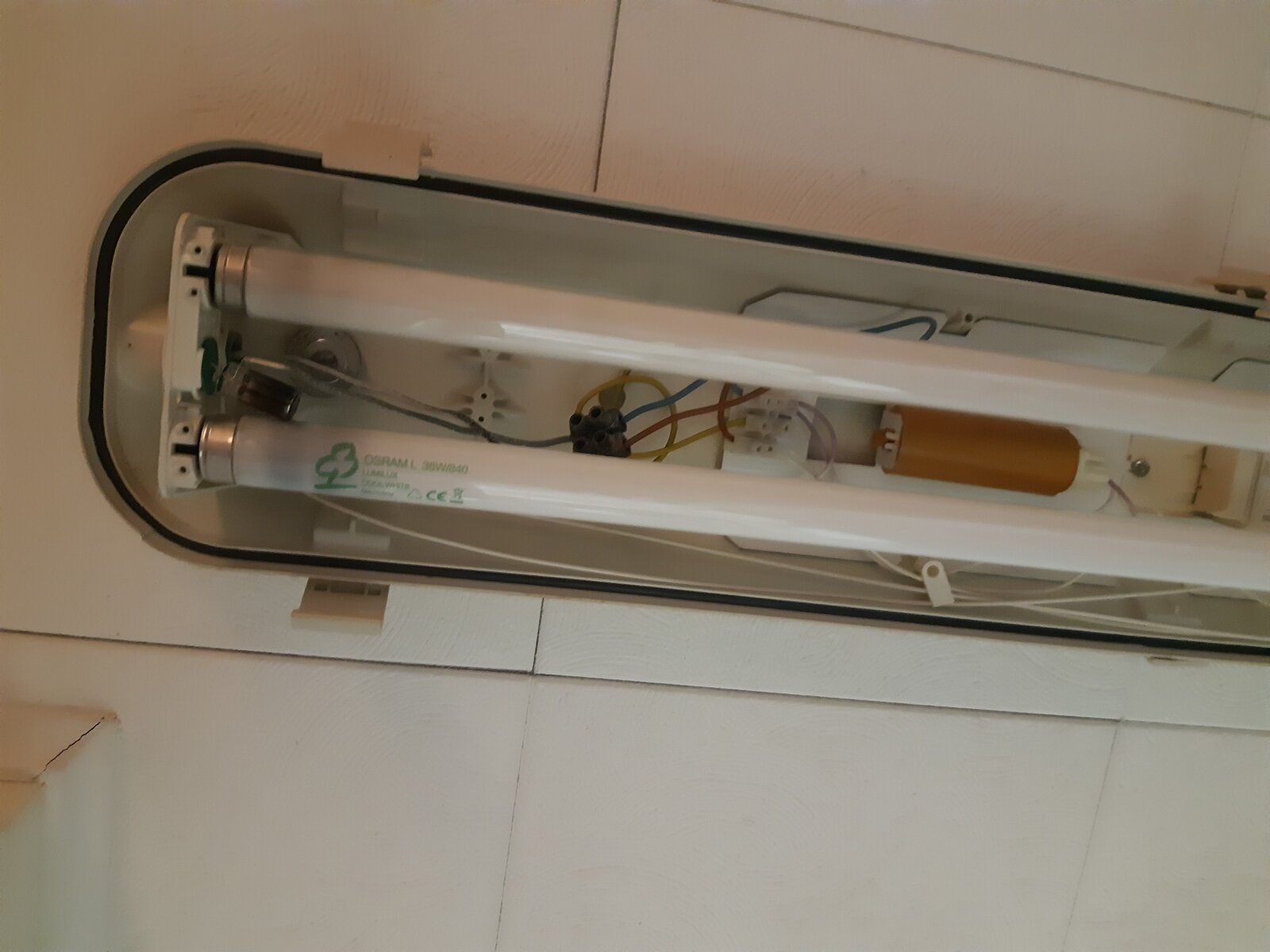

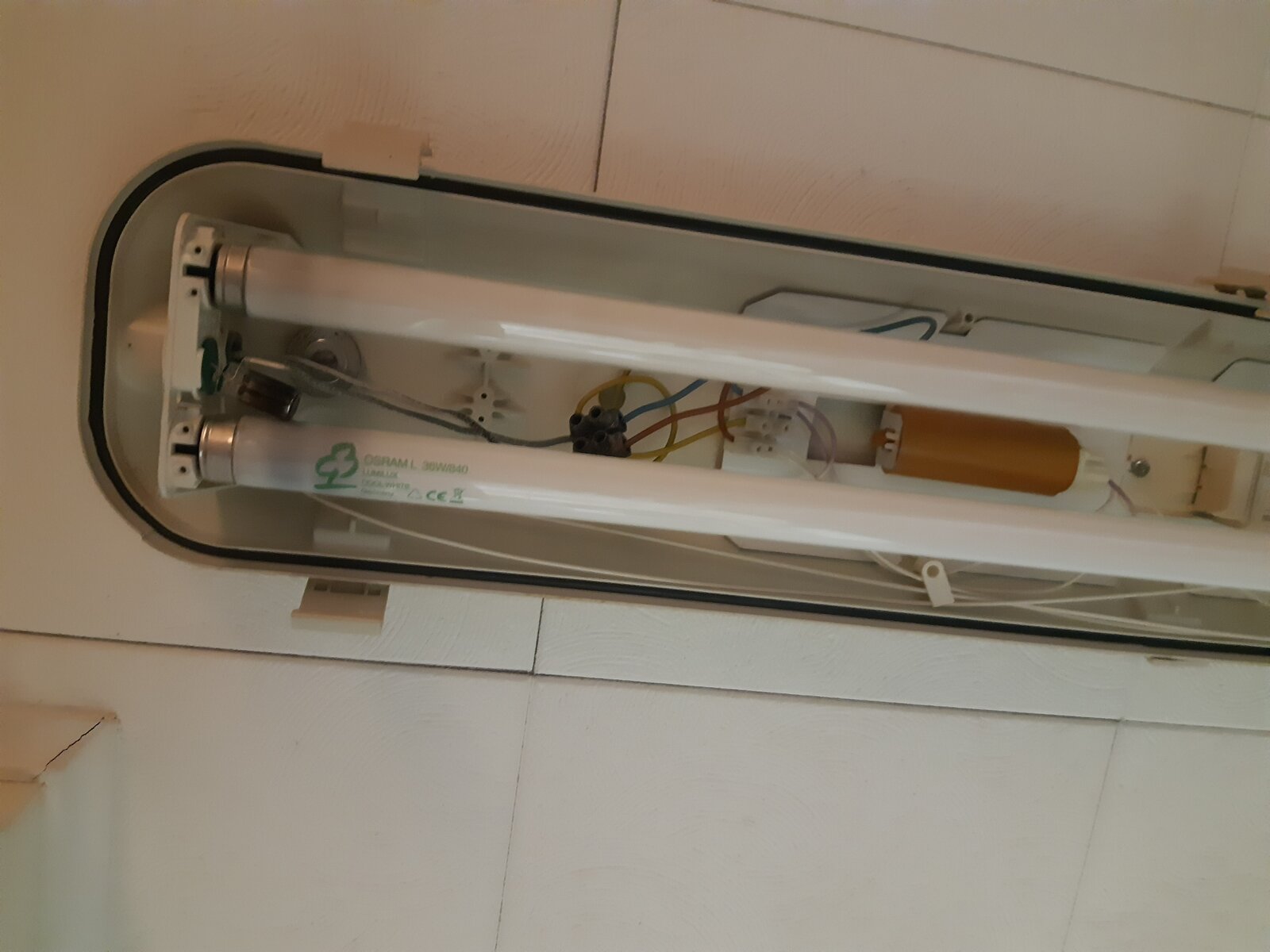

In our old place our lights had small cylindrical starters that usually needed replacing when this happened. But when I opened this light I don't see any. I googled it and I saw mention of ballast?

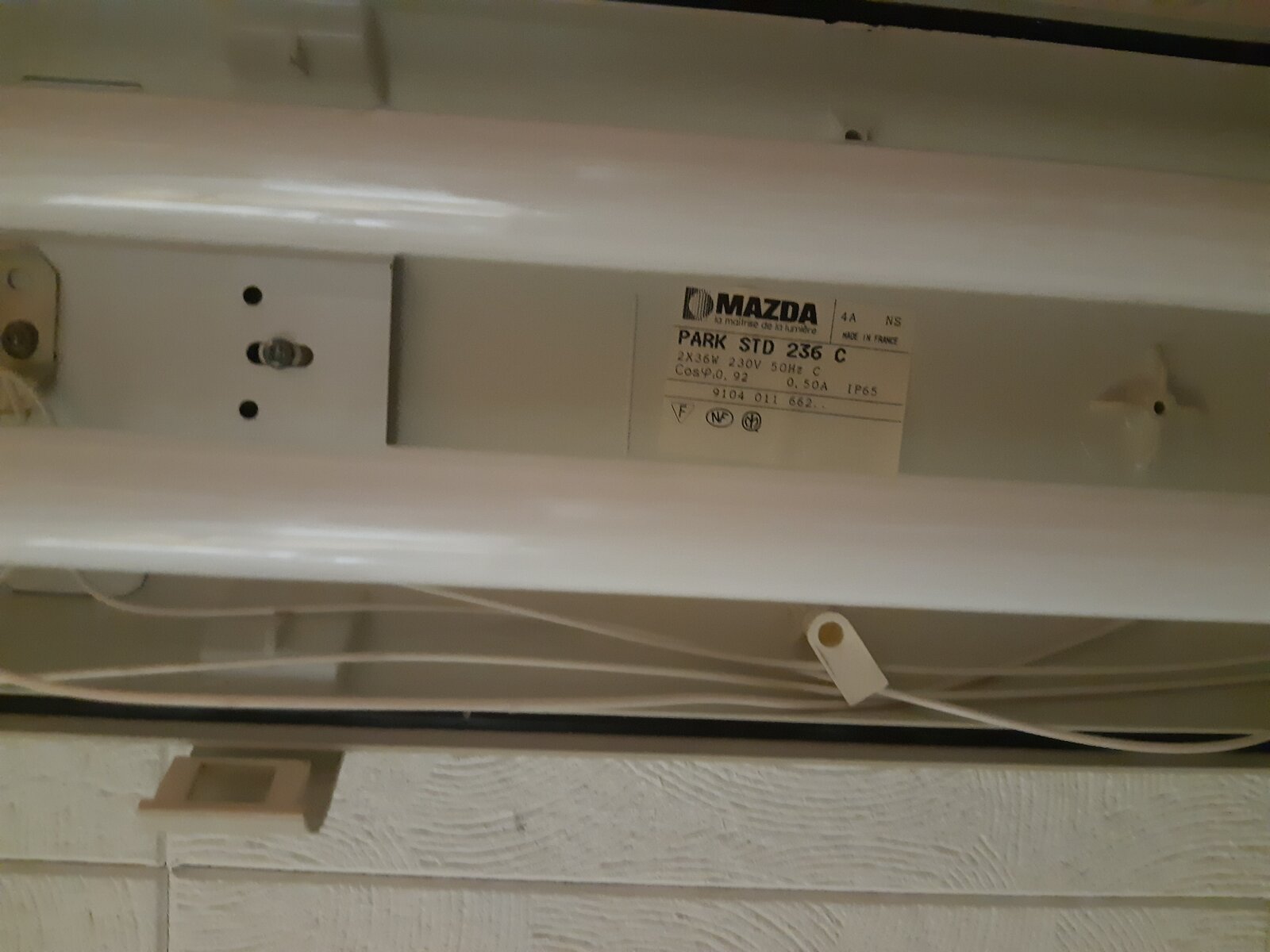

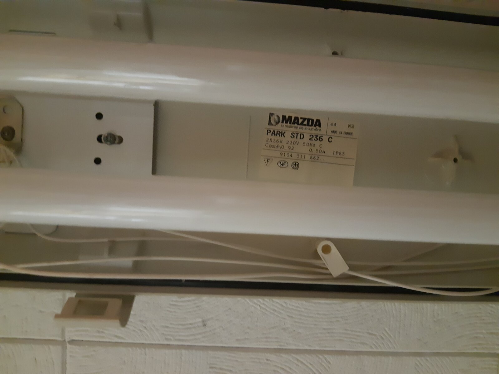

Are there starters in these lights (brand Mazda Park STD 236 c)? Mazda are still trading but I couldn't find contact details. Or should I just replace the whole light with an LED? It is in the basement, in the larder and probably gets turned on less than once a day.

It may be just the tubes need replacing.
Find the cost of two new tubes and compare against a modern LED unit.
(If you buy the tubes first to try them, ask the seller if you can return them if you find the fitting is faulty. Keep the packaging in case they say yes.)
There were wire wound ballast fluorescent without starters, but looks like a starter in the end between the two tubes.
Electronic ballast did not have starters, and are far more efficient.
A wire wound ballast is around 60 to 80 lumen per watt, and very voltage dependent, under will not start, over can use well over rated wattage.
The electronic ballast is 90 to 100 lumen per watt, and voltage is not so important.
A LED tube can be fitted in a wire wound ballast with no rewire, but around 60 - 80 lumen per was once you include the energy lost in the ballast, remove the ballast which you have to do with electronic type, and 90 - 110 lumen per watt.
However the output for a 5 foot tube is around 5100 lumen but the LED is down to around 2200 lumen, so if you need the light from a twin tube unit, moving to LED will be rather dim.
I assume you need a new tube, here in UK the price of florescent tubes has rocketed, it was no point in changing, but seems we are being forced by governments to change.

The black cylinders in the end are glass and are wound with wire (I assume this is what @ericmark was meaning). I didn't mess about much with them but I couldn't see how they obviously came out.
I was tempted to buy a new tube and see, and I think I will, because the fitting is fine and quite robust. I would check to make sure it was worth it price wise and that I can exchange.
It is pitch black down three so it would be good to.have a decent light! This one was great when it was working.
