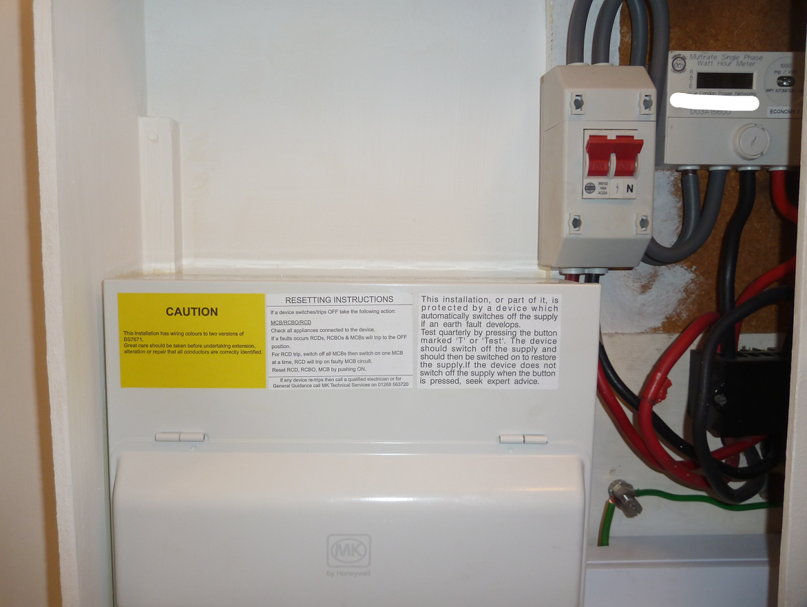

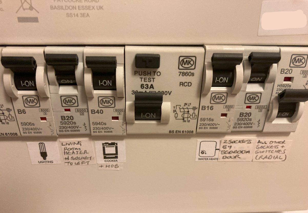

pics of the meter area and consumer unit would help.

Thanks AndyPRK. I'll be interested to know what you can tell from the pics.
I can see why you might want two elements - at least it gives you choice.
So it's got a normal meter and CU.
What going on with the black box on the right, with those red and black tails. Where do they go on the right of the pic ?

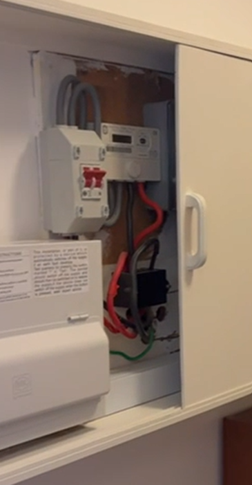

Might have to abandon this quest as I'm not there and can't find a better photo than this. Any good?
Arh maybe it's just the 4 wires into the block.
Isolator on the incomming side of the meter. Unusual. I guess that's because its a flat.
Iolator on the incomming side of the meter. Unusual. I guess that's because its a flat.
It's like that because someone has got it wrong, or someone else has been tampering with it for reasons unknown.
The lack of a proper cutout adjacent to the meter is also wrong.
Further investigation is required.
The only person to have touched it in all the time I've had it is an electrician. I despair.
...Isolator on the incomming side of the meter. Unusual. I guess that's because its a flat.
This is a very common arrangement in flats where the cutout is elsewhere.
There is no requirement (other than isolation) for a second cutout and local isolation for a meter change is provided as is for a CU change.
The only issues I see in the pics:
Lack of seals.
Possibly unsheathed or smaller than usual tails but without more detail I can't say and being on the DNO side it's not our concern.
