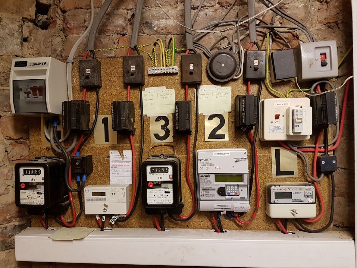

Thanks for all your comments. As John says, we've 'drifted'.
In my case, I have to come clean, and say that (despite my deceiving line of question), the mains in this particular job, not only is 3-phase (which I guess makes it more than your straight single 'domestic'), but there is no cupboard at all, just all stuck to the wall in a room off the family kitchen. No lock, just a door knob.
Fair to say, it's not a C3, but like flameport said C2. Looks like the old Wylex switches and BS-88s are going to have to go, and be replaced by a proper MEM (or similar) 'KMF', and the 16mm t&e terminated properly into the enclosure.
Time to have a talk with the landlord.

I was in effect trying to decide if I should just advise the property owner to get a cupboard built with a lock and leave it at that, or even just put a lock on the door. As he's virtually the only person ever going into the room I would suspect he would consider it an unnecessary 'bother', but also it seems most would agree that the mains would still be left in an unsatisfactory state.
I'll be telling him the mains needs an upgrade.

<photo of 'everything'>
Thanks. That's what I expected - just multiple instances of what you showed us originally.
One other thing no-one else has yet mentioned - by having those isolators/switches downstream of the corresponding fuses, the fuses could only replaced 'live' (unless there is some way of isolating them upstream of what we have seen) - which would not really be acceptable.
