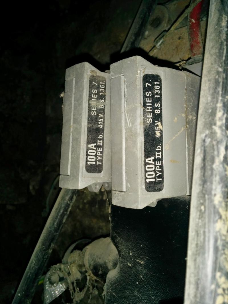

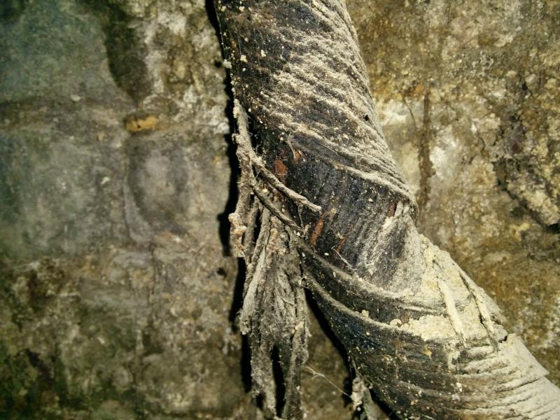

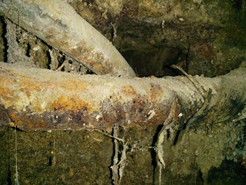

I have a new place which has this ancient looking supply cable (see pics) in the cellar.
Is anyone able to identify the cable type? Maybe hessian wrapped PILC? Is it worth getting the DNO to see if it is safe / needs upgrading?
I wonder if it is 2 phase as there are 2 100A fuses as well.

Old but looks fine to me, the hessian and the steel tape are showing their age but the underlying lead is the important bit and the bit we can see looks fine.

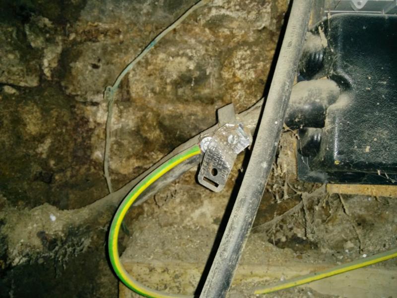

The type of earthing clamp is not the best.
As for the 2 fuses it could be a barred cutout with a short busbar connecting the two together, hard to tell in the pictures.
If a barred unit probable a 2c.0225
Westie, would it be an idea to get a Ze test done?
I have experienced high Ze readings on this type of cable, or is it rare for the earth to break down on these cables?
Wouldn't do any harm, the lead provides the earth and it can crack often just below the cutout. also it is not unknown for it to fail within some types of joint in the street

I seem to find a couple of supplies a year with failed earths. Nearly always PILC supplies, so definately worth having the Ze test done, but other than that, as others have mentioned it looks alright.
