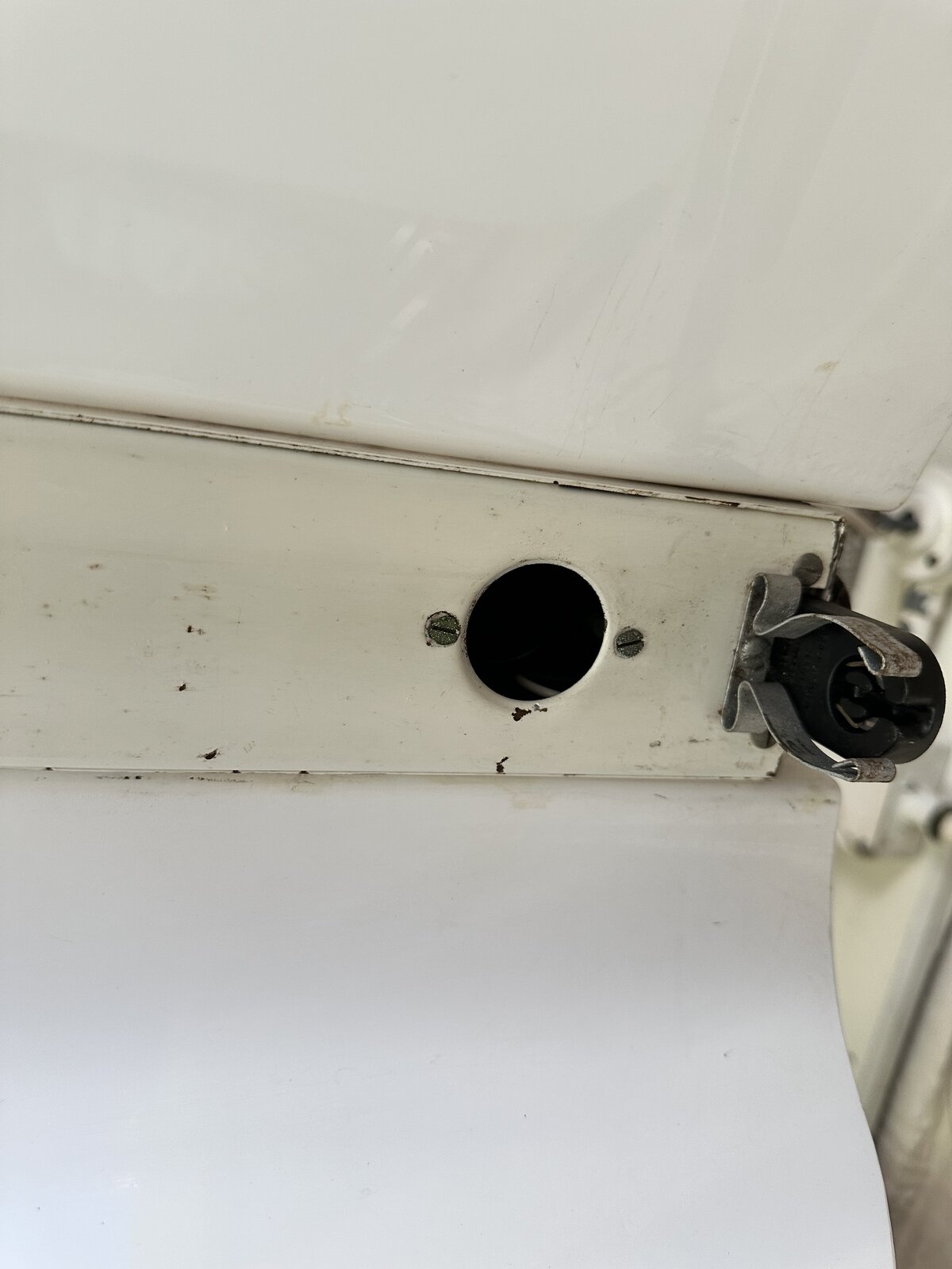

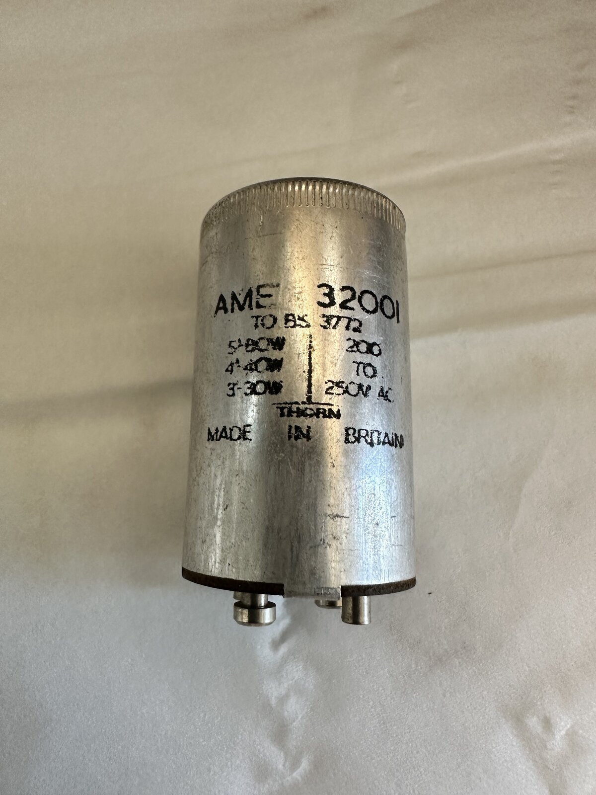

Does anyone know an outlet for old thorn starters, mine are two inch long in metal sleeve marked AM? 32001 , photos attached.

It's a perfectly standard, two pin starter, easily available from many outlets. You don't need to buy a Thorn item, just one which is suitable, for the tube wattage.

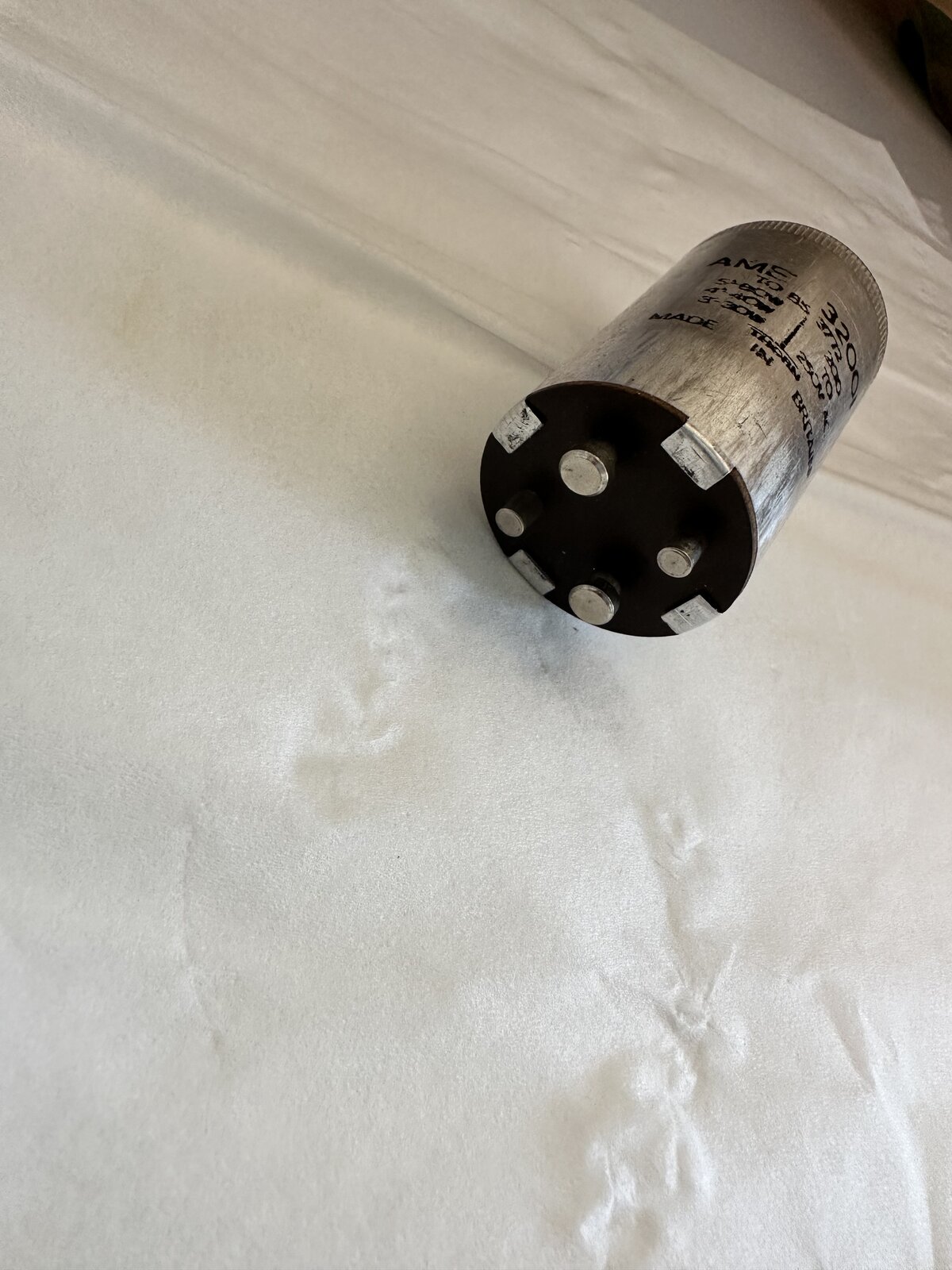

Hi Thank you, There are four pins on it , two larger ones and two small. And the length and circumference of it are larger than modern ones though, or are there similar sized ones as dimensions are not specified in online outlets
Oh, OK, I missed that - in which case, it makes that entire fitting scrap. Just replace it with a modern LED version.
Four pin starters, went out, in the 1950's, which means the fitting much be at least 75 years old.

You are not wrong they are that old , it’s just that everything else is in very good condition the previous owner was an electrician and carpenter , there are millions of old new still boxed components in the work shed which could rebuild so many electrical things like this starter I imagine but I wouldn’t recognise any of them , plus complex looking testers combining gases and whatnot , but alas no one who can use them , I have been reluctant to throw them away. I shall have to replace the fittings as you say. Thanks Harry.

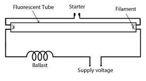

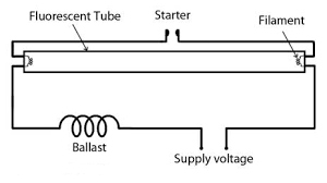

The starter is replaced with a fuse, but not really required,
the diagram is shown here, the new fluorescent tube is only supplied one end, the other end is a short circuit, so with the method shown it does not matter which way around the tube goes.

Actually, no this one is a 4-pin starter.
I will take the covers off and provide photos of the wiring tomorrow so I can ask if I can just replace the light with LED light and no starter at all. The ends of the existing flu tube is two prongs.
Don't mess about converting, just buy a complete LED fitting. The outcome will be much neater, and more satisfactory all round.
