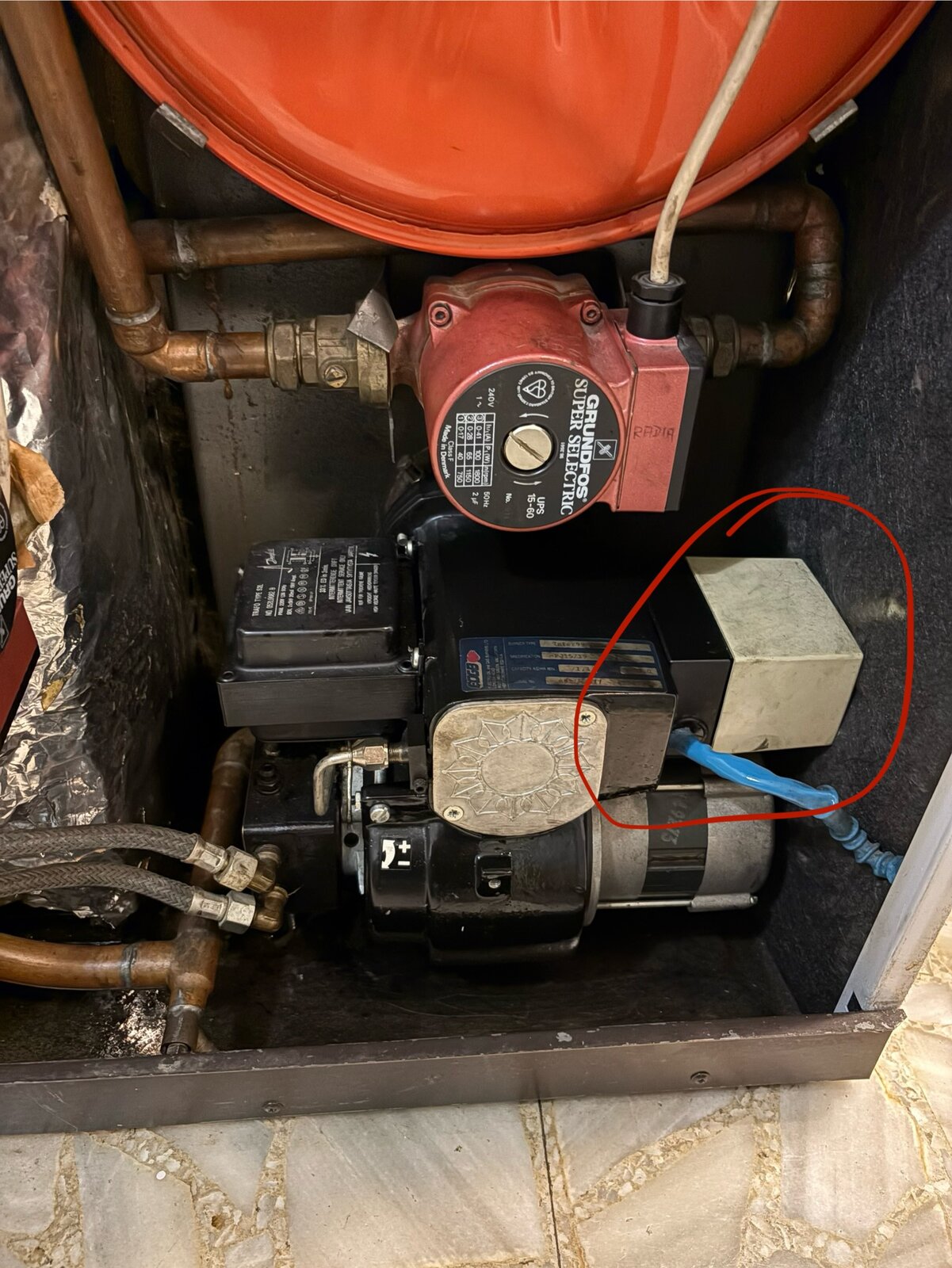

We went on holidays and turn off this Worcester 15/19 which is very old.
We came today and the red light is continously on and is not starting.

Here I attach some pics.

Is it the red light on the control box? Have you tried pushing it?
That is a very old burner and if the control box has failed, whilst it is possible to replace with a newer box, you may be halfway to the cost of a complete new burner.

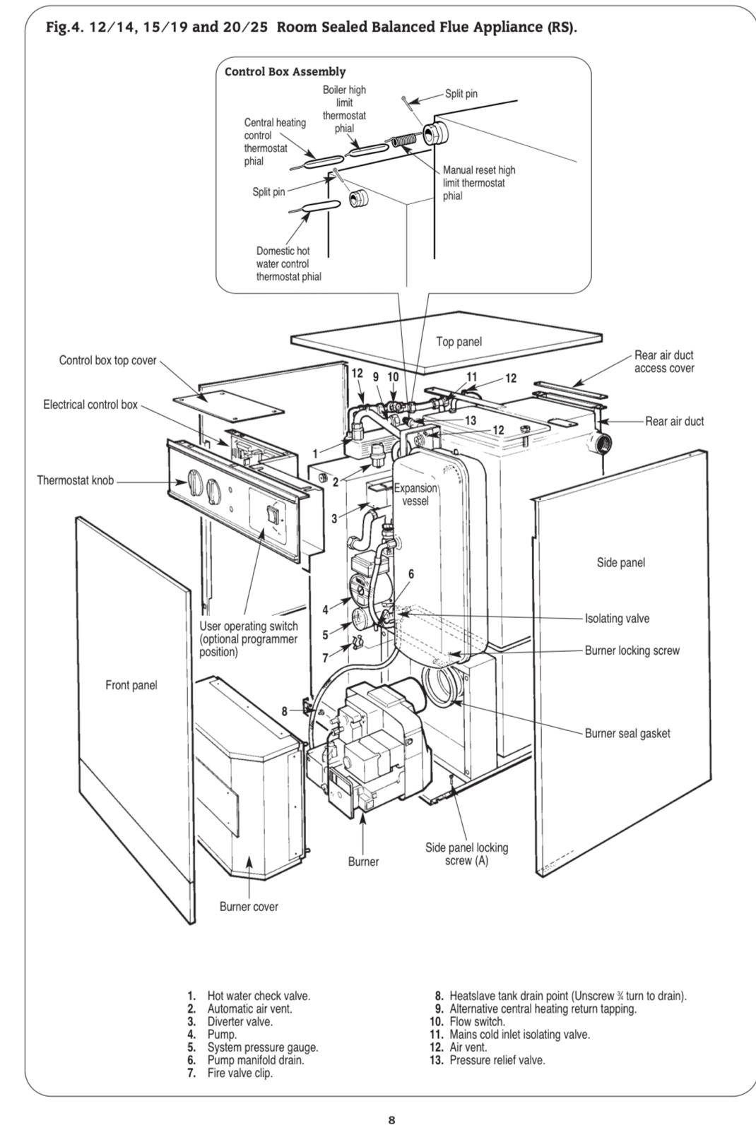

Here I attach a diagram that may be my model but I am also not sure.
Thank you again
As oilhead has said there will be a reset button on control box, that's the white ish lump on right of burner just push button.
That diagram is for a much later boiler.
looks like a BHO 11 control box or similar? Long obsolete.
A good replacement is the Satronic tf830 and with it's own base is pretty simple to set up.
I guess the lockout lamp is immersed in the insulation on the boiler right side - push it out of the way and it will be illuminated.

Hello guys,
We have found the solution. The reset button is located where I pointed out in the photo, in case anyone else experiences this.
I imagine that when the pilot light comes on, it’s because the diesel is somehow not reaching it, as there is a small leak and the burner cannot operate.
